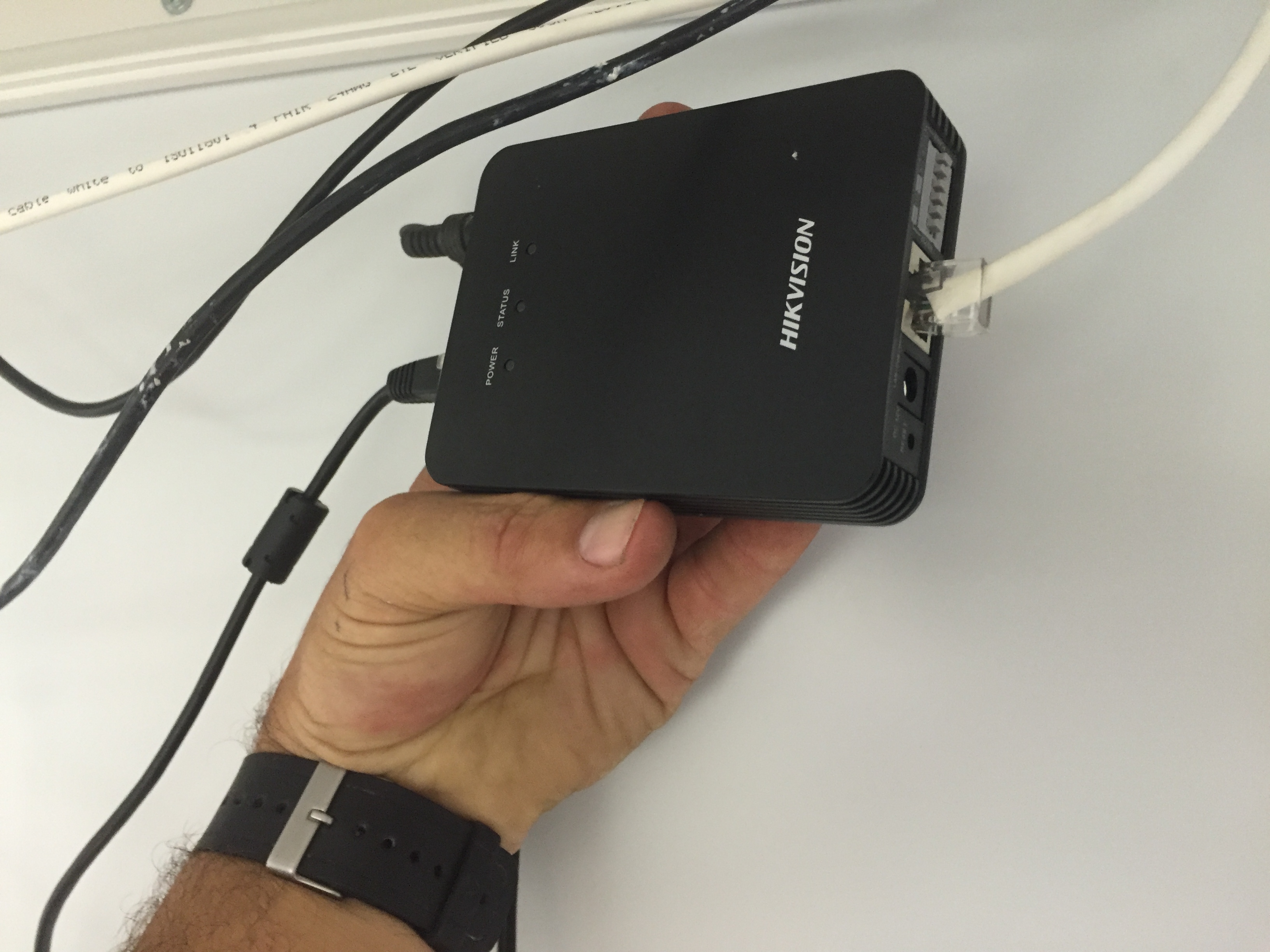

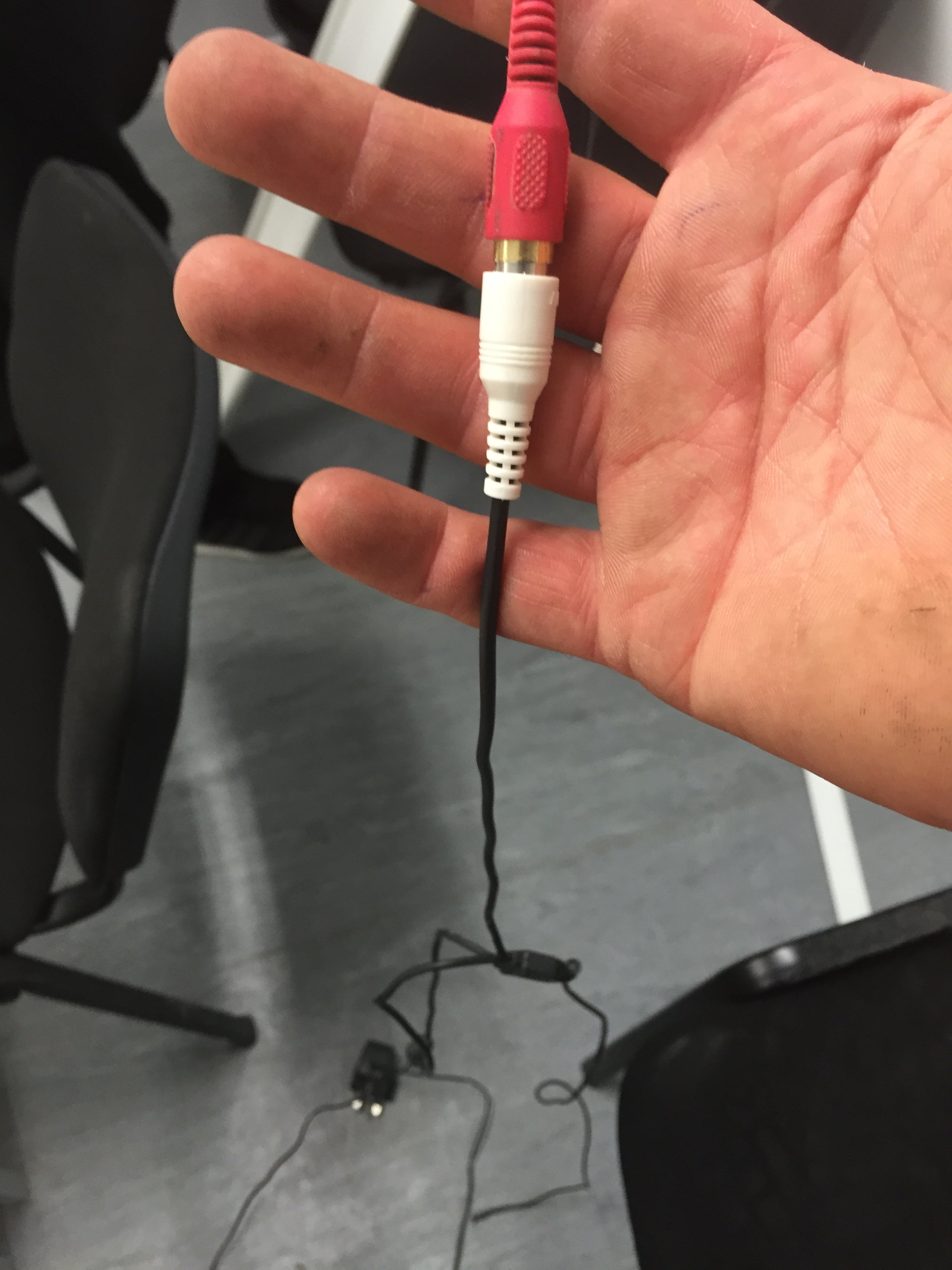

Mornings ,please could someone advise ,I have installed and Hikvision camera in a small office with a external microphone powered by 12v power supply within 5m range from NVR and Mic ,the problem is this it all worked fine and the audio was great now for some reason it stopped working ,I have changed the power supply ,look at the NVR audio settings ,nothing worked ,I tested the mic by putting it Into my IPhone and see if by tapping the mic worked nothing ,I had 2 microphones in the same office and both faulty can it be possible that the microphone can fuse or break ,I don't want to just get new ones incase it's not that problem can someone please help
