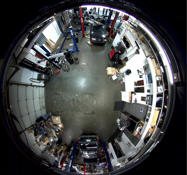

In the example image below you can see that although the fisheye is covering everything in the workshop, it's actually really difficult to identify anything specific because of how warped the image is. The only thing that would be in detail would perhaps be the top of someone's head as they passed under the camera!
In this scenario I would instead recommend using a couple of 2.8mm/4mm cameras pointed towards areas of interest as this would provide a maximum viewing angle of around 90° and be able to capture number plates and faces in high detail.
If we use a 3MP camera as an example, you can imagine how 3 million pixels used to build up a 90° image would be of much better quality than that where 3 million pixels have also been used to build up an image spanning 360°. CCTV users know that a 3MP camera is high quality so we find that our customers are usually disappointed when their 3MP fisheye doesn't produce the results that they expected. In our post explaining Hikvision focal length differences, image warping and loss of quality is noticeable even in our 2.8mm (90°) example image.
