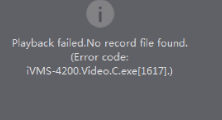

The latest one that im really stuck with is what seems like footage disappearing. Imagine you've just set everything up on IVMS 4200 (v3.1.1.11), got your storage server initialised, formatted and ready etc. All the ports working correctly. So everything is up and running, event schedule and event recording is all functioning as expected. Ive been able to record footage as I expect, spent the last hour or so adjusting sensitivity in motion detection and been able to review footage in IVMS.
SOOO... Imagine my surprise when I want to restart the PC to make sure it all auto launches again, in effect, simulating a power cut, none of the footage you have been viewing from the last session is there.
Where could it have gone? Is the storage server offline, well thats the first thing I checked. It was online, and it was recording new events (to an extent)
The error im getting when im trying to view footage from the previous session is below.
Please help! I will provide any extra information also. Im not sure how much to post now?

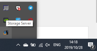

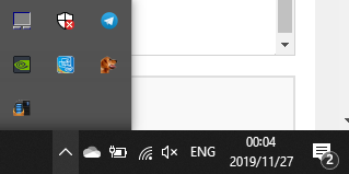

Check you have set the Storage Server to start automatically on startup.
On the taskbar, expand the hidden icons (usually up arrow). Right click Storage Server and select Auto Launch.
Tick Auto-Launch if it's not already ticked.
Restart the PC and check if it loads.
Depending on your OS and security settings, Storage Sever may still not load automatically. The main culprit is Windows User Access Control (UAC) which requires you to grant it permission via a confirmation window. This may also prevent the app from running after a power-failure.
Let me know how it turns out. If you receive the UAC permission window we need to take a different approach.

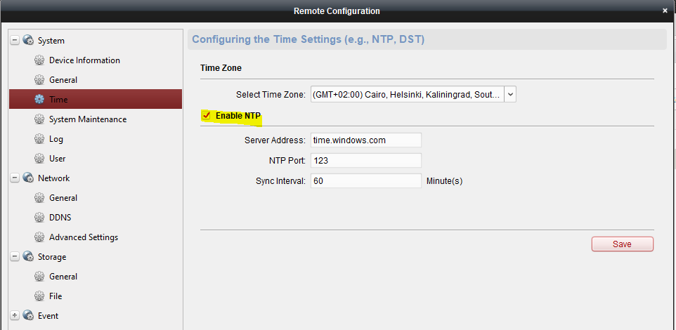

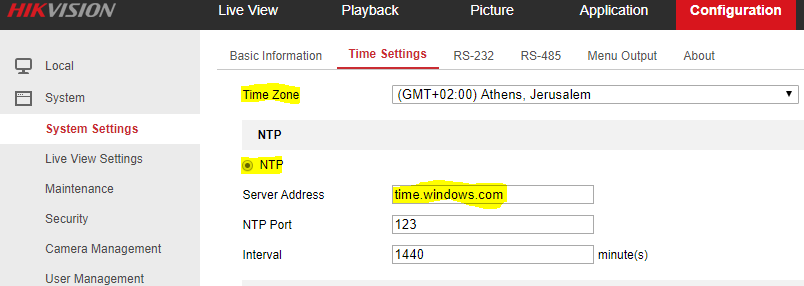

More of a best-practice but important - Synchronize the time across all devices. If possible set the cameras to use NTP server: time.windows.com and make sure the Time Zone is correctly set. There should be a Test button to check the camera is able to communicate with the NTP server provided it has internet access. If not, when you add devices to iVMS-4200 there is a tickbox to Sync Device Time with the local PC.
On the camera:
In Windows 7 you can sync with a NTP server in the Control Panel>Date and Time>Internet Time(tab).

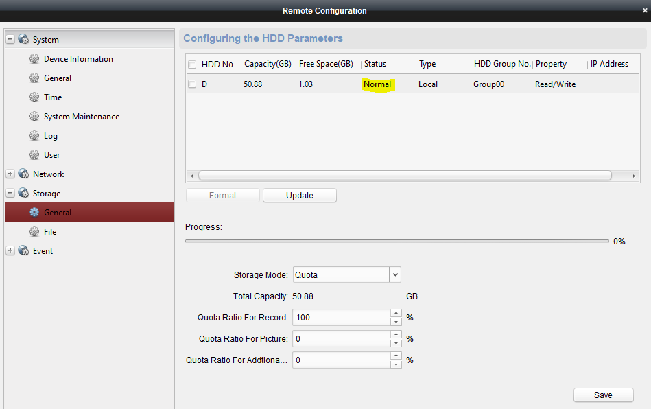

In iVMS-4200>Device Management select the Storage Sever and click Remote Configuration. Under Storage>General make sure the HDD/partition you allocated reports a Status of Normal.

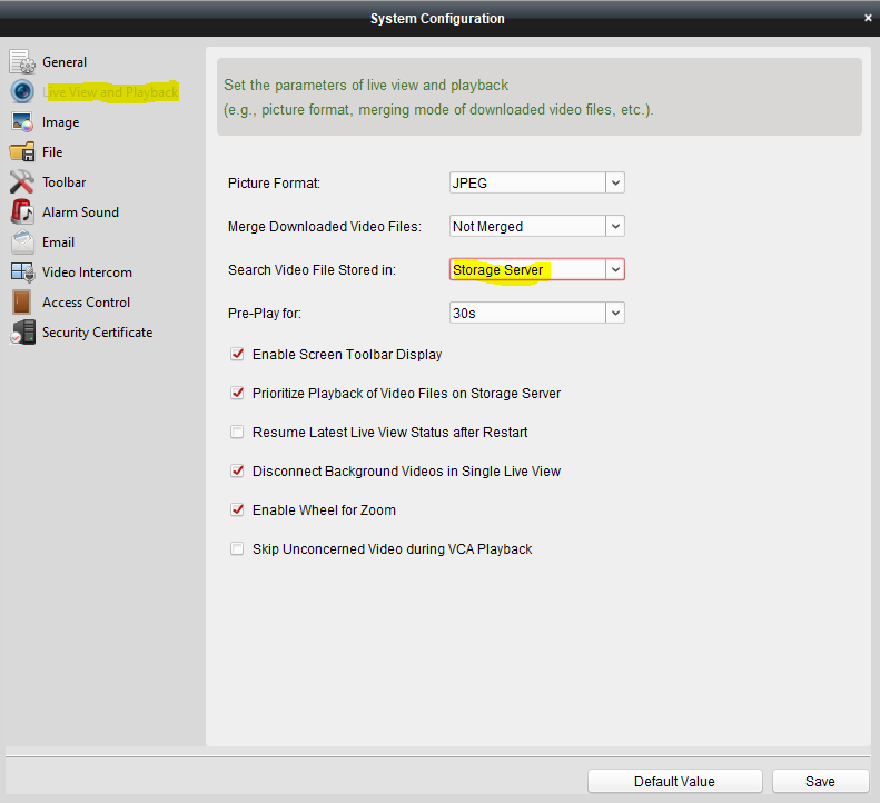

Also check here: Click Tool on the file menu and select System Configuration. Click Live View and Playback and set the Search Video File Stored in to Storage Server.

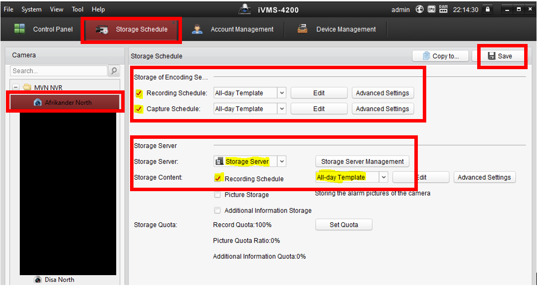

Lastly open Storage Schedule (added from the Control Panel if missing) and make sure each and every camera is set to record to the Storage Server using the All-day Template. Click Save for every camera you modify.
Reboot the PC to make sure the changes take effect. When you log back into Windows check the blue storage server icon and the dog head (iVMS v2) or red circle icon (iVMS v3) are visible in the icon tray.
