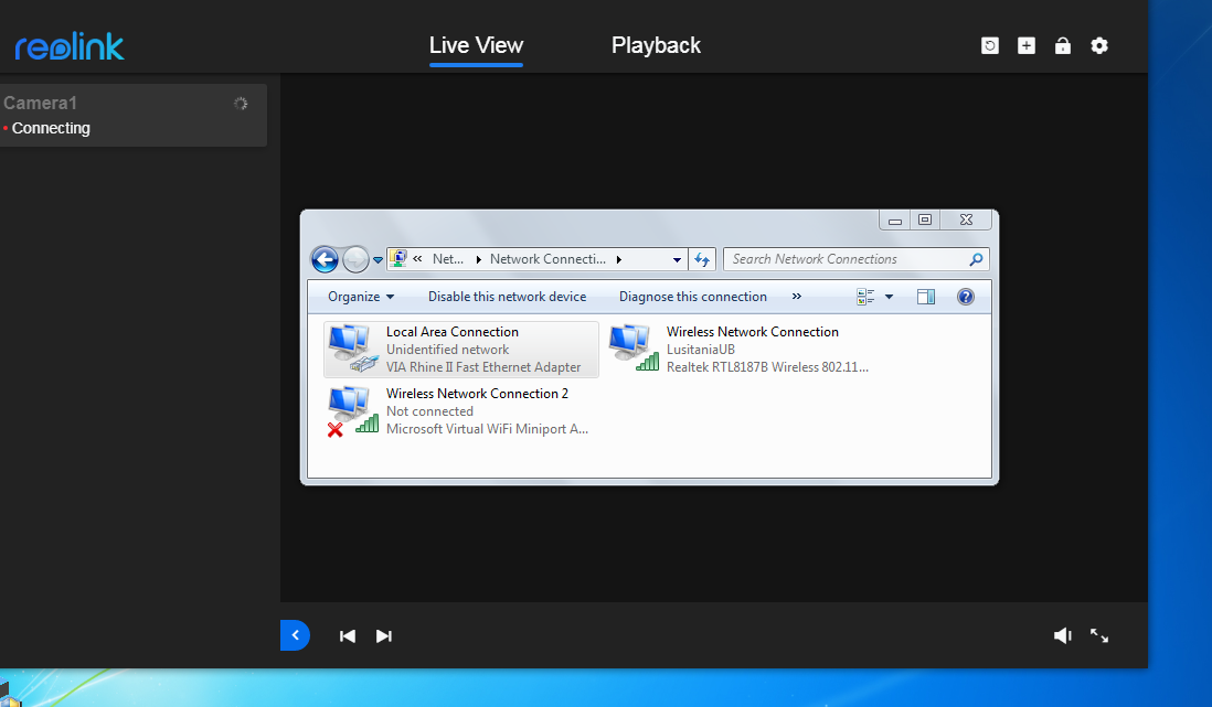

Trying to set up 1 powered IP cam, recording to 1 laptop - configuring IP side is killing me. pls help

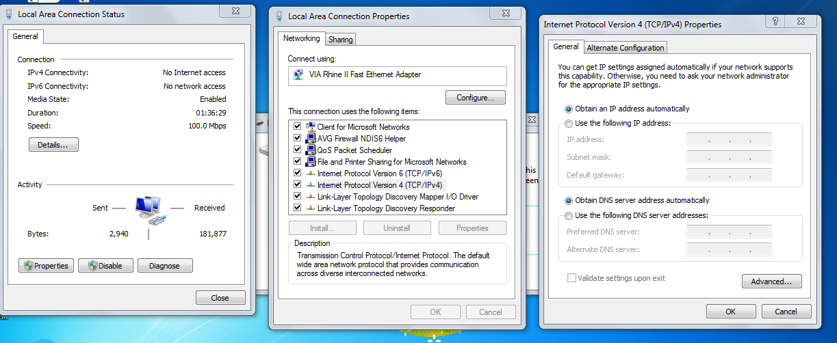

You can test by enabling DHCP on your camera and laptop ethernet interface and restart laptop / camera. Then logon to your router and check the connected devices list to see if the camera is there. You should see the cameras hostname if not you will need to check for the cameras `Mac address, this maybe printed on the camera body label. The MAC address format varies but is a hexadecimal number like 00-0C-29-58-CC-BD, sometimes called the physical address.

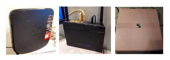

I have taken a pic of my home network set-up - maybe it may help present a solution to my problem :
So, the Virgin hub is directly connected to the house internet/broadband cable.
The Virgin hub is then connected by ethernet cable to a more powerful WIFI router(ASUS) - (the Virgin hub wifi wasn't itself powerful enough and had frequent dropouts when trying to access it on tablets & phones downstairs/other rooms - all good now)
My PC box is then connected by ethernet cable to one of the ports of the ASUS router as you see.
The pic last is the laptop I will be connecting the camera to.

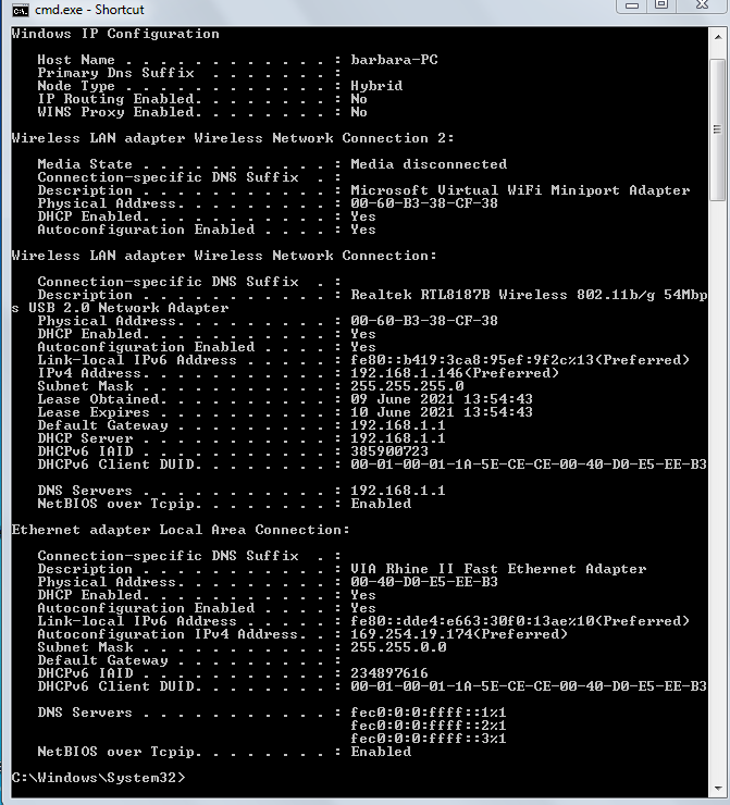

Have you used the DOS command prompt? If not google how to open it for your version of windows, we'll use it to get the MAC addresses of your laptop.

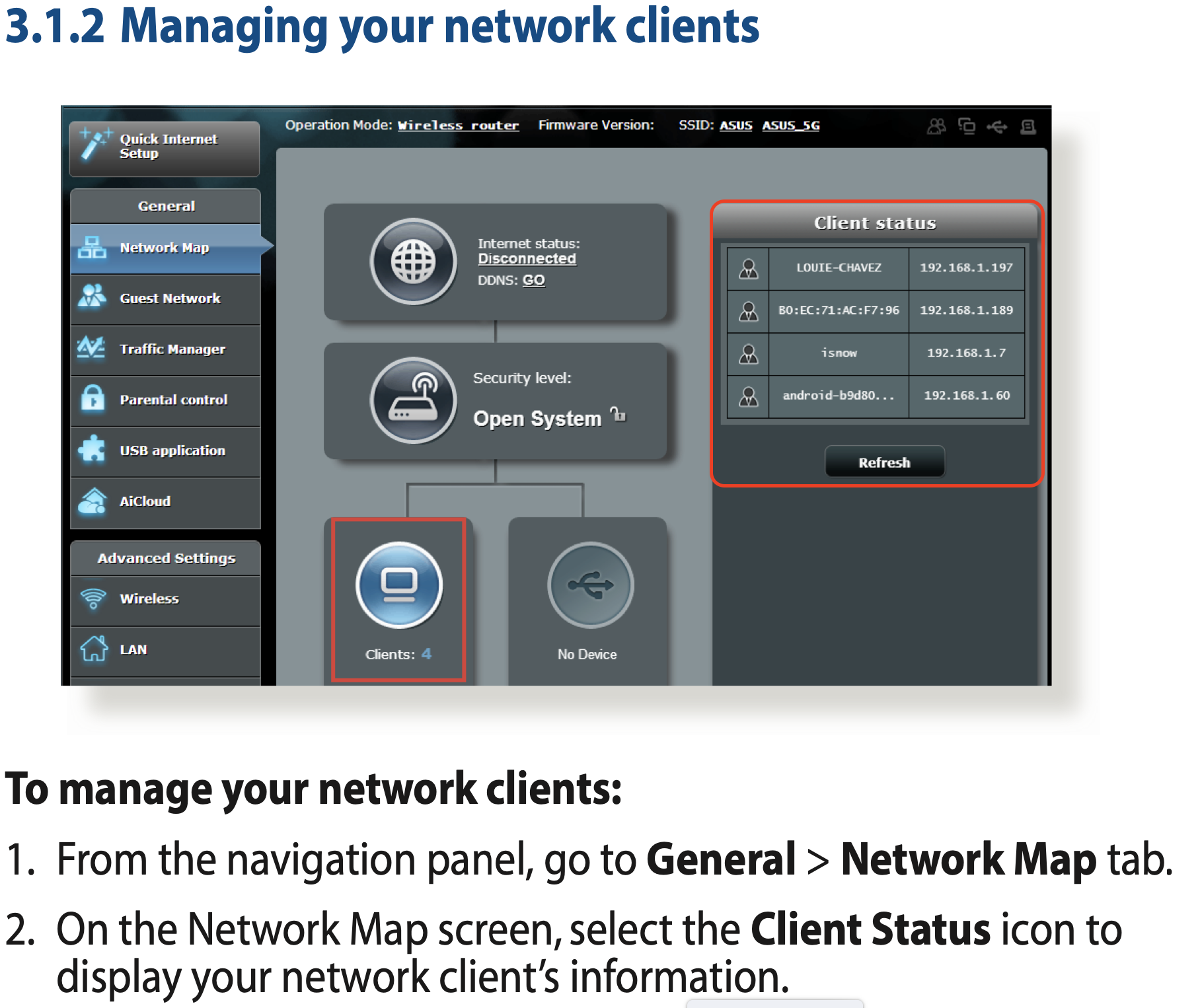

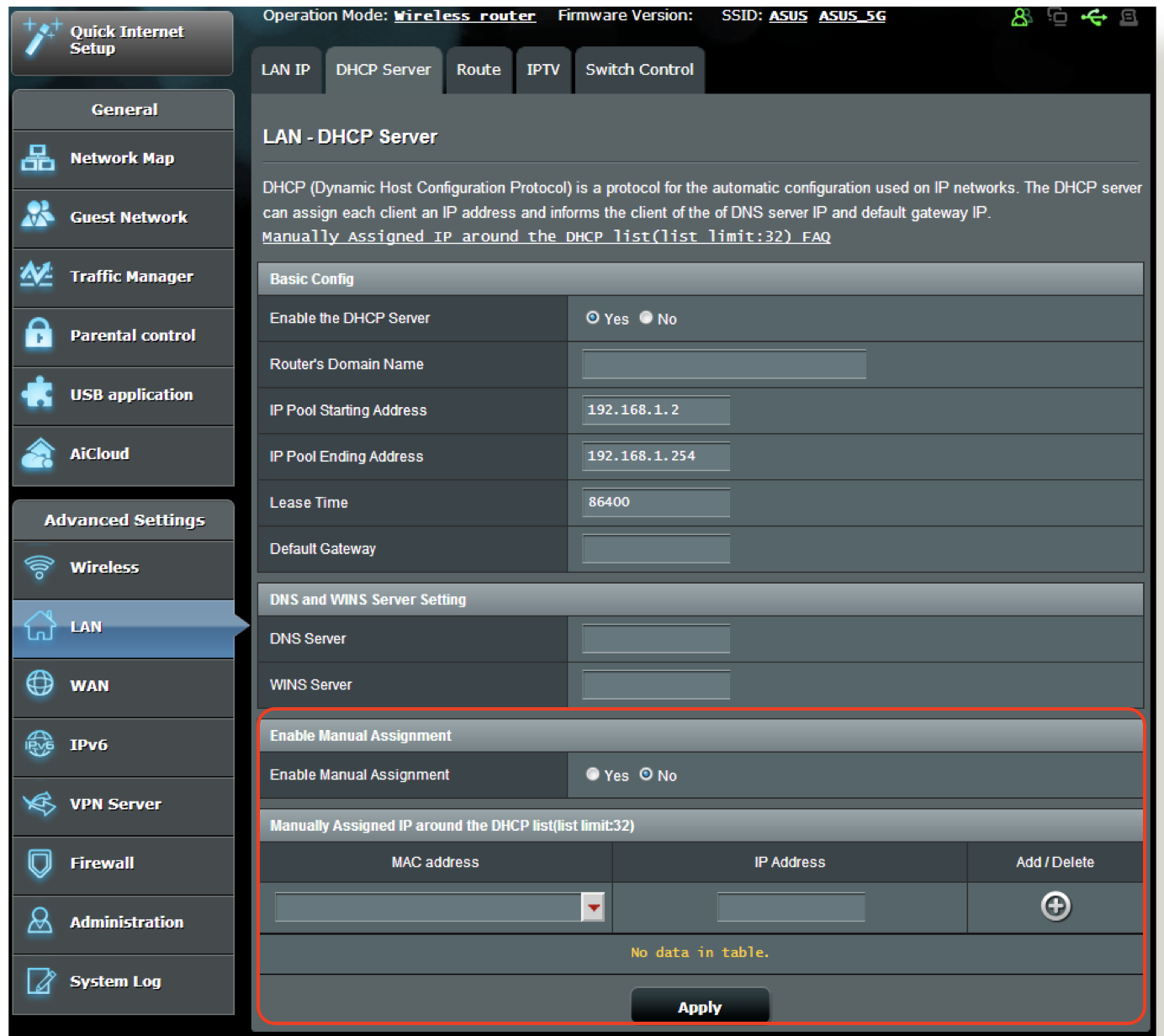

Your ASUS router will support 32 fixed IP assignments, log in and take a look. See red area in attached image.

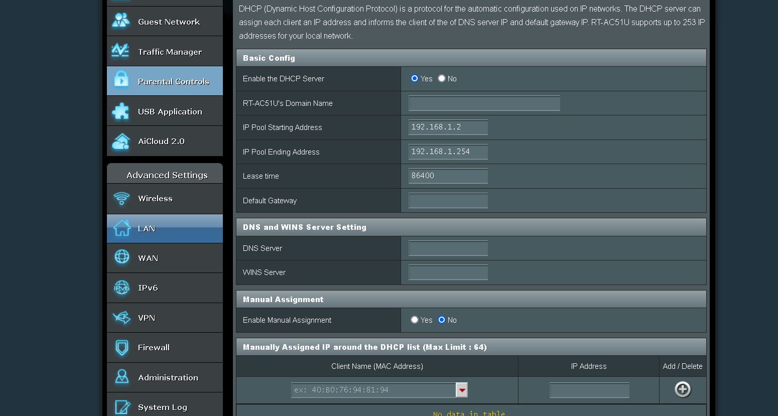

I've taken a screenshot of my DCHP page in ASUS setup - the numbers on my screen look a bit different to yours.
That picture came from the ASUS router manual.
The router DHCP server assigns IP addresses to clients (laptop, camera, smartphone, tablet, smartTV etc) on your network. Now the router knows all the clients on the network and can route information between clients and the internet. When a client has DHCP enabled and joins the network it sends a message that the router receives. The router replies with the clients own IP address (from the pool), Gateway, DNS. The client receives this and adopts those settings.
Some cameras come with an IP address already assigned and DHCP is disabled, in most cases you can download a program that will let you enable DHCP for the camera. The alternative is to setup a private subnet (as you did) between your laptop and the camera and enable DHCP.
The gateway is your router (gateway to the internet), and has the address 192.168.1.1
Domain Name System (DNS) is the system that translates website names (google.com = 142.250.179.238) to IP addresses. Clients usually use the router IP address or you can use an IP address from another DNS server.
Fixed IP addresses are used to make sure certain devices always use the same IP address, this is important when the camera is sending video data to your laptop. The router DHCP server uses a table to make these reservations by associating the clients unique MAC address with an IP address, the router will only issue this IP address to that clients MAC address. In most cases it is best practice to let the router manage IP addressing, it avoids IP conflicts.

Image below shows clients attached to the ASUS router, you may see them as a name or MAC address. That is why you may need to know the client MAC address to associate it with an IP address so the router can always assign the same IP address to that MAC address.
Using the DOS prompt you'll find the wireless / ethernet interface MAC address with the ipconfig /all <press enter> command. Each interface is listed separately. It can be a bit confusing, be careful that you get the right IPV4 MAC address.
Create a list to show client name, IP address, MAC address, comment. You can use that to create the router fixed IP assignments.
Find the MAC addresses for these clients
Camera ethernet. Maybe written on the body.
Laptop WiFi. To be used as a backup for the ethernet connection.
Laptop Ethernet. It would be better to use a cable to connect your laptop to the network. For my security cameras I use ethernet cable, I wouldn't trust wifi. Sods law the wifi link will fail just when you need it.

The new camera arrived, and I downloaded the Riolink client software to see how far I could get without troubling you.
On opening, the software looks for new camera/connections.
Pic 1 - showing 'connecting' in top left corner of client screen. After trying 'connecting' for several seconds, it will go to 'timeout' before going to 'offline' eventually, and staying there.
So, I'm getting the same 'not connecting' result as before...lordy...

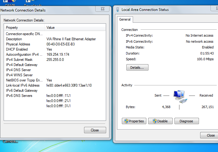

As you see in pic 1 also - the laptop ethernet Local Area Connection shows 'unidentified network' and will show 'network cable unplugged' when I disconnect anything. I was worried that the actual ethernet socket itself was malfunctioning in some way. I also checked the copper connectors inside the laptop ethernet socket - all looked clean/ok
Pic 2 is ipconfig/all to let you see what's happening
Pic 3 is 'properties' screen clicked in 'Local Area Connection Status' showing 'Network Connection Details' on the left
Pic 4 are the pages : Local Area Connection Status, Local Area Connection Properties and Internet protocol Version 4 TCP/IPv4
These pictures are all before I have changed anything, just to let you see the status of everything before any changes are made.

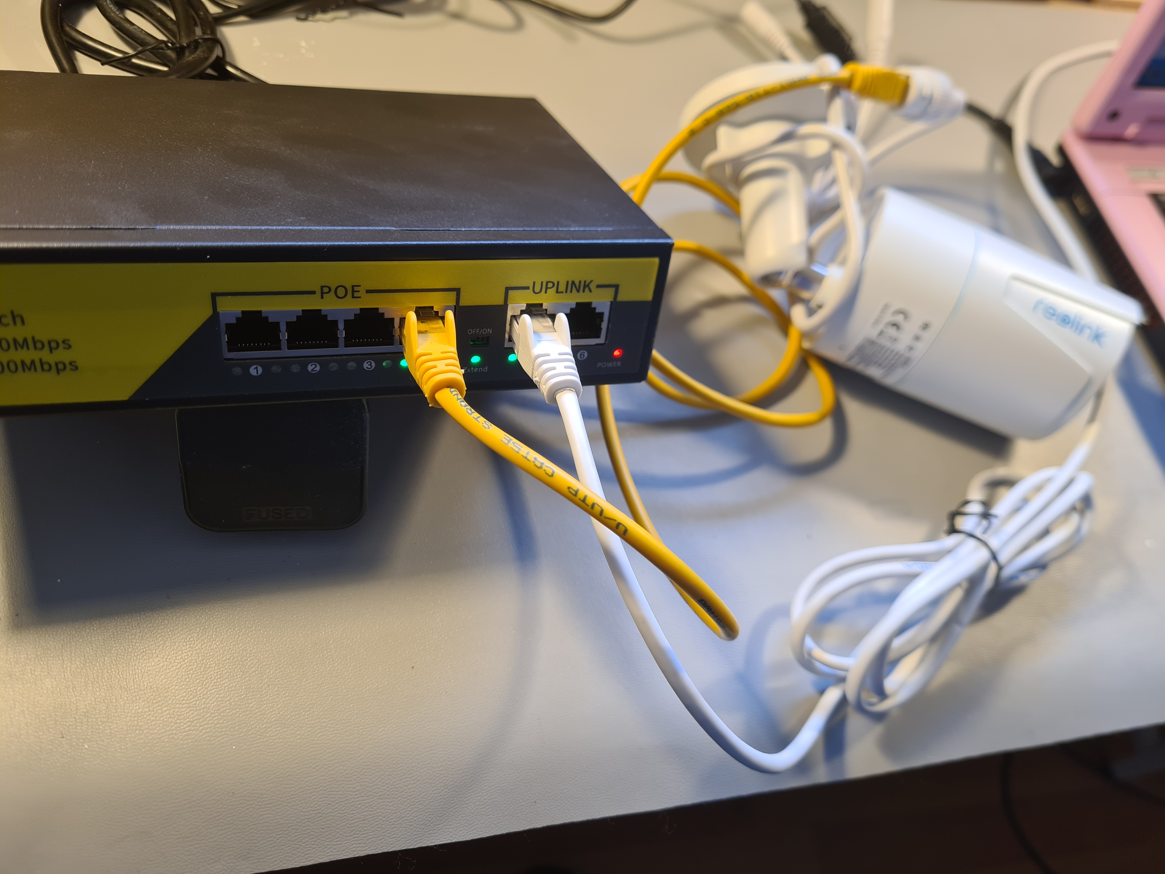

Hi David,
I unplugged everything and then reconnected everything and opened Reolink client software - unfortunately, with same result as before, I'm getting the 'connecting/timeout messages' in the client software.

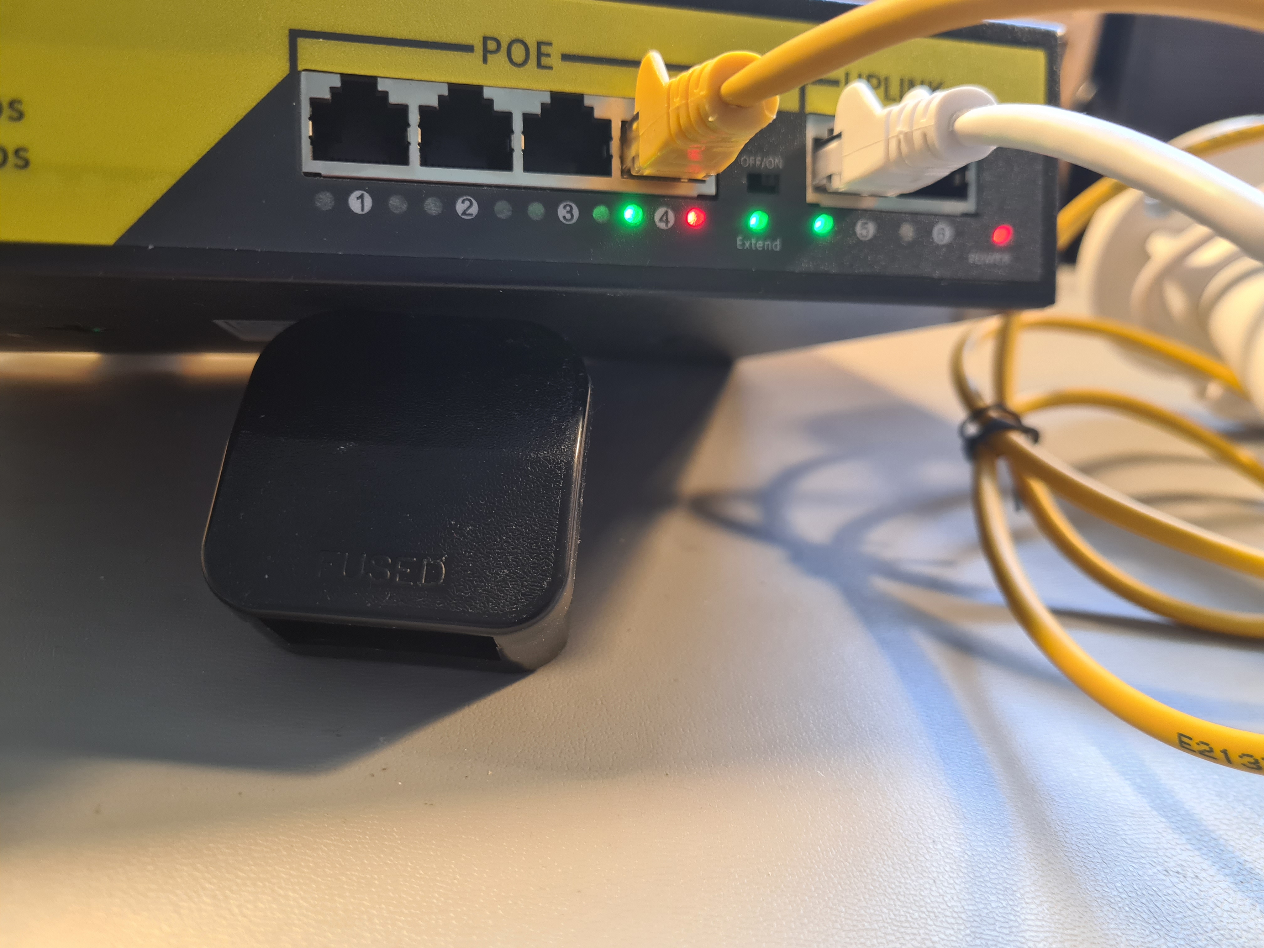

I have taken a couple of pics of the actual setup/elements involved :
Pic 1 - yellow cable from camera pigtail socket to poe box port - white cable from poe box uplink port to ethernet socket in laptop
Pic 2 - lights on poe box

Connect the uplink port to the router, I think you missed one of my earlier threads. I’ll add more detail later when I’m on my notebook.
