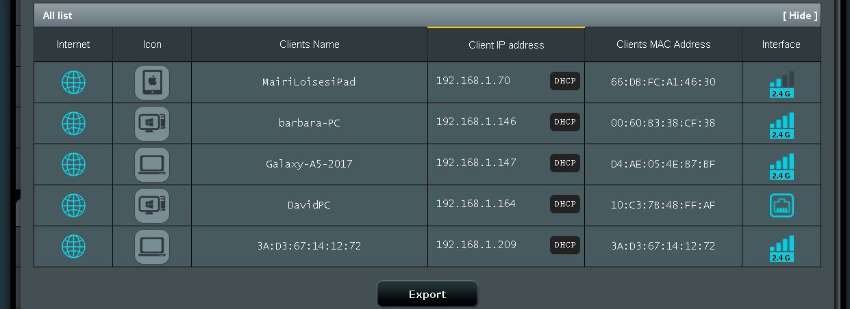

Hi David,
Here's a pic of the ASUS router client list showing 2.4ghz.
I did go to the web and found references on how to change settings to 5ghz in the Advanced Settings 'Wireless' page, which I did.
(in the General page, only the 'Band' setting had to be changed to 5ghz, and in the Professional page, 'Band' was changed to 5ghz and 'Enable Radio' was changed to 'yes')
As you see from the client page, nothing changed to 5ghz. I mean, everything is working ok with the 2.4ghz and if that's all we can have, it's ok.
But I was thinking, we don't need wifi over long distances, we're in an ex-council terraced house with thinnish walls, 5ghz could possibly work better.
(the ASUS router is a dual band but seems to favour giving out the 2.4 over the 5)
'Did you mean the second uplink port on the poe switch?' - yes
'have you added the MAC addresses for the fixed IP addresses?' I have

Hi David,
'This is normal, when you move the camera there is a delay as the camera has to process a lot of data. When the camera is in place and stable you'll be able to tweak the settings to get it right for your view' - excellent
Cheers View attachment 5965
For ASUS, automatically moving clients from 2.4GHz to 5GHz is called Smart Connect and I don't think its an option on your router. You could change the wifi SSID to end with 24G and 5G like wifinet24G and wifinet5G. You could try disabling the 2.4GHz and see what the 5G coverage is like. Signal attenuation through walls for 5GHz is higher than 2.4GHz.
On the PoE switch connect the camera and laptop to the normal ports and leave the router on the uplink port.

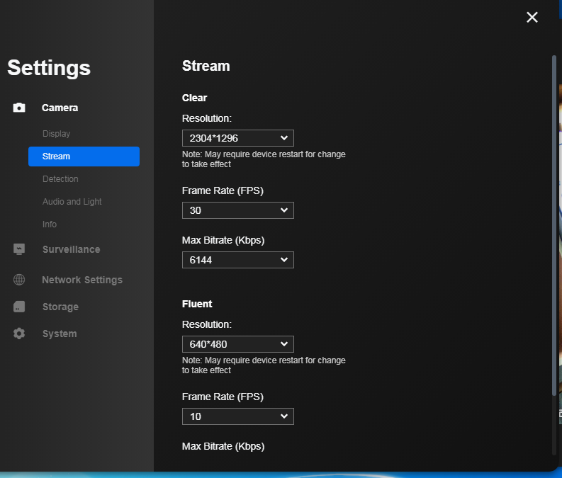

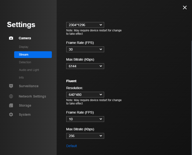

What are the camera video settings?

Hi David,
Have taken 2 screenshots of the settings. The Reolink settings page doesn't let you maximise page to see everything, it's a scrollbar at the side, so had to take 2 pics to show all settings :

Hi David,
Have taken 2 screenshots of the settings. The Reolink settings page doesn't let you maximise page to see everything, it's a scrollbar at the side, so had to take 2 pics to show all settings : View attachment 5966 View attachment 5967
The old laptop may have problems. on the clear stream reduce FPS to 20 change max bit rate to 7168. You may have to reduce the resolution. If you are recording clear and fluent streams disable recording for the fluent.
try not to move the camera as a test, move your fingers in the field of view.
