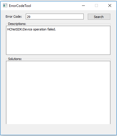

FWIW - in typically unhelpful fashion the error code tool says:

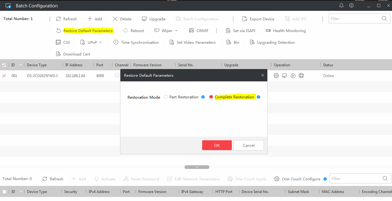

Forum software update
Thanks for the suggestion but when I try it comes up with 'configuration failed' message. Also can't change the IP address from within the BCT.
