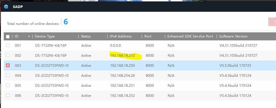

Here is a Image from my SADP scan 192.168.18.253 is my DVR does the SADP pickup the DVR?

Ok your 7732NI-K4 NVR is running the latest firmware
Is the PC/Laptop you are running SADP on plugged directly into a port on the NVR?
No, the SADP tool is run from my local PC on the range of 192.168.18.x
If i plug the a laptop into the DVR network points it did show the camera currently offline and then threw the .250 .251 .252 cameras to 192.168.254.x range
I cannot understand your network setup.
If you are viewing SADP on a PC connected to your local network you should not:
1) be seeing the NVR duplicated twice - once with the IP address and once with no IP address
2) be able to see the camera directly connected to your NVR - the 192.168.254.26 camera is the camera directly connected to your NVR but this subnet range should not be visible from your local network.
Have you tried entering one of the 192.168.18.xxx IP addresses in Internet Explorer to try and login to one of those cameras directly?

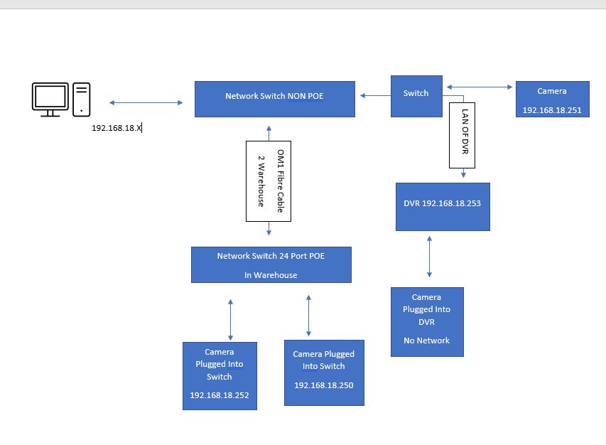

Are you able to draw a rough sketch (either paper & pencil or using something like paint on Windows) of your network layout to show us how all the elements of your network are linked together? (e.g. where is the router in relation to the NVR, remote cameras, and the PC that you are accessing the system with)
Something about your system layout does not currently make sense.
