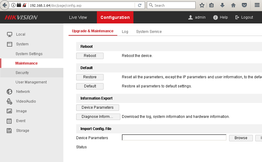

I updated a DS-2CD2025FWD-I camera from firmware 5.5.51 to 5.5.61.
I'm logged in as admin. I no longer have an option to change the firmware back. See attachment.
I've tried restore to default on the maintenance page and a hard reset using the button on the camera. No luck.
Any suggestions?
Is it just a browser rendering issue?
Ctrl+F5 refresh your browser.
Clear your cookies.
Check with IE11.
Clear your cookies.
Check with IE11.
Thanks Phil. IE11, which I have not used in ages works correctly.
Ctrl+F5 and a complete clean via CCleaner made no difference for Firefox and Chrome.
Chrome version 69, Firefox version 54 and 62 did not render the page correctly, only IE11.
Much appreciated.
Quick update. After downgrading the firmware back to 5.5.51 both Firefox and Chrome are rendering correctly.
