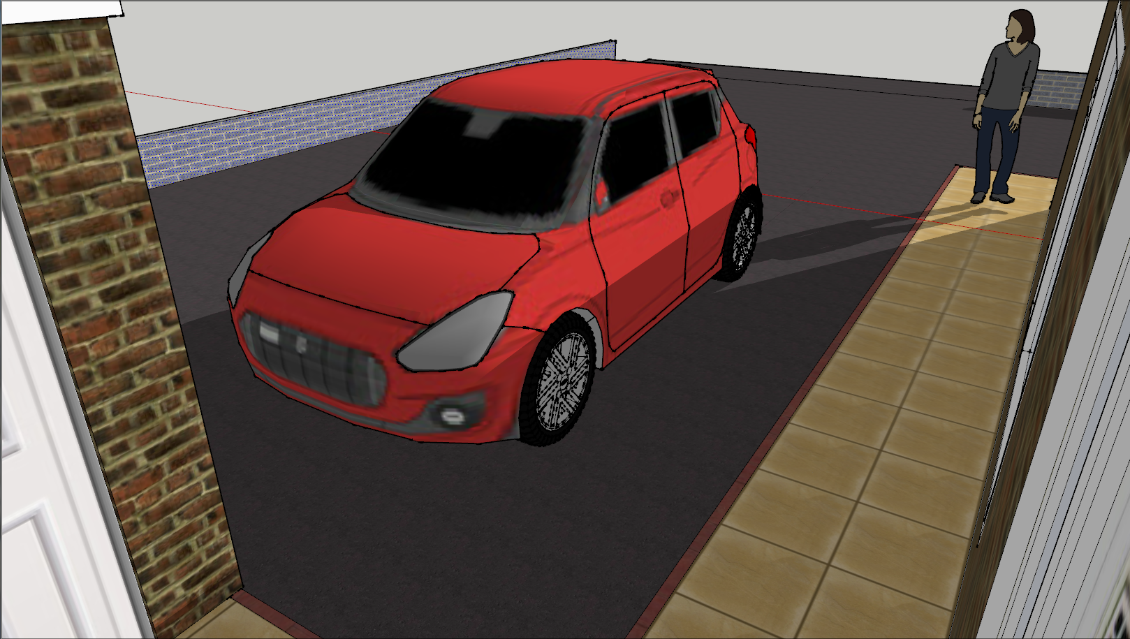

I was looking for a way to get a rough estimate of camera placement and thought I would use Sketchup as I already had a model of my bungalow that I used for some garden and internal remodelling. I simply extended it to include the garage and part of the front drive and then I placed the camera where I intended to position it and set the camera properties to match my chosen Hikvision lens , as close as possible.
This is the Sketchup result with a 4mm lens...

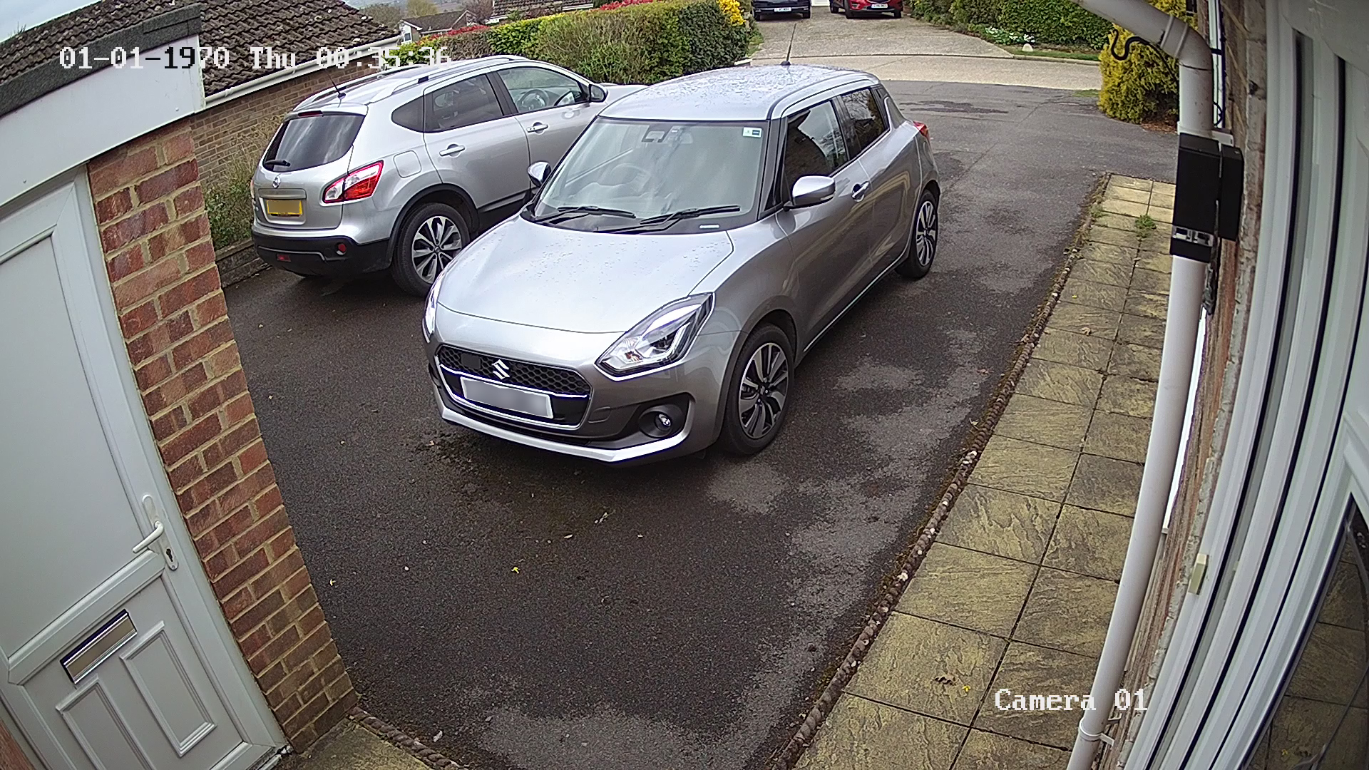

I finally got around to installing the camera today and was pleasantly surprised how close it was to the Sketchup model. This is the Hikvision DS-2CD2345FWD-I with a 4mm lens.
