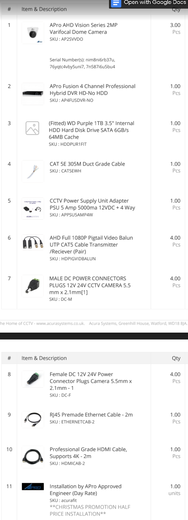

Hi guys new here, I bought these 3 CCTV cameras with DVR from Acura Systems... unfortunately for me soon after they went out of business and their site is gone. So troubleshooting this is a nightmare, I cant even figure out which cameras they have as they are branded Apro and im pretty sure thats just a slap on label. [Attached Invoice and product names]

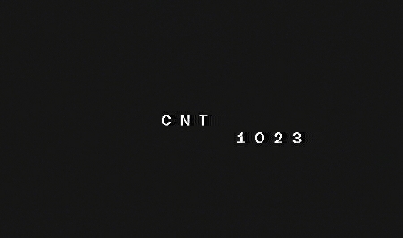

Anyway they work fine, but they use a software called Surveillance Client V1.3.7.1 and i wasn't sure if my camera was PTZ, so i clicked right on the pan, and the screen blacked out showing a code CNT 1023 as [attached also].
Now for some reason the camera has gone black and white and also seems zoomed in.

(Trying to undo or use the PTZ from the software has no reaction at all... camera just seemed to react that one time and i heard the DVR anti tamper sound, and now its black and white like IR mode but even in the day time)

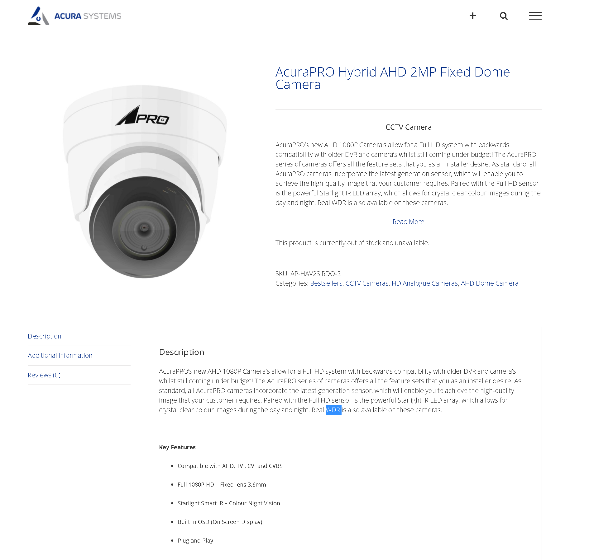

Ive attached the camera picture of the model Im almost sure it is now, which varies to the one i suspect in the invoice, because my camera looks like this not the varifocal variant. So perhaps they short changed me on the camera, my fault for not double checking on the day.
So i dont think i can vary the focus or zoom as i cant see any screws, unless its inside the anti-vandle cover. But if its definitely not PTZ, im wondering how its managed to be more zoomed in and moved upon clicking pan and then subsequently not responding and causing this issue. And also be in NVM permanently.
Im thinking it somehow moved and got dirty on IR, which caused NVM so when i get ladder will clean and change angle to where it should be and hopefully a clean of sensor will restore color.
