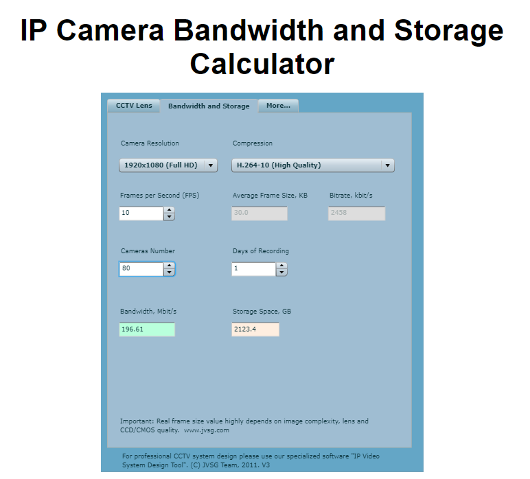

Enter your camera type, CODEC etc into a bandwidth calculator such as the one at our Blog:
IP Cameras and IP CCTV IP Camera Bandwidth and Storage Calculator
It indicates that you will only be able to manage about 80 2MP cameras at 10fps using the h.264 CODEC per server.
You will need multiple servers.
