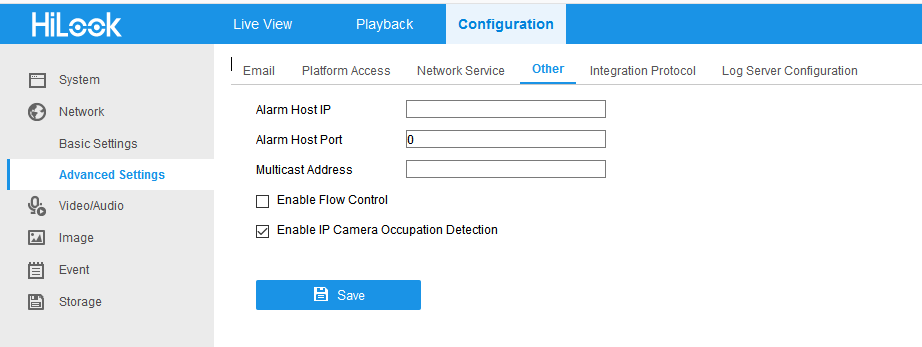

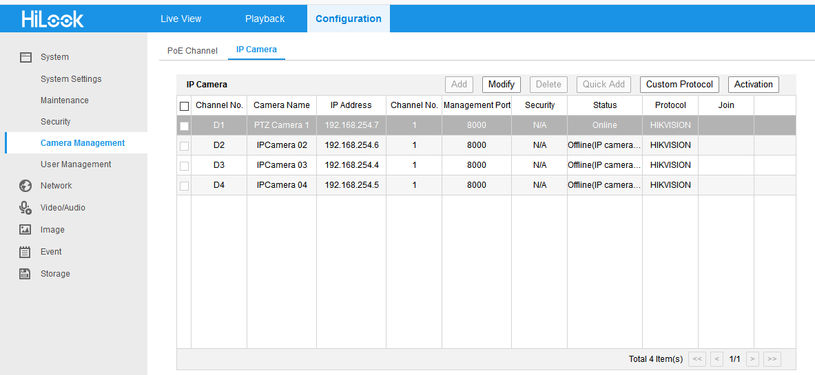

Hi. I have a 104H-D4P and am trying to work out how to get access to the connected camera's configuration page. I understand that the cameras are on a separate network behind the NVR and that I should enable virtual host to get the link to appear. However there's no option in Configuration/Network/Advanced Settings to enable virtual host (see attached screenshots) Ideas anyone?? My understanding is that if virtual host was enabled then the link would appear in the "Join" column of the IP camera configuration table.

Hi Phil. Thanks for replying. Firmware version is V4.30.055 build 201111 and an online check says this is the latest. I suspect that Virtual Host does not exist on this model which is a bit of a pain as I'd like to be able to manage the cameras remotely. You can't even get at them using port forwarding as they're on a 192.168.254 subnet hidden behind the NVR. Up to now I've had to plug the laptop into one of the NVR's camera ports and give it an IP on that subnet to let me get at the cameras on the other 3 ports. It's mainly for tweaking the motion detection sensitivity.
