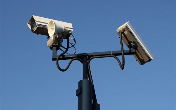

Hi all.
I see in many more commercial set ups cameras like these in the picture.
What are these and when to use that type of heavy metal camera instead of a HIK type camera?

Essentially, they are old.
It was all we had at the time.
It cost a lot more.
You had to assemble a lot of components:
  • camera
  • lens
  • PSU
  • Housing
  • Maybe a wiper
  • Maybe a washer
  • Maybe a mount or a pan/tilt head
  • Maybe a separate box telemetry controller
  • Maybe an infra-red lamp
  • A whole lot of interconnecting cables
  • A lot of time and labour
Now, you can achieve the same in an integrated unit from the manufacturer.
Outlier cases may still exist, such as where you need a very big lens e.g. one with a very long focal length, which is consequently large/long (and not available as an integrated solution). But speed domes have even superseded the use of most fixed cameras with big lenses, as speed domes are now available with say 45x optical zoom (to around 100mm focal length).
