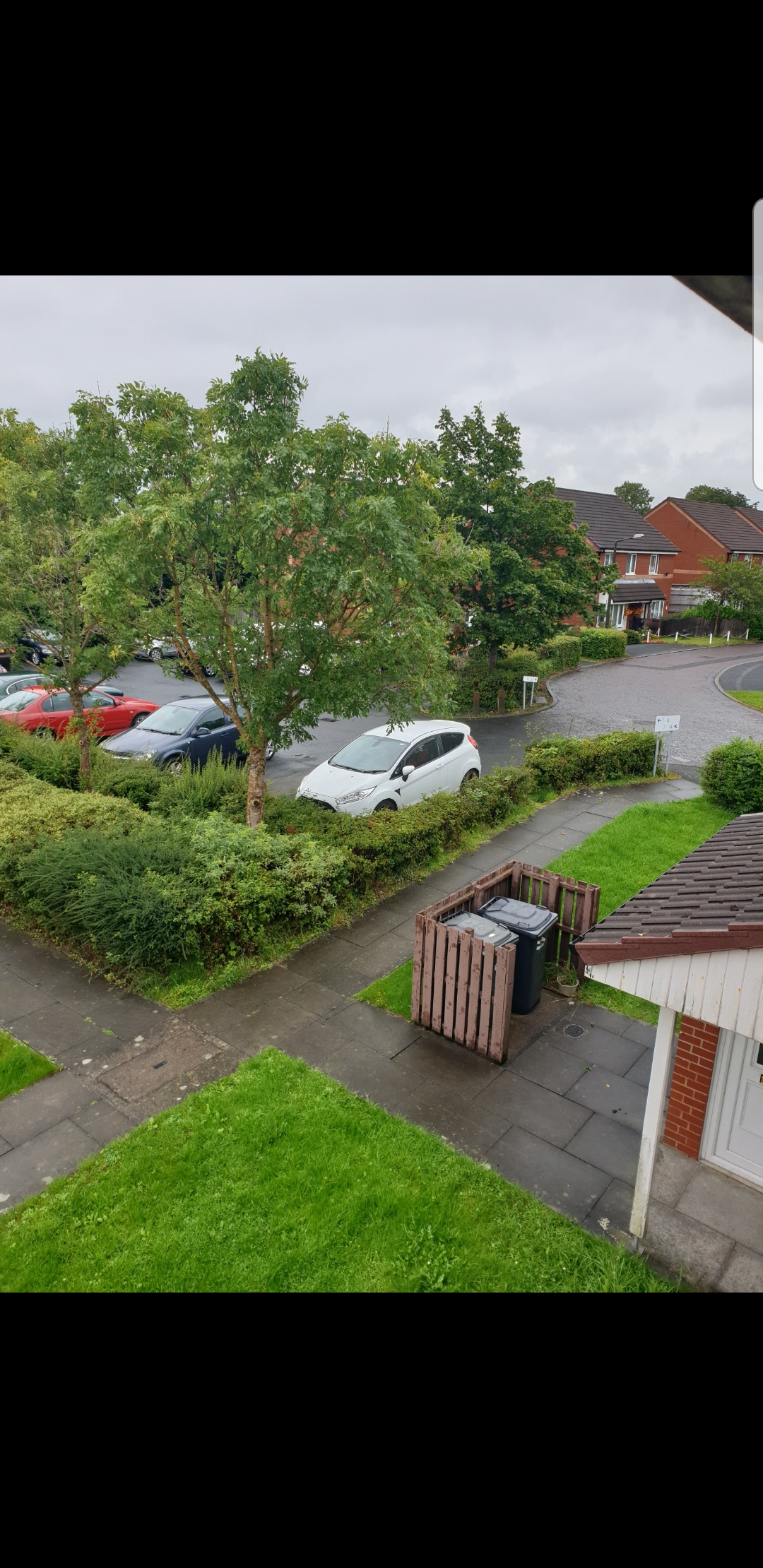

This pic is taken from my phone at soffit level which is about 22to 25 feet high the blue cat is about 35 ft away I need to be able to pic up the car and that bit of white door to the right.
I have dicided on your 4 port poe hikvision nvr but stuck on a camera.
I was preferring a turret camera for under soffit as more discrete but I'm stuck on diciding 2.4 0r 4mm lense.
Not really bothered what make of turret camera as long as it works with the hikvision nvr but I'd prefer one with sound and trying to keep cost down. I know the dahua do sound but again be unsure which one to get.
Any advice please
4mm
