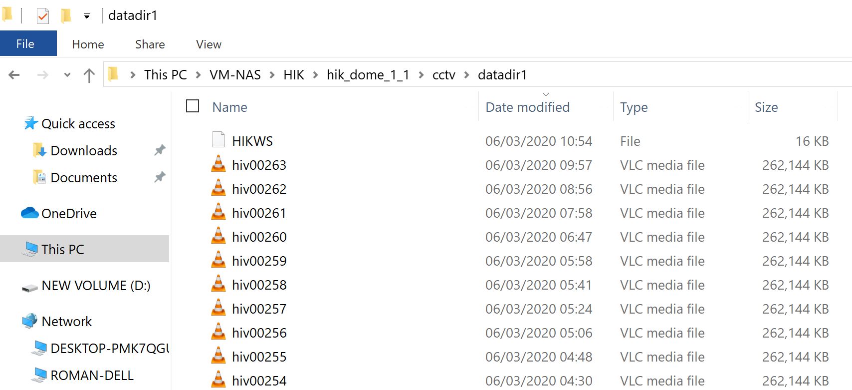

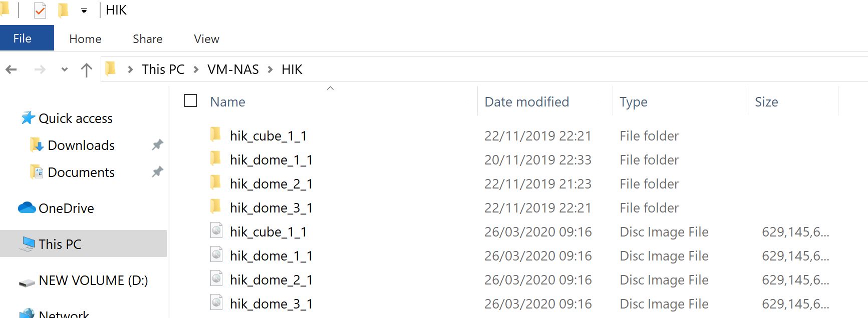

1. I use Samba to set up separate share for each camera (600G for each). Separate shares are needed as otherwise single disk becomes "Uninitialized" shortly after you add it to second camera and format it. In other words camera needs exclusive use of disk to figure out how much space it can use.
If you need help with creating those shares pls let me know. In my case you will see that each of 4 cameras has dedicated Disk Image file. That file is mounted to filesystem so content is accessed by folder hik_cube_x_x.
2. When you initialize disk it creates folder structure (there will be "cctv" folder and lots of "datadirX" subfolders) and empty files to store videos and pictures inside "datadirX" folders.
3. When the camera records it immediately stores the footage on your NAS. You don't need to back up anything. You can even open the file that is being written by camera at the same time.
4. All files have a timestamp when they were updated. So if you want to view the footage from specific time simply find the file with that timestamp:

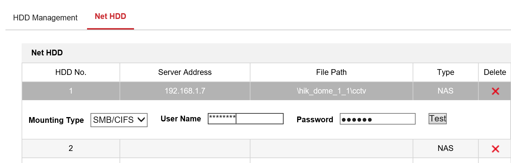

I setup NAS directly from the camera. Never tried NFS - just Samba:
From what I researched: each camera needs a dedicated disk. If you add the same disk to multiple cameras they will not know how much space is available for each one. They cannot cross-manage their space requirements.
To overcome this you can either:
- create virtual disks on physical drive (eg. 4 virt disks of 1GB on single 4GB drive), mount them and expose them via Samba
- use user quotas on bigger disk (never tried that) so each camera (with different user) has access to only eg. 1GB
- maybe there are some other bespoke mechanism from NAS.
