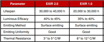

So how is EXIR 2.0 an improvement on standard EXIR?
  • No need for a secondary optical lens
    • Standard EXIR LEDs must use a secondary lens to focus the infrared light to match the cameras viewing angle
    • This is not a requirement with EXIR 2.0 technology
    • Improves IR utilisation by around 10%-30%
  • Better heat dissipation
    • EXIR 2.0 LEDs are made from a different material that improves heat dissipation
  • Longer lifespan
    • EXIR 1.0's lifespan is approximately 20,000 to 30,000 hours
    • EXIR 2.0's lifespan is approximately 30,000 to 40,000 hours
  • Suitable for near to mid range infrared monitoring
    • EXIR 2.0's improvements can focus within 25mm
A quick look up table can be found below :)
