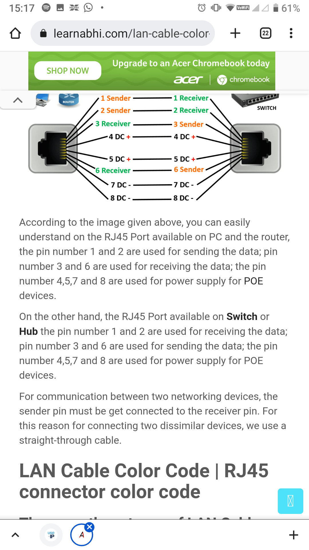

Is the below diagramme is correct, then the wires 4/5 and 7/8 can be "linked" together and used for power only (i.e. in essence only 1 wire will be used for power instead of 2 hence likely to limit range/distance but should not be an issue for short cable runs?
