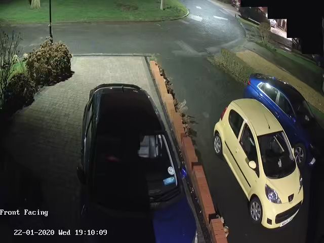

This post is really interesting to me as I have been toying iwth replacing my current 2365G1 camera with the 2347G1 Colorvu. I have external street lighting and PIR lighting in the area that the 2365 covers but want to deal with a dark patch that is not lit unless the PIR lighting comes on. At the same time I can use the 2365 elsewhere so its win win, or so I thought.
An image of the area is attached with the dark patch shown mid to bottom right, covering half of the car. I was hoping the Colorvu would lighten this area up without the need to have its integral light on, as I do not want to annoy the neighbours too much.
I also now realise that the Colorvu does not have IR and I believe, though would be grateful if you could confirm that the integral light comes on when the lighting reaches a certain level and does not independently react to movement.
Your thoughts would be welcome and appreciated.

Hi @gp116126
The ColorVu cameras do not have IR and you are correct that the White visible LED floodlight takes the place of the IR LED and will stay on all the time when it is dark enough for the camera to use it. (the time period the white LED is on at night is shorter than the traditional IR LEDs as the camera can go to much lower LUX levels before the LED is triggered)
As I say above the Hardware of the ColorVu cameras has been tweaked with a different sensor and wider aperture to achieve more detail in low-light (see Hikvision EasyIP 4.0 brochure for more details - p10-11), so it is possible that you will see more detail in that dark spot.
It is also possible to turn the supplement light off and just relay on the light already in the scene. (e.g. street lights/PIR lights) I would also look at adjusting some of the 2365G1 image settings, like exposure, shutter speed, and WDR, before you take it down as you may be able to get some improvement from the camera you already have.
