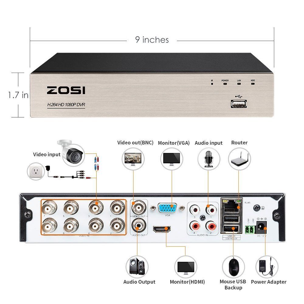

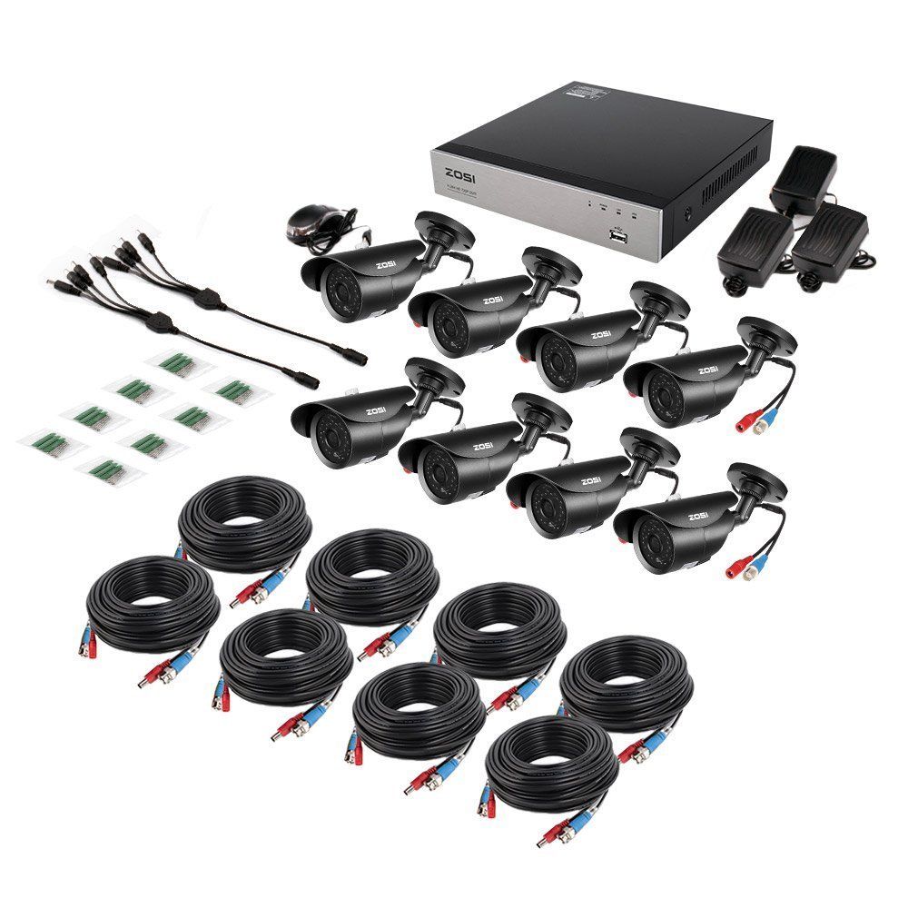

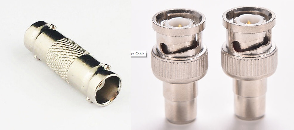

Hey, thanks a lot for the reply. Attached are a couple of images pulled from their website.
It would be great if I could just buy another box, plug these in and get a more reliable system!
Phil
Administrator
Staff member
1,691
Likes
127
63
#4
Looks like standard analogue CCTV.
Which is the same for all brands.
e.g. composite video 1 volt peak-to-peak
There is a slim chance that it could be HD or some other variant - please provide a link to the manufacturer's product web page and I'll take a look and check for you.

It looks as though the cameras are standard analogue (although the DVR can handle other inputs - hybrid).
You should be able to replace it with a standard DVR.
We don't offer any DVRs, so I can't make a recommendation.
I would say to select from a shop that shows product reviews (this must be the biggest failing of eBay, that people cannot provide feedback).
The cameras are very low resolution at 720p / 1MP.
I know that you said that the cabling to the cameras was challenging.
You might want to keep your future options open by chatting with a provider of say HikVision Turbo DVRs (Dahua and others offer similar).
Turbo, TVI, CVI technologies allow you to achieve HD over co-ax.
So that, should you need to replace any cameras in the future, you'd be able to purchase individual higher resolution analogue cameras.
