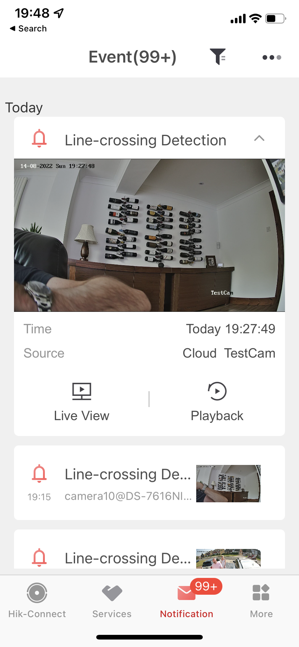

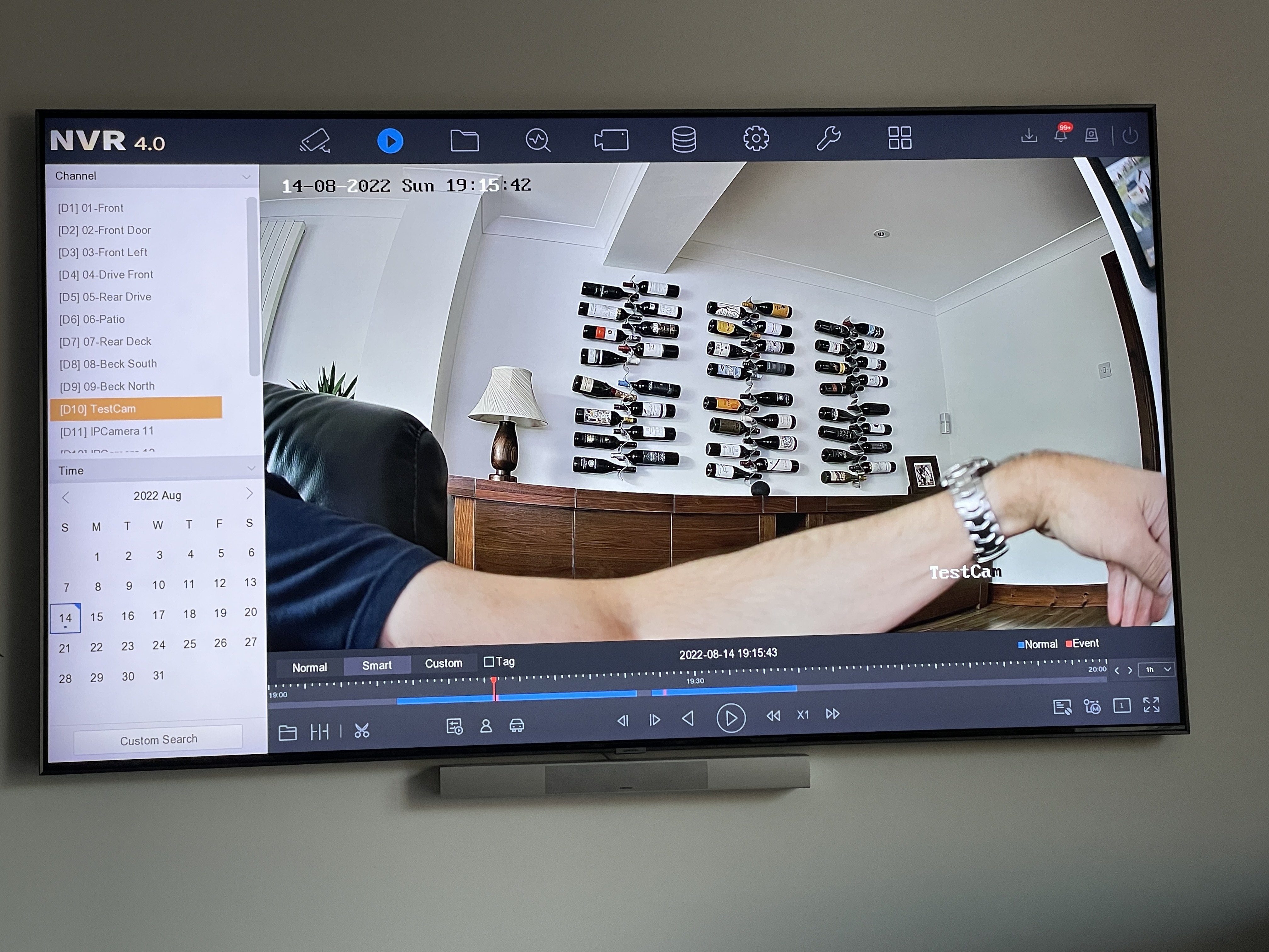

I got the notification through on my phone and can play back the clip etc (the reason you can't do that when connecting the camera directly to Hik-Connect is that it's trying to playback from the SD card, as it's unaware of the NVR). I also get the event markers in the smart playback timeline as shown in the pics below:
The first alarm was sent while the camera had a valid Gateway (192.168.0.1) and DNS (8.8.8.8) for my network. The break in the timeline is where I deleted the Gateway and DNS entries from the camera completely and it rebooted. The next test also worked fine without those entries.
Effectively if the cameras are on the same LAN subnet as the NVR, the only items that need to be set in the camera to add it to the NVR and get the alarms from the camera to go through the NVR to Hik-Connect are IP address and password.
