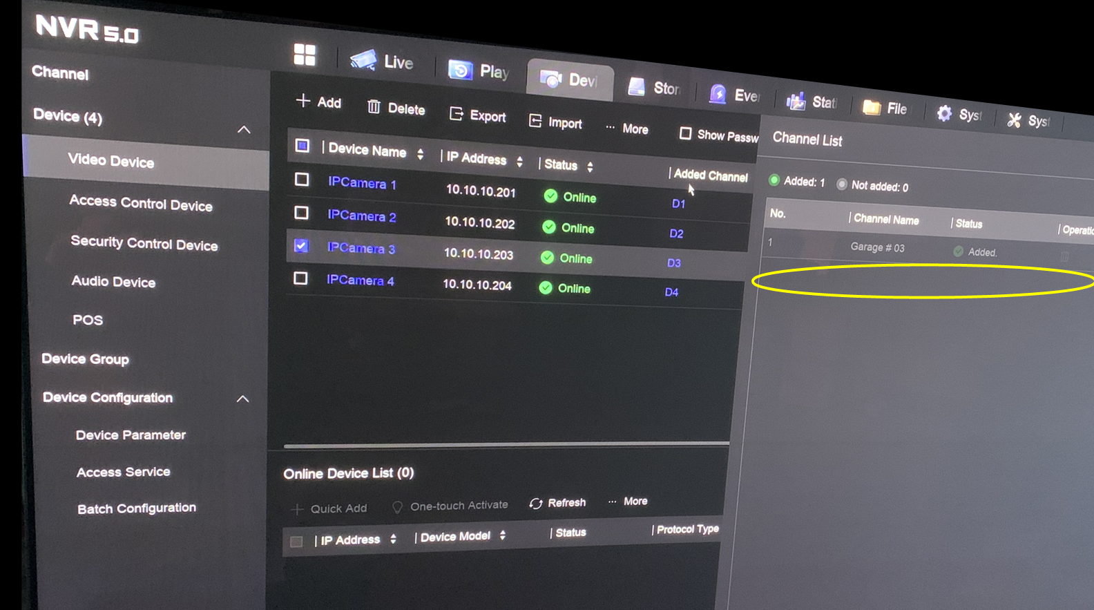

  2. Are you using the WEB UI or the NVR's UI to configure the 2nd channel ? AFAIK, the 2nd channel can not be done via the WEB UI. Use the NVR's UI instead.
  3. Using the NVR's UI.... navigate to Device --> Video Device --> select the IPCamera X, then select the D_ channel. It appears a new Channel List panel should display, allowing you to add a 2nd channel to an unoccupied D_ slot.
  4. See the attached pic where I made a futile attempt to add a 2nd channel to IP Camera 3. Of course, in my case, when I selected D3, D3 does not support a 2nd channel. (actually none of my cameras support a 2nd channel). I suspect a 2nd channel might be displayed in the yellow circled area. In any event, my testing stopped there.

BTW, the NVR UI pic I posted earlier is from my DS-7616NI-M2, Firmware Version V5.04.081 build 260112. Not top tier :) but current firmware on an M Series is all. Cheers!
