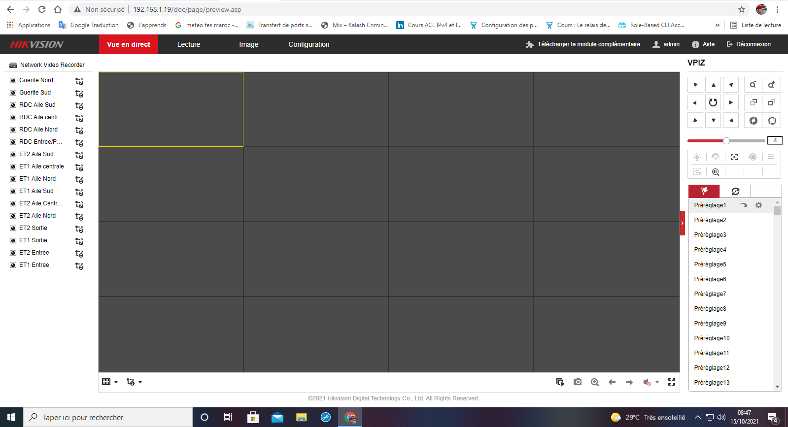

Hello, my problem is that I cannot see videos from the browser yet I have installed the add-on indicated on the interface, there is no problem on the camera, I can see videos from my phone with mobile network. thank you for helping me
