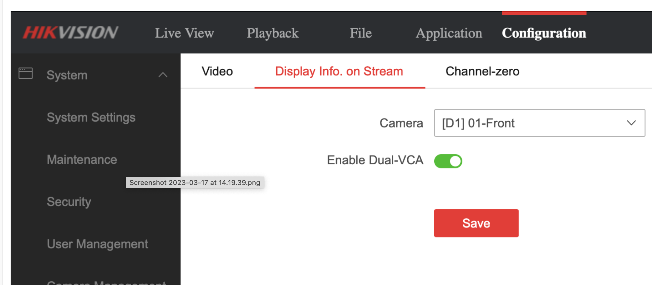

1 - Did you try disabling re enabling VCA on each camera as I suggested in post #12 and again in #14? Reading through the posts it seems you disabled/re enabled "Save Camera VCA Data" which is different. There's an option per camera to enable the VCA data to be sent as I showed back in post #2. "Save Camera VCA Data" controls whether the NVR saves what it receives.

I did disable/enable Dual VCA and left things for a few hours but no result.

You could toggle that dual VCA (which is per camera) on the local monitor or web browser or iVMS - it doesn't matter.

I have toggled the Dual VCA on each camera again and I will give it a few hours before testing.

I toggled "Dual VCA" on each camera again, left it overnight and just tried VCA but no results from any of the three intrusion options when I know that there has been movements.

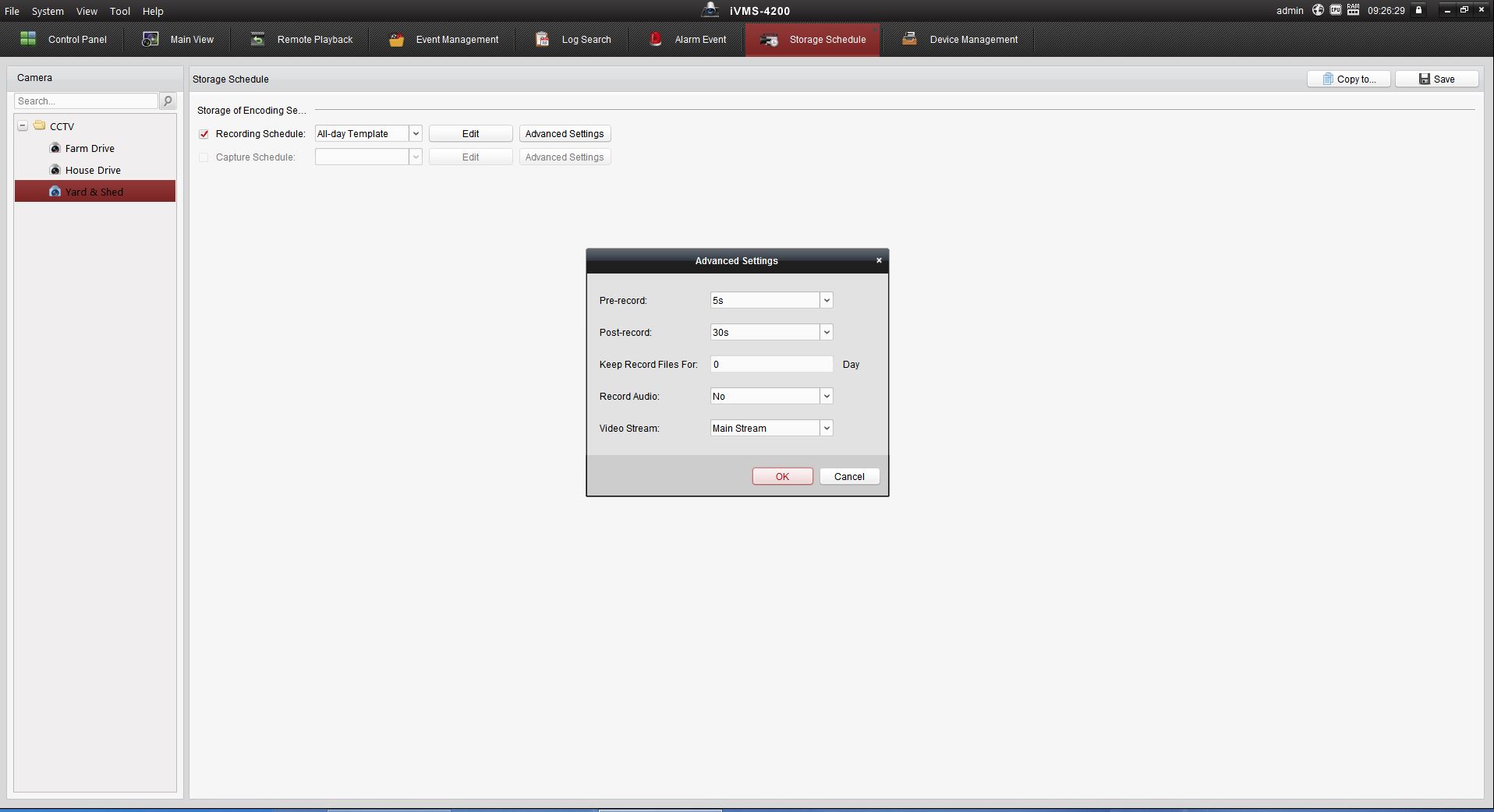

I have just found this on my browser :
It's the "Keep Record Files For 0 Days that doesn't seem right somehow.
0 days is the correct setting. It’ll only overwrite when the disk is full. You only set a value there if you want it to delete after x days.
