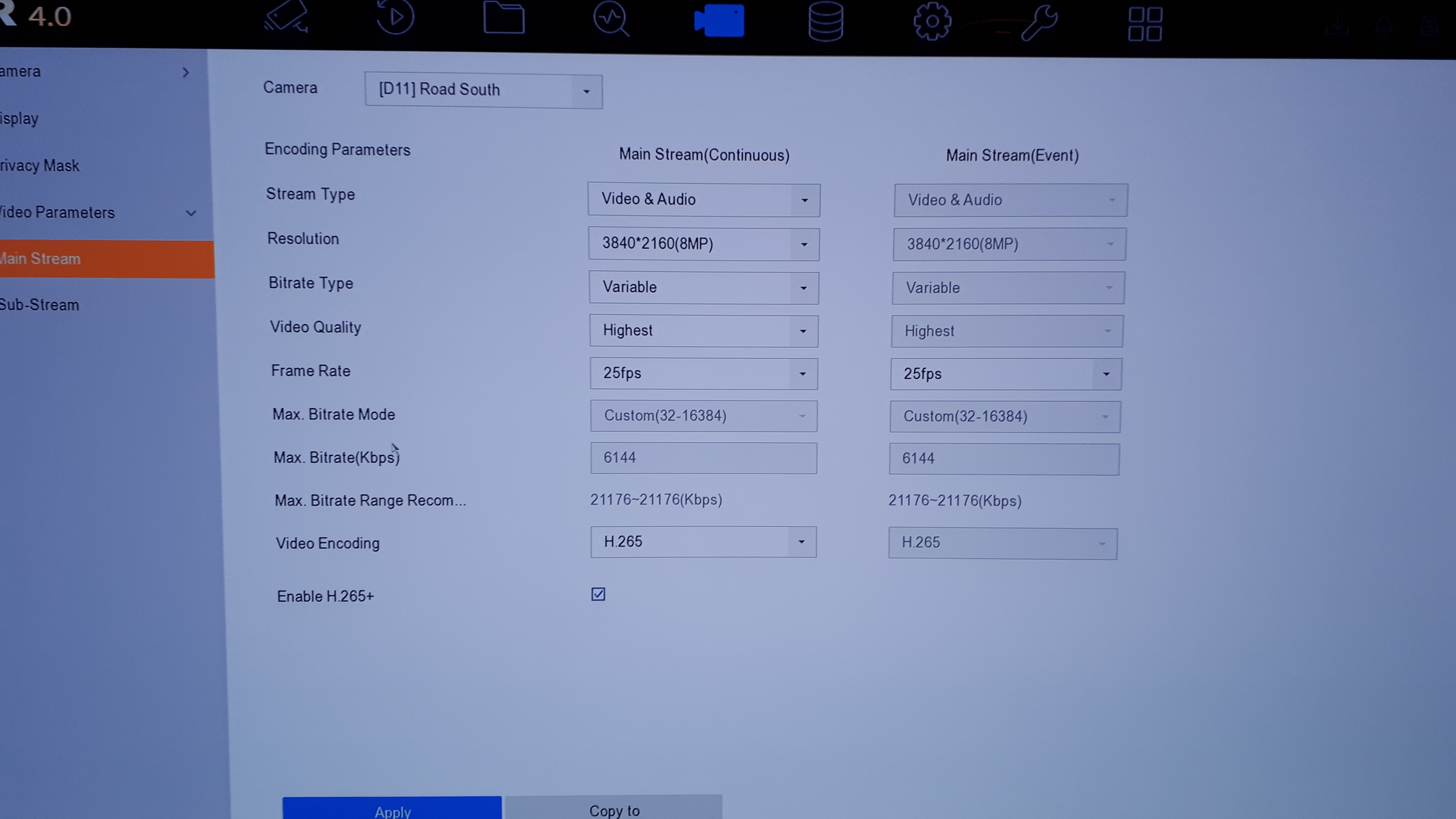

It was definitely occurring on any event that triggered the recorder so I focused on what happens at this point.
At an event trigger (smart or otherwise) the video stream changes commanded I think from the recorder.
If you look at the recorder menu, Cameras, Video Display, there's a main stream and an event stream per camera.
On my system these were slightly different in bit rate and video quality on the new 2387G2 cameras.
The reason for this difference is so that an event can be recorded in higher quality than just the 'observation' main stream at lower quality.
So I made the streams identical in every setting, rebooted the NVR, and suddenly all is well, no flicker on any event trigger.
My NVR is a 7732NI-I4, latest V4.51.025 build 210927 firmware.
The 2387G2 firmware is V5.7.1 build 211009

Yeah that's not the fix in my case. I've always kept the main stream (continuous) and main stream (event) identical since I started installing Hikvision some 7 years ago. It is something that has always caused issues if set differently and at some point a few years ago Hikvision added a warning message to the local GUI if you apply differing settings. The other thing that can cause image stuttering/skipping on event activation is having the pre alarm time left at the default of 5 seconds when recording is set to continuous (in Storage Schedule "Advanced" pop up)

I've settled on different camera settings:
1/60 in NTSC mode
24fps
I frame 48
Highest video quality
Max bitrate 12288kbps, with continuous & event recording at 12288 also.
H265 encoding, Plus OFF
SVS OFF
WDR ON, 10%
NVR record settings for continuous and event identical.
Live images now ok, no lines, no flickering on triggers.
