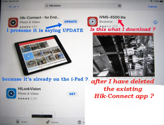

Connecting Hikvision NVR and EE Bright Box1 router.

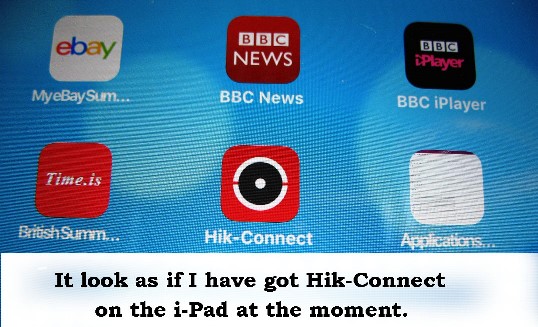

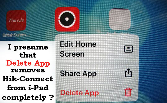

Hopefully this will sort it out for me (famous last words !!) I am on a learning curve with my i-Pad.
Below are 3 images (Image1-3.jpg) Each one with inlaid questions on the image. I hope this way works O.K.
Once you have the app installed, allow any permissions it asks for, enter the region as Europe then uk then:
WITH THE PHONES WIFI ON & CONNECTED TO YOUR WIFI

Thank you but someone is going to have to come and do this for me I think. I deleted the Hik-Connect app. Downloaded the iVMS-4500 app and then it all went wrong. I am trying to get this working on an i-Pad, not an i-Phone. I do not have an i-Phone. I tried to follow the options that you have written above but they are different to what is on my i-Pad. One thing I disliked was the various options to allow Hik-Connect to know where I am and lots of other things, email address, 'phone number, etc.. I will have another attempt later and report back. Thank you again for your efforts, it is clearly my lack of experience with i-Pads that is causing the problem. I really thought it was beginning to come together.
EDIT. I managed to input some of the stuff, region, NVR password, and a few other things but it all went wrong eventually after 3 attempts of deleting the app and downloading it again.
The iPad version used to be different but as long as you're using the iVMS-4500 lite version that you pointed out it should be the same so it doesn't matter whether you are setting it up on an iPad or iPhone. I have an old iPad upstairs - I'll just have a quick check to see how it differs to the iPhone......With regard to what you've said about e mail addresses, phone numbers etc, that's the reason I prefer iVMS-4500 as these are not required.
