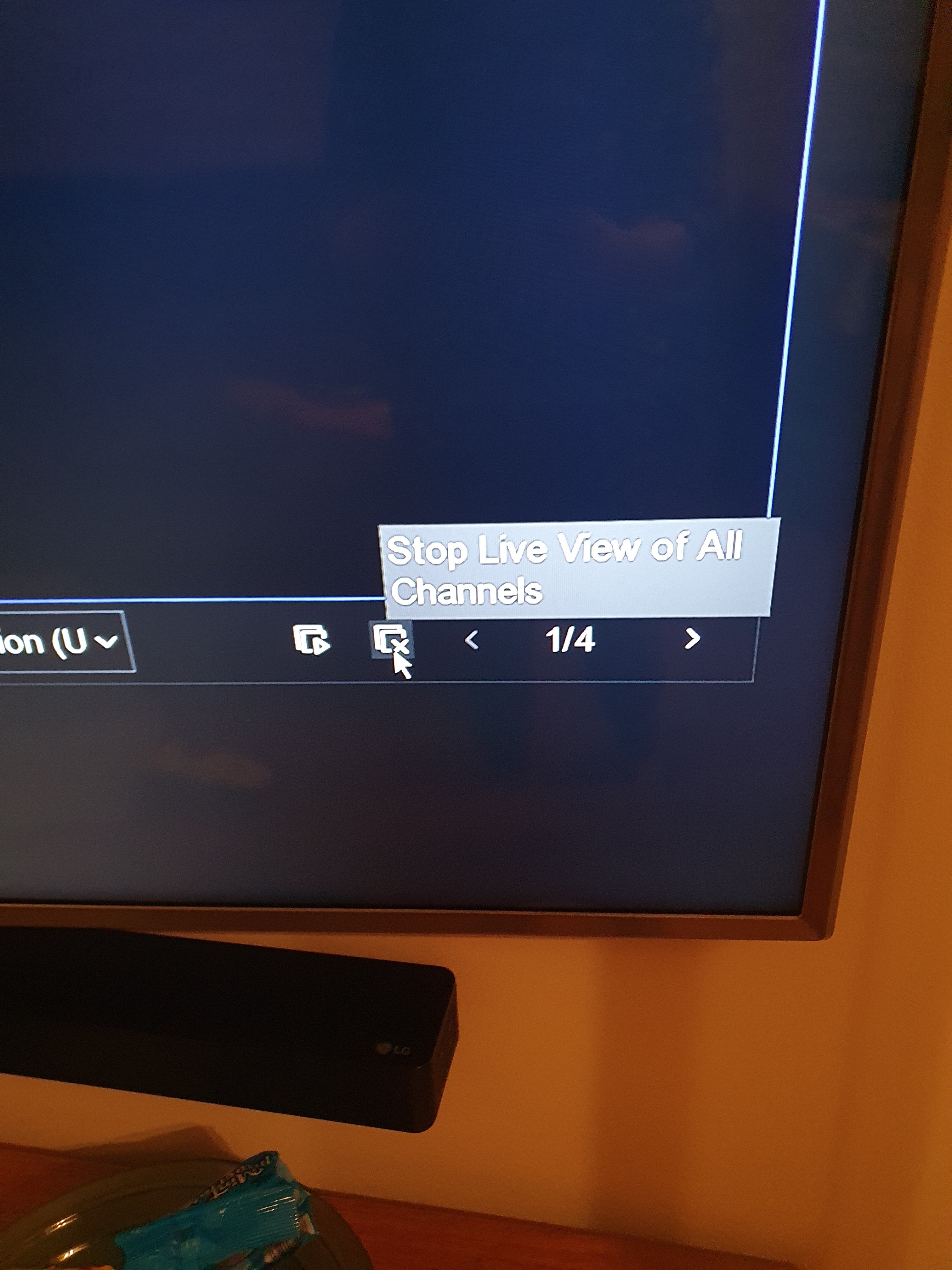

I've done it I must of clicked on this so sorry John thank for your time again

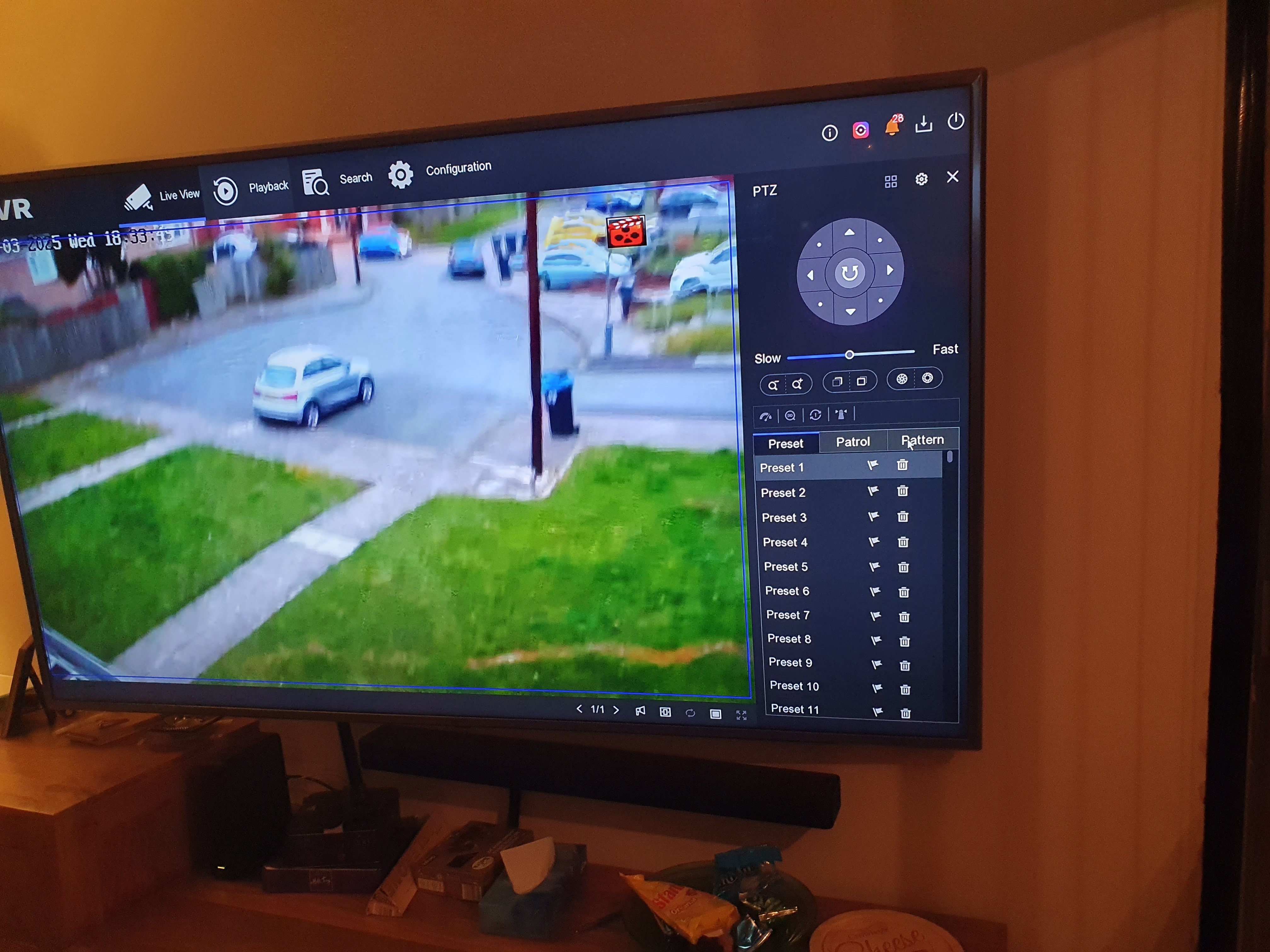

Hmm... it's not too bad if you can still see the cameras on the phone...
First easiest thing to try is rebooting the NVR.
What was the last thing you remember doing before this happened?

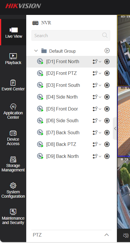

Do you see the cameras if you use your computer and log into the NVR web GUI? like this:
Do you have all these cameras

I waa thinking you had 9 PTZ 's was going to ask if you win the lotto

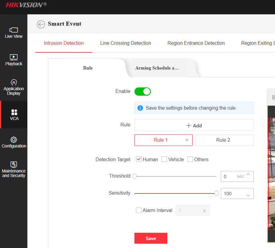

Since you are using an intrusion detection event to start the auto-tracking, you can check the settings you have here on the camera GUI:
Threshold is the number of seconds the camera must see a target before it starts the event... reduce this if it is not already at 0.
Sensitivity is just what is sounds like, increase it if it is not already at 100.

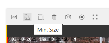

You can also try setting a very small "Min Size" here:

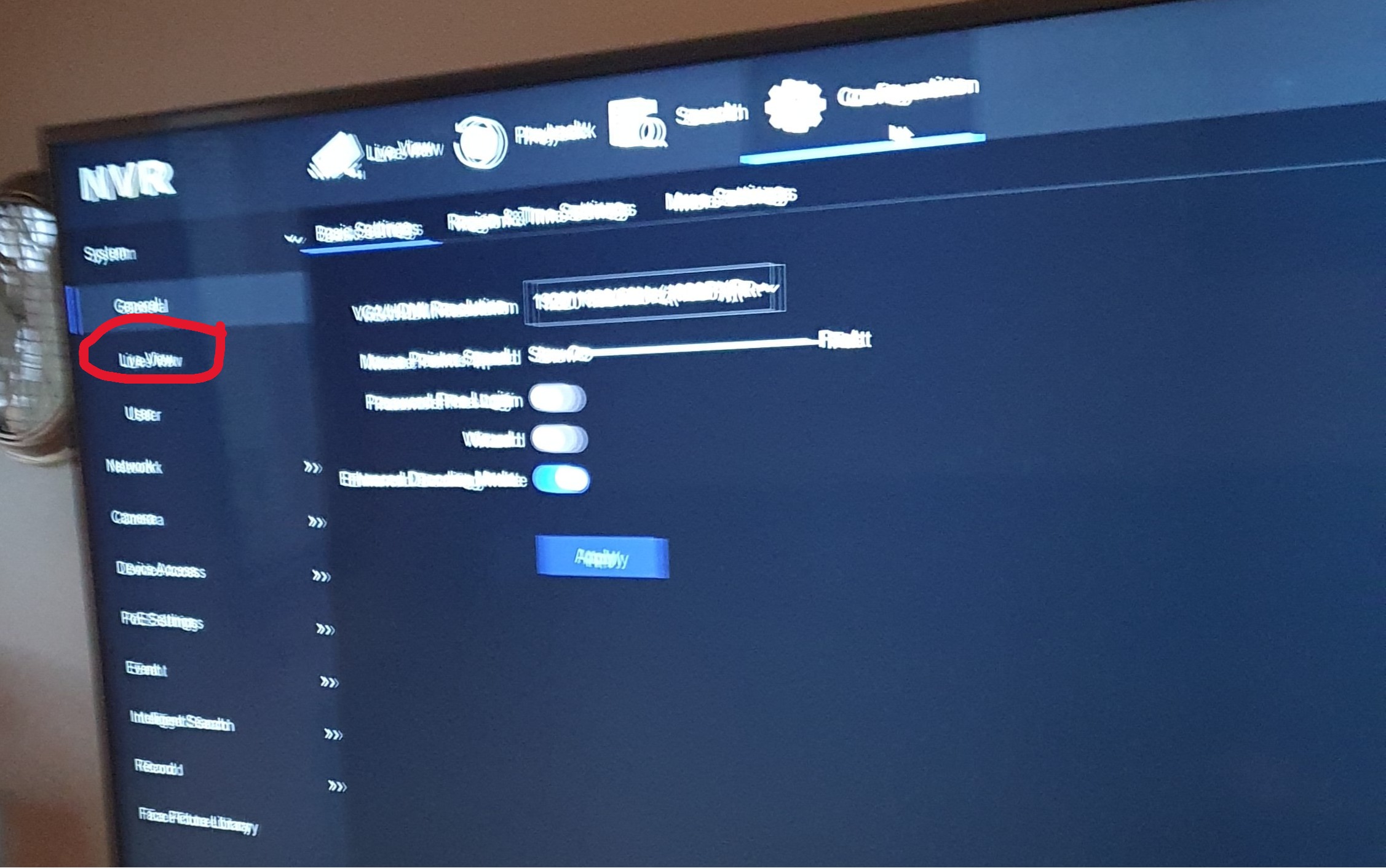

Auto tracking hasn't worked since I changed on tv and tried back on laptop and still no joy.. my hubby not happy with me
Can I restore it back to settings when i changed setting on tv? What I was trying to do make a area that could move to where my neighbour is because she keeps putting things like eccles cakes that can kill my dog. Or can't i make the camera do that it's pointed
