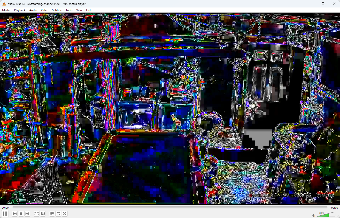

Issue: RTSP streams are consistently corrupted (garbled H.264, audio static), but the NVR's local monitor output and Hik-Connect are both clean.

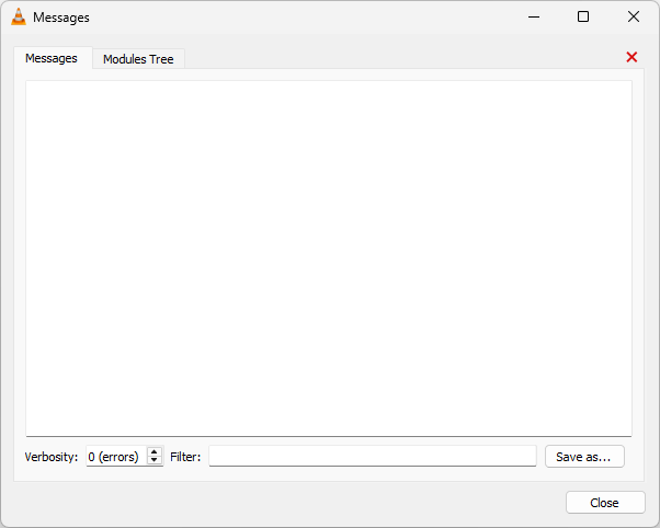

@chitolocz are you streaming over a wired or wireless network?
what do the vlc error logs say? On Mac its window> errors&warnings, window> messages.
David
David
@David Thanks for jumping in.
Desktop is Wi-Fi, but I also tested wired — same corruption.
VLC
ffplay errors: sps_id out of range, non-existing PPS referenced, too many reference frames, no frame!, missing reference picture.
