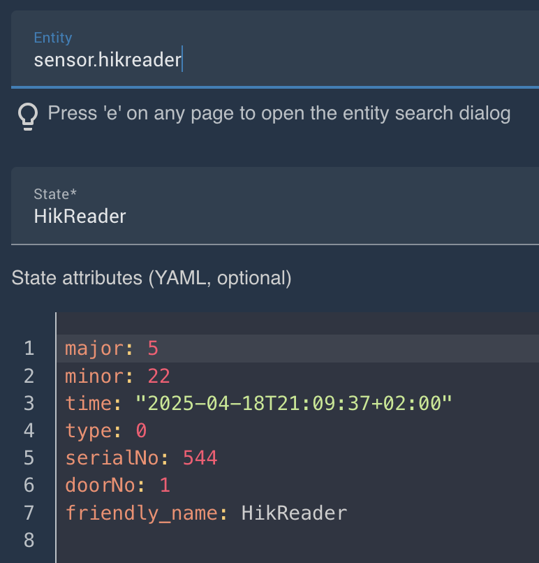

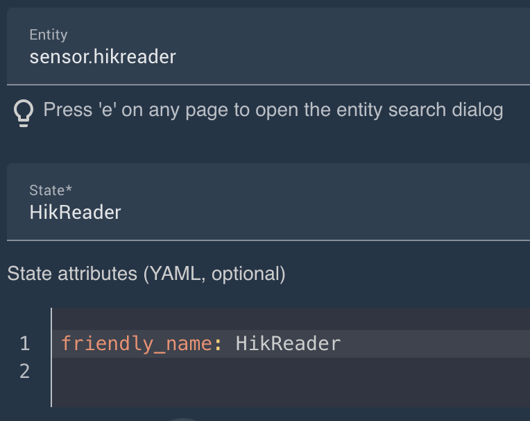

There is not any connectivity problem with the device. Actually, everytime I reload the REST ENTITIES, data is displayed fine. However, after the 10 seconds scan_interval is reached, sensor attributes dissapear. No issues if I reload manually in postman several times:
BEFORE
AFTER
Any clue of what it is happening? If not, next step will be to try to build this with a cURL command instead and parse response accordingly, but I thought this REST route would be "cleaner", as I would have all data as attributes in a single sensor.

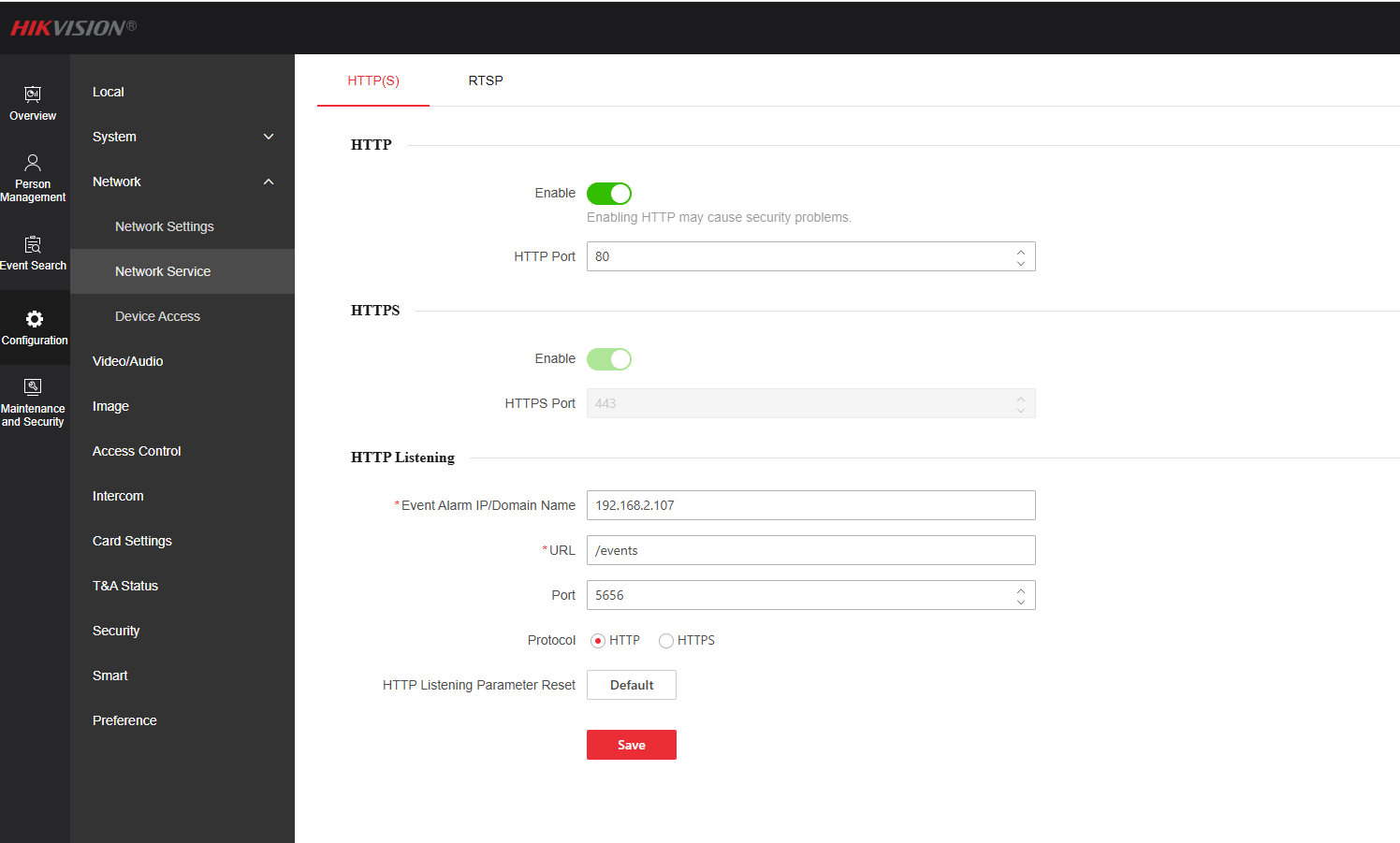

Http listener is best option for real time thats what i use, the crud what i shown you in my project is being used for syncing. For example if HA was off, then on first start will sync events and co tinue off with listener.
That's what I was trying from the beginning:

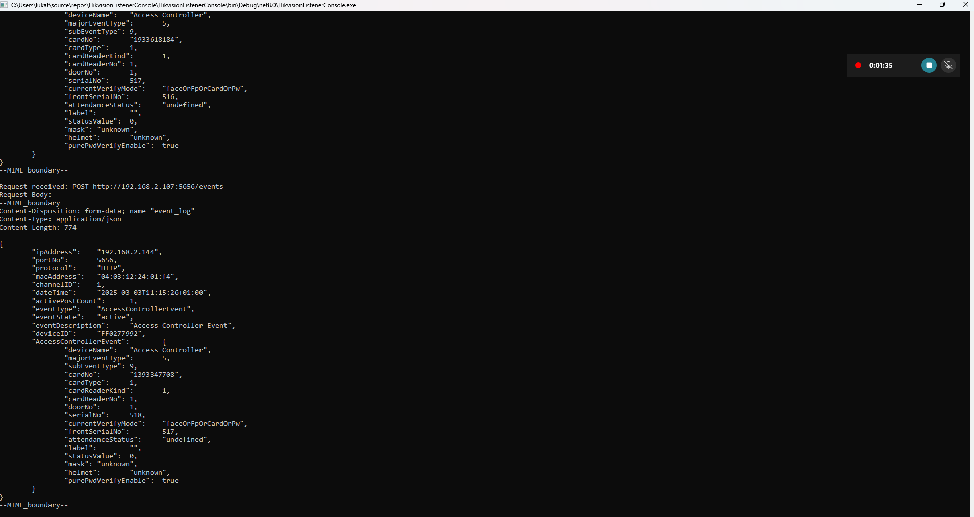

So far, I am trying to fetch Access Control Events through ISAPI/RESTful or through the listening server option. With a software called Network Assistant I can get this kind of heartbeats. However, dateTime is not real and any actual event doesn't seem to be logged there (all events have the same dateTime string:
This is the way I was setting up in the device:
Then I tried to setup an automation with a webhook. But once done, I start to receive triggers every secons
There you go an example:

First listener run will fetch all the past events there are on device. And device will mark them as sent, once u get to present, it will only send realtime data.
