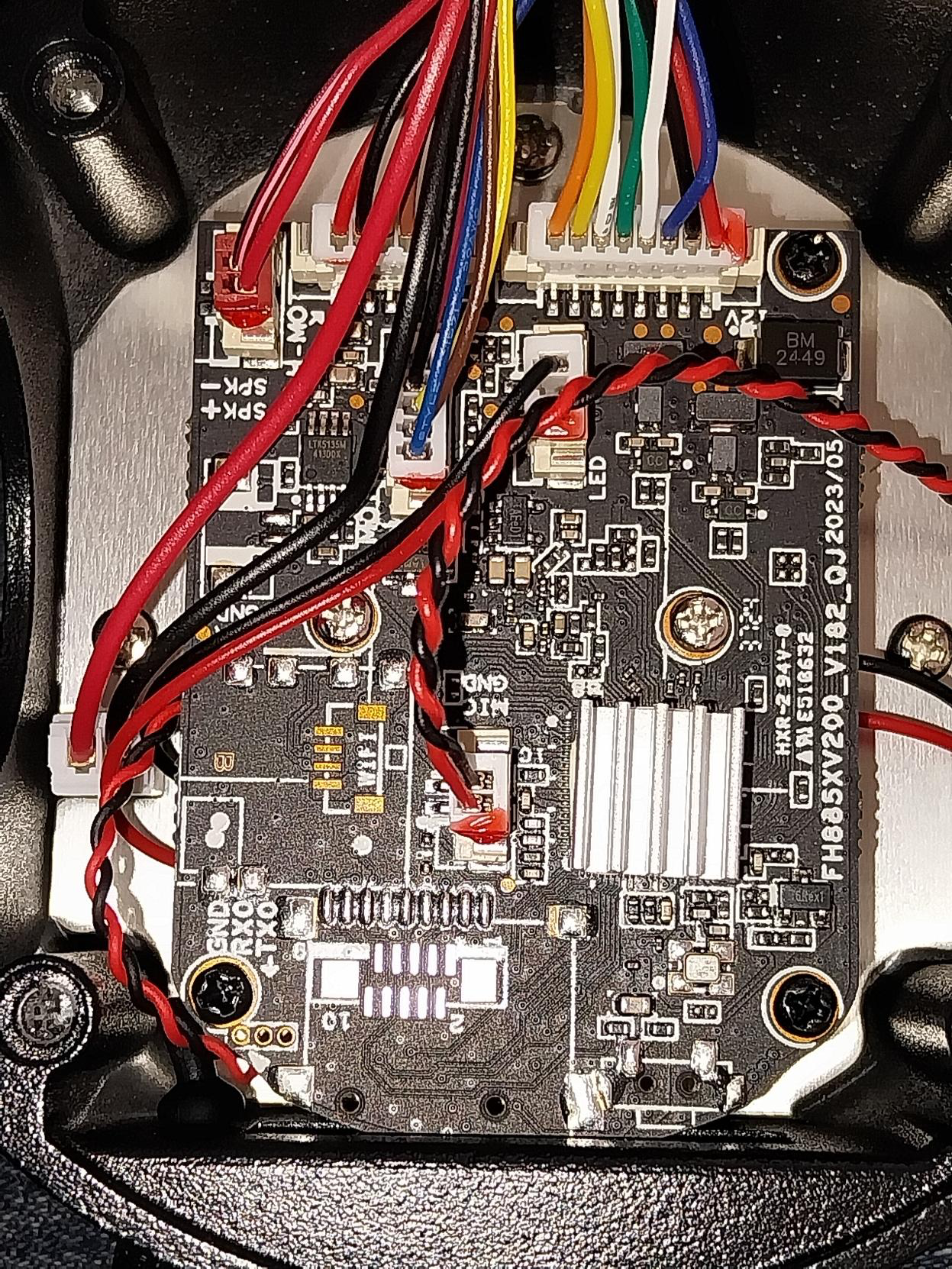

Had an issue getting my new HD908-P hiseeu camara, purchased from Amazon, to work.
Tried all the usual stuff, emailed Hiseeu, (no useful response whatsoever
Obvious thing to do was to reset to factory settings… slight problem…
No reset button on the ‘pigtail’ and both the the SD slot and reset button missing from under the rubber flap.
Eventually decided to open up the camera (4 screws on the back) and look for the circuit board connections for the reset.
Here they are:
Bottom right of the image. The board helpfully shows an impression of the button. Just short whilst powered up and voila! All was OK.
To be clear, these are the two solder points at the top of the upper rectangle. Use a pair of tweezers to make sure nothing else is shorted by mistake.
