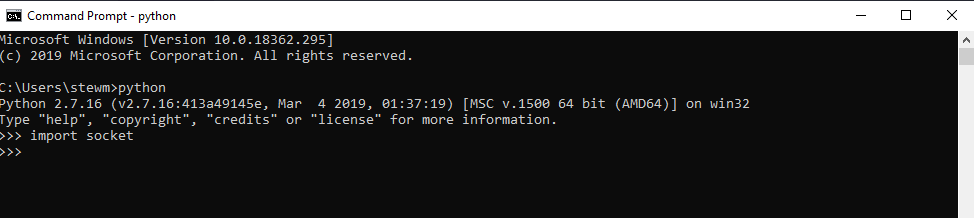

Additionally, please post a screen capture of the response to:
Open a cmd prompt.
Type c:\>python.exe
Type (at the >>):
>> import socket
2592
It's possible the path isn't correctly setup in your environment variables. Any chance you have multiple versions of Python loaded?

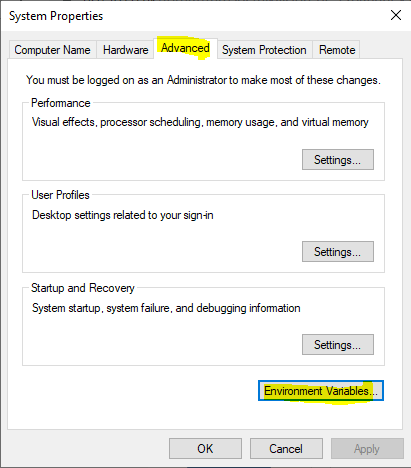

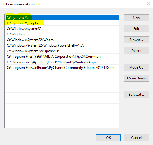

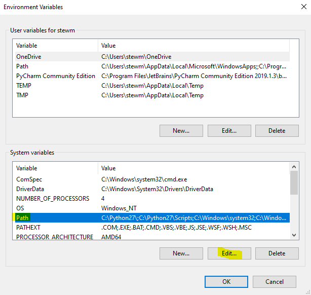

I'm on Win10 so attachments may look a bit different. Instructions below are for Win7:
Select “Computer” from the Start menu
Choose “System Properties” from the menu
Click “Advanced system settings” then click the “Advanced” tab
Click on “Environment Variables”, under “System Variables”, find “Path”, and click on it.
Click “Edit…”, and add the text on the following line to the end of the Path in the box “Variable value”.
Note that there should be no spaces anywhere at all:
;C:\Python27

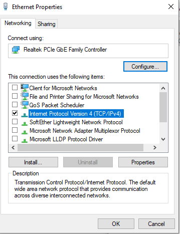

Few long shots to try:
1. Configure the laptop adapter to IP 4 only, nothing else ticked.

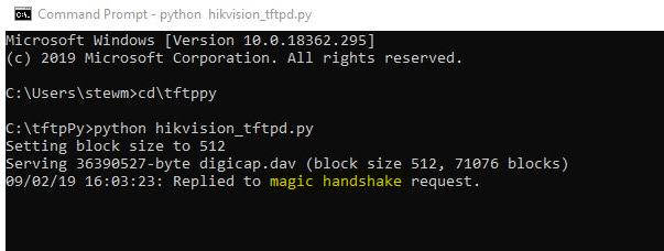

Just to clarify, you haven't received the magic handshake part? Stuck at the line above?
2597
Are you power cycling the DVR when the script waits on 'Serving xxxxx-byte digicap.dav ...'? It won't proceed unless you do.

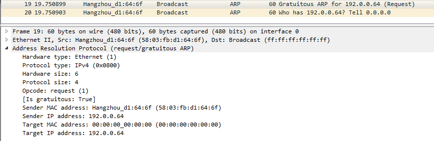

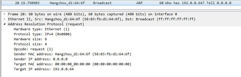

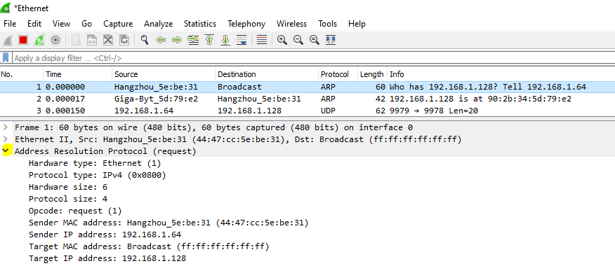

Wireshark is doing an ARP from 192.0.0.64 - the DVR - so nothing else is going to work and must be in the same VLAN segment.
Please send a Wireshark capture. Expand the initial ARP broadcast from the DVR.

Regarding your Wireshark capture. It’s interesting the DVR's ARP broadcast is looking for the TFTP server on 192.0.0.64.
2628
When the DVR is in recovery mode, the IP for the TFTP server is already hard-coded by Hikvision. This might explain why your laptop is not responding to the ARP broadcast.
The DVR’s IP aside for now, please try the following. Let’s see if you can get a response from the laptop's NIC to the ARP broadcast. Set the laptop’s NIC to 192.0.0.64 and edit the script line 171 to reflect the same. With Wireshark in capture mode, run the python script and power-cycle the DVR at the ‘Serving…. ‘ line of the script. Please post the screen capture from Wireshark as you did before.
