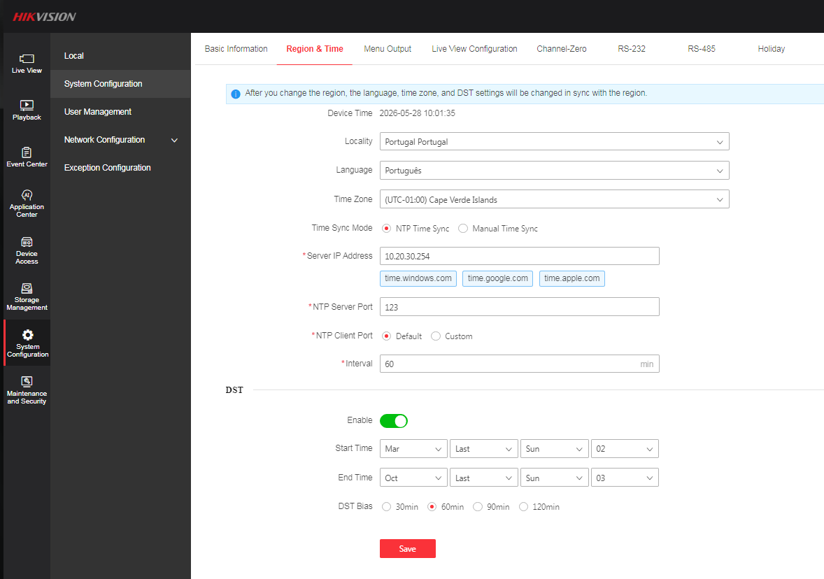

Attached is a pic from my DS-7616-M2 showing my NVR time sync'd to a "local" time server on my network. You might post a similar screenshot from your NVR & cameras, if you've struggling on how to set up NTP.
FWIW, HIK’s clocks are notorious for drifting a lot, so don’t expect them to keep accurate time without configuring NTP.

After reading your reply, it reinforced what I’d already been thinking, that it was likely a time issue. This morning, after reading your post and seeing that the system had been recording continuously on both channels since yesterday, I noticed the free space on the HDD had reduced by 103 GB. That confirmed something was definitely being recorded, which then made me wonder whether the problem was actually with playback.
That brought me back to your suggestion about the time settings. I matched the NTP settings to yours, and then… BANG… it hit me. I noticed I had the wrong calendar month selected, completely forgetting we were still in month 7.
The frustrating part is that I must have looked at that date 20 or 30 times yesterday during the 4–5 hours I spent trying to get the system recording again. It’s a perfect example of confirmation bias, I became so convinced the fault had to be something technical that I completely overlooked the obvious.
Thanks to your advice, I stopped digging deeper and found the real problem. Without your reply, I’d probably have spent several more hours today chasing faults that simply weren’t there.
