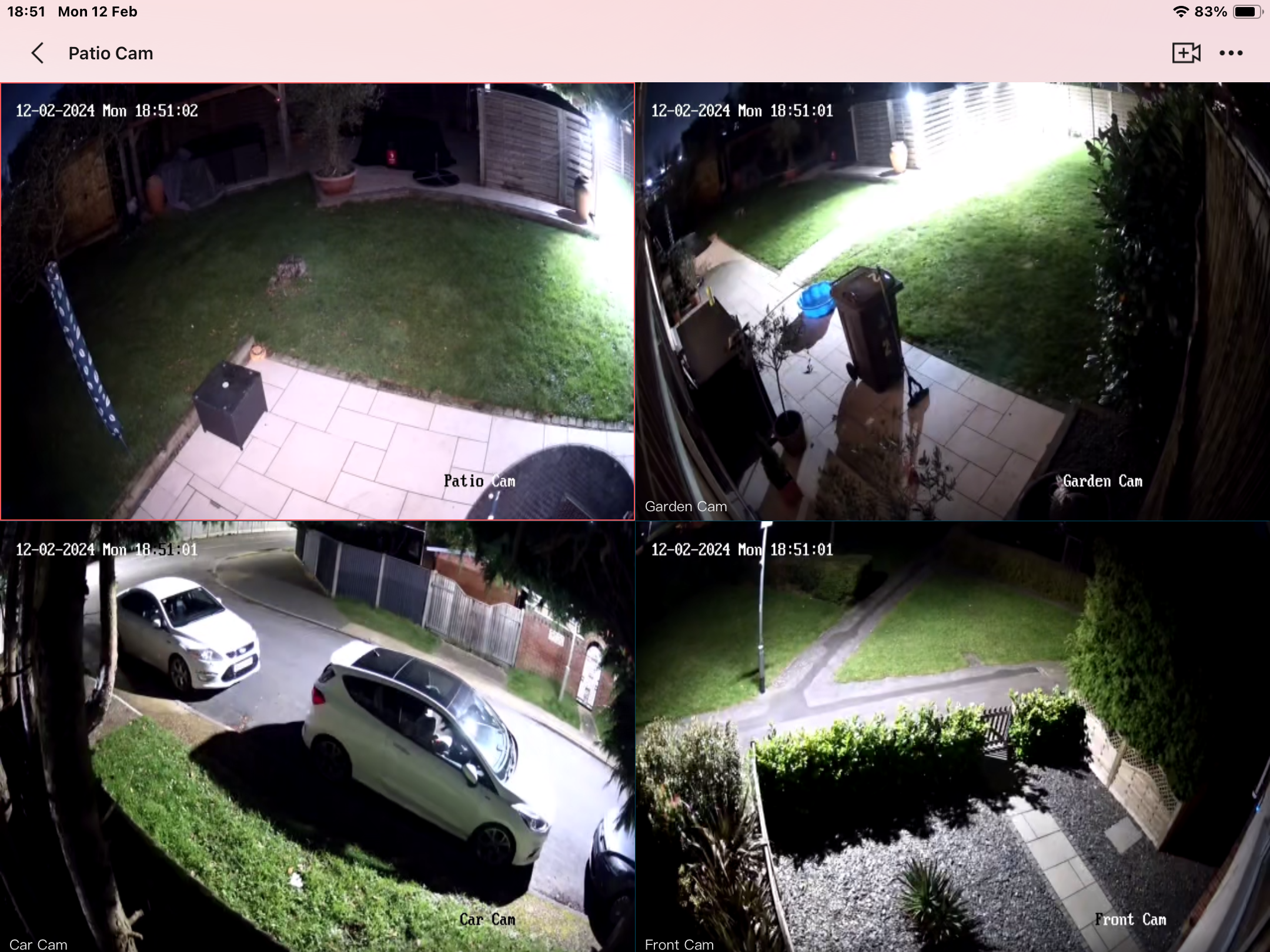

Excuse the untidiness, been out clearing some wind debris and run out of time…..the Volvo FH is calling…..have a good evening gents
