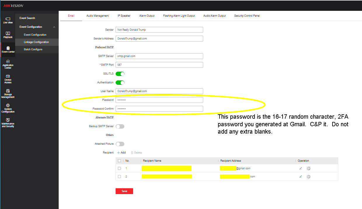

For some added completeness , here's the Email config page from NVR Firmware Version V5.04.020 build 241106
Unfortunately not. I think it's the making application specific passwords that I must be making mistakes with.
