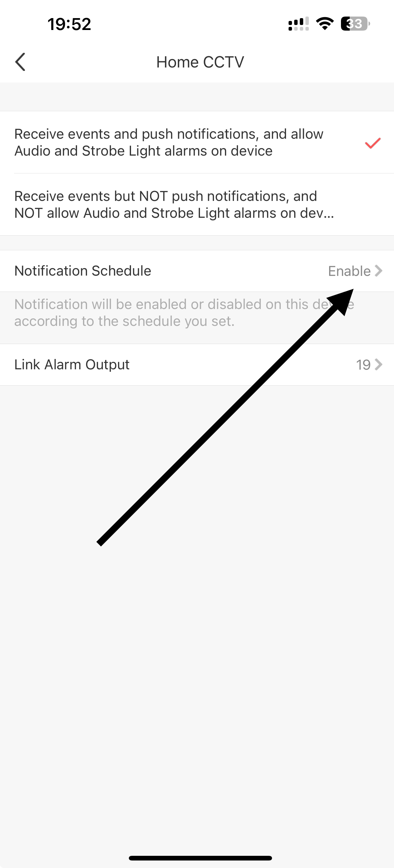

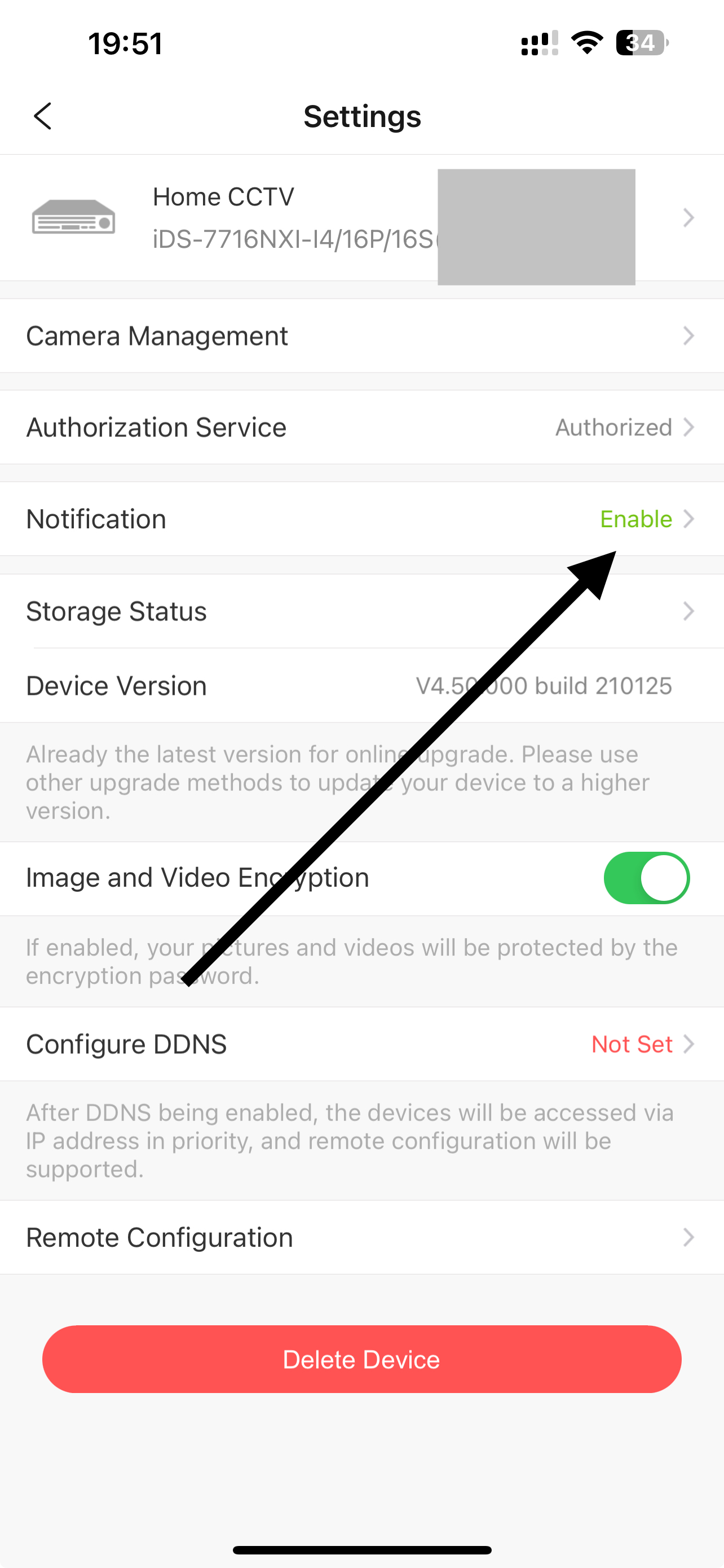

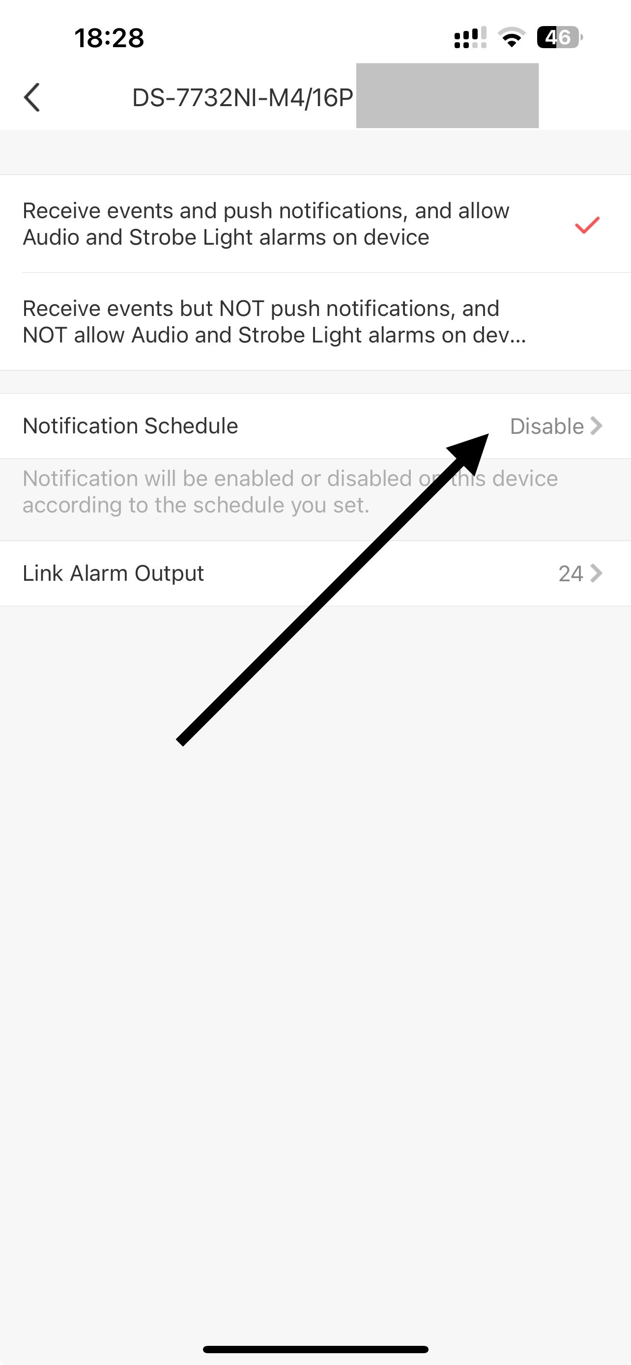

This is the unit it’s replacing,
1. first picture it’s enabled like the new (problematic unit)
2. This second picture is enabled and it always stays enabled, where as the M series turns back to disabled as soon as you leave the page.
3. Third picture, both units look like this, so further confusing.

So strange, I don't seem to have settings for a notification schedule on mine... I thought I have seen that, but I must have been confusing it with the EZ-Viz app I also use.
Maybe our settings are different because we have different M-Series NVR's?

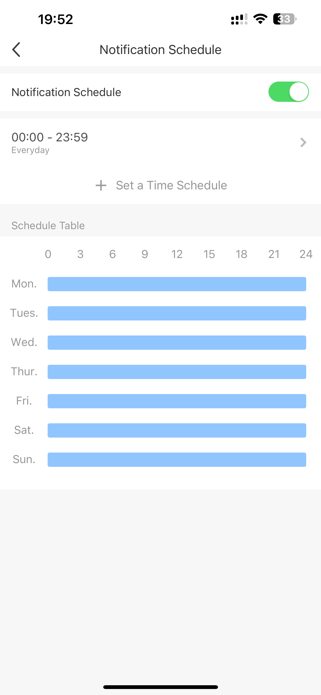

I must be missing something here but what you’ve shown is just saying that the schedule is disabled, not notifications. I’ve known users mess with the schedule and get no notifications as they end up with a schedule of ‘never’ then enable it (easy to do)
