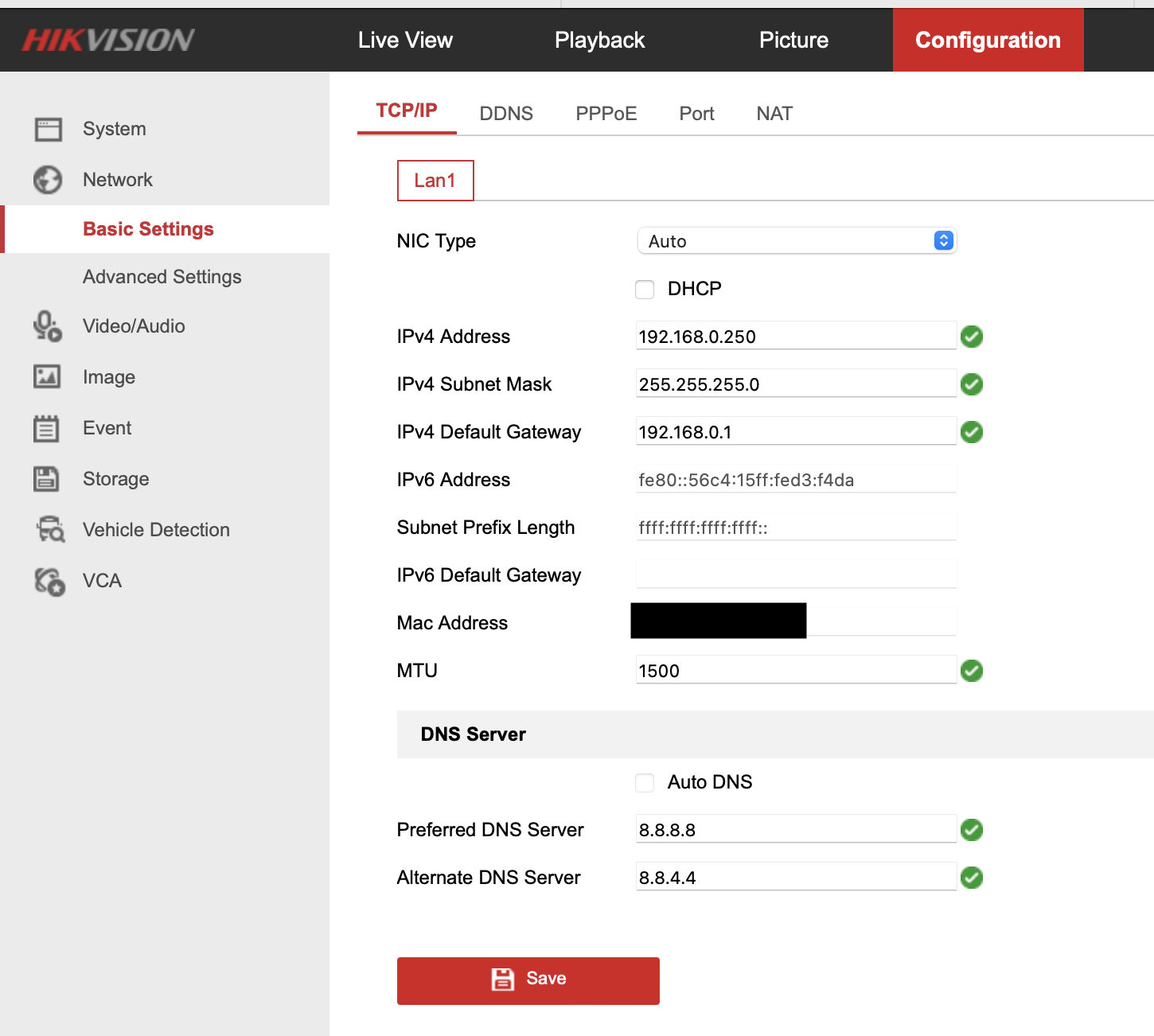

As detailed previously, you need to set not only the IPV4 address correctly in the NVR but also the gateway, DNS servers etc. You have successfully altered your IP address on the NVR so that you can now access the NVR while on your local network. However you must change the gateway address in the NVR to 192.168.1.254. That is the default address of the PlusNet router (if you type 192.168.1.254 into a web browser you should get the login page for the router settings).
You mentioned in a previous post that the gateway and DNS settings were blank. You need to click in the blank boxes and fill in the details that I previously posted. Click in the left hand empty entry for the gateway and the on screen keyboard should pop up allowing you to enter the details. If you're struggling to do that with the menu on the NVR, now that you can access the NVR from a web browser you can just access the same menu from your Mac with Safari browser once you've logged in. I've shown the page in the screenshot below (ignore the settings shown and enter the ones I gave you previously):

1 - So although they are uneditable directly on the NVR, you DID manage to already change the IP address. You should therefore be able to edit those fields by connecting to it using the browser (as you did before when you accidentally copied the wrong ones in) - so try that first.

I can access my NVR in Safari browser and fields are editable.
