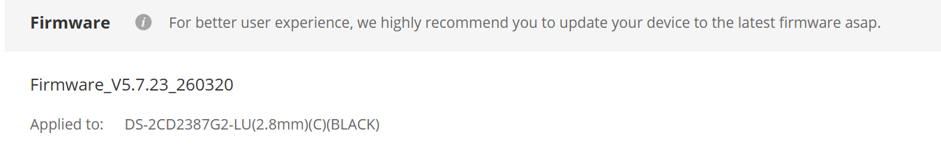

I just noticed a newer firmware release for G5 cameras is available... same version number, just a newer release date...
As usual, no release notes. :(
https://www.hikvision.com/en/products/IP-Products/Network-Cameras/Pro-Series-EasyIP-/ds-2cd2387g2-l-u-/?subName=DS-2CD2387G2-LU+(C)+(Black)
Edit: Loaded it on my cameras, don't see anything different... nothing broke. :)
