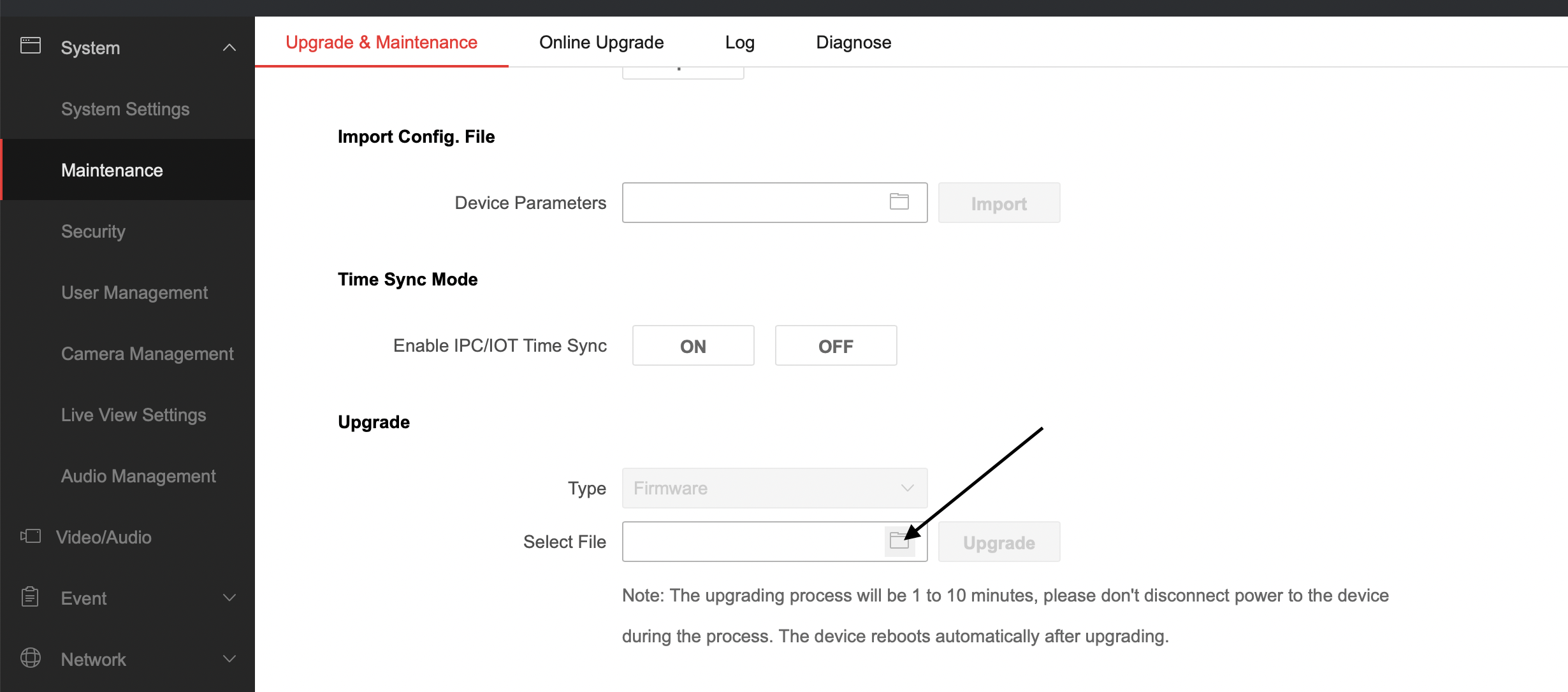

I have a DS-7616NI-I2 /16P on V4.60.005 build 220108. Been faultless for a couple of years. I update the firmware every now and then, this morning I noticed there's V4.61.000_220527 on the global site.
I downloaded it, unzipped, but can't upgrade. The manual upgrade field in the basic settings tab is greyed out. I can't select the upgrade file. It's never happened before.
I'm using MS edge so I'm assuming it open a Edge window to display the basic settings.
Any Ideas on what's go wrong?
Thanks Dave

It is greyed out but are you maybe clicking 'upgrade' before clicking the selection icon to first browse to the file?
Yes that's how I tried, however that box should bring up explorer so one can search for the file no?
I'm not getting that box. It's like the link address is wrong or permissions are stopping it from opening.
I'm unable to populate that field with the file address rather than click the file opening icon. It's like the whole field is disabled.
I also noticed "Import Config. File" box field is the same. Can't bring up explorer via the search folder icon or populate the box with the address.
Got me stumped.
Ok sorted it,
Reinstalled "Localservicecomponents" and it then worked as expected.
I was about to suggest that...I had a bit of bother the other day with a new laptop (MacBook) until I installed the Localservicecomponents, webvideoplugin and also the Mac version. Until I realised I ended up just using iVMS-4200 - importing each camera/DVR and carrying out the update from there. That's the workaround as everything that is needed is contained within the software so no need to install anything in the browser.
Funny you mention installing ivms4200. I reinstalled it to try and sort this out but that didn't work.
I didn't install localservicecomponents from the exe. I was in editing my admin user and saw a tab I haven't seen before. Clicked on that and it executed localservicecomponents. It's now disappeared. Whish I could remember so I can let others know but it wasn't named localservicecomponents.
Pays to fish around.
