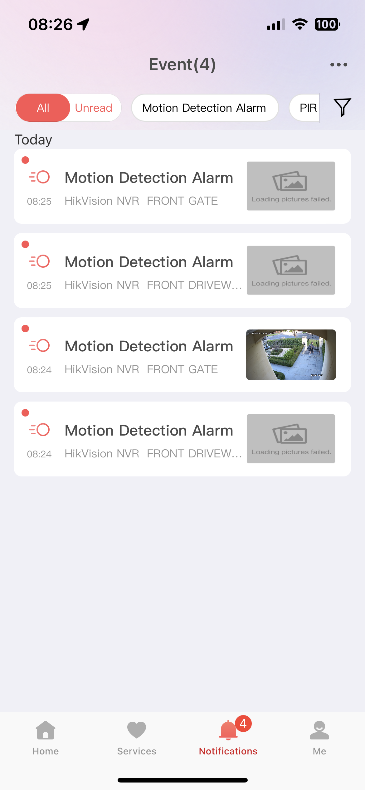

Whether my iPhone is connected to the same network as the NVR (with WIFI) or is connected to a different network (with 5G), I get the same result. Interestingly, sometimes 1 image appears but the others don’t per attached photo. I’ve got the latest firmware installed on my M series NVR and all G5 cameras.

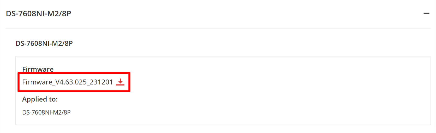

UPDATE - This issue has now been fixed in the latest V4.63.025 build 231201 firmware, which we have tested.
The new firmware can be downloaded here by searching for your M-Series NVR model:

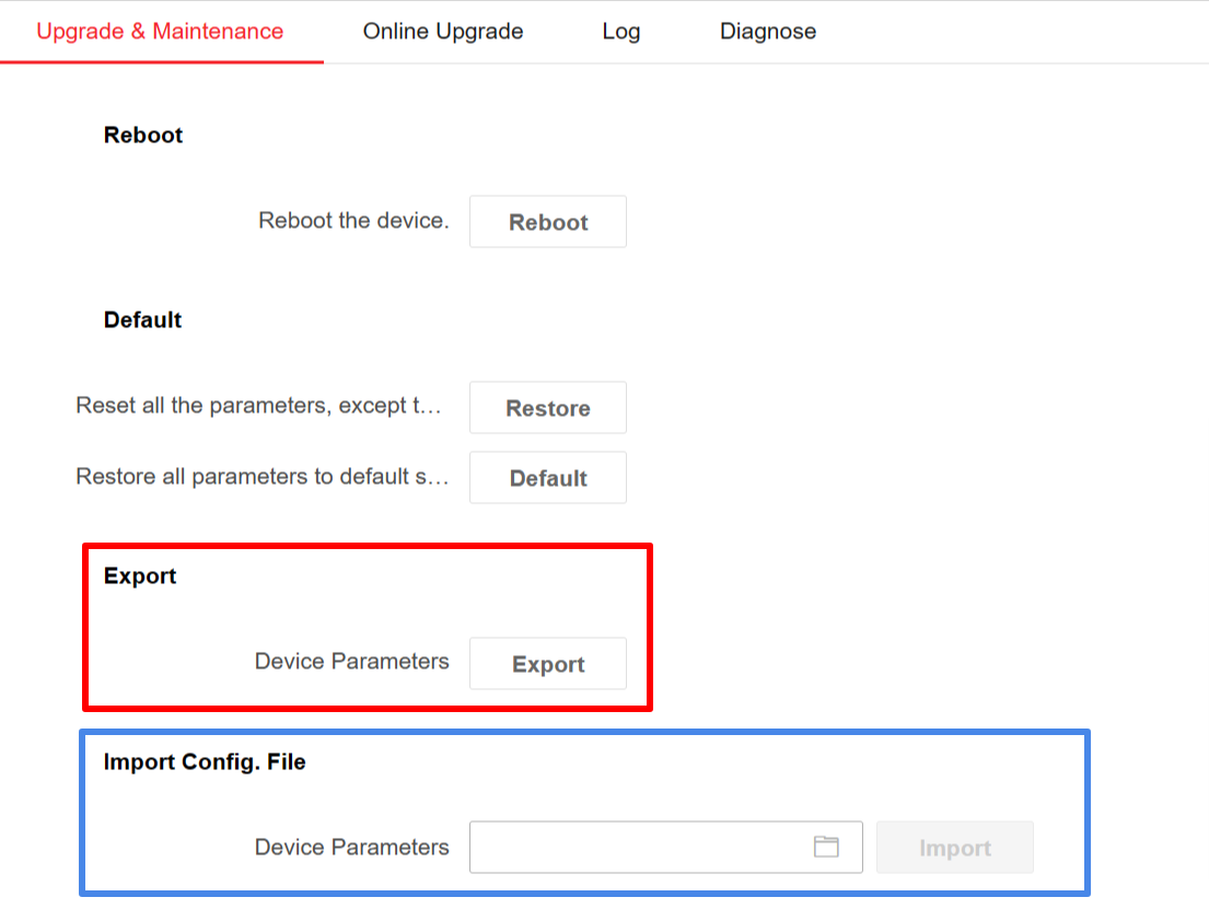

We were also able to roll back to an earlier version from this one, but doing so hard-reset the NVR.
So, I would recommend backing up any important footage and exporting the configuration file with your NVR settings in Configuration→System→Maintenance→Upgrade & Maintenance→Export Device Parameters - you can then load this back onto the NVR to retrieve all of the previous settings if they are lost:
