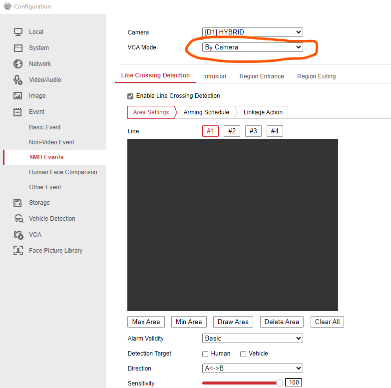

You performed the right procedure.
I don't know if delete is possible. Maybe power off camera, then delete offline camera, power off NVR.
Below is where is my selection for VCA By Camera or VCA by NVR

Hi @alfacivi you must have a different NVR as I don't have the 'SMD Events' sub-section under the 'Event' tab.

Hi @Ianc
Yes this is different. Mine is an Accusense K series
If your NVR is an M series then the similar setting is AI by NVR enable or disable.

About markers, if you mean the green rectancles when viewing image on browser live view, then in camera settings, Local tab, you must enable Display Rules Information.
On NVR there must be a button to enable disable for live view. On iVMS4200 settings you must Enable VCA rule, Enable Highlight and Display Target's Pattern
