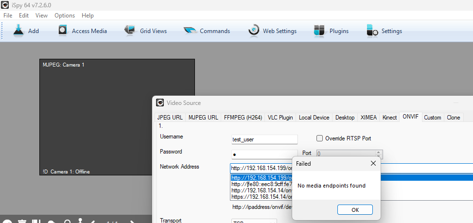

I tried with the wrong ONVIF user password for the camera and got:
I think you should confirm/change the ONVIF password on the camera again...

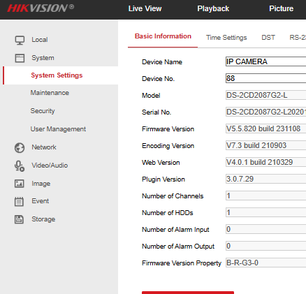

Just wondering how old your firmware versions are?

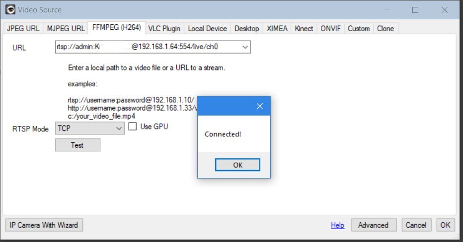

I do have it working with the FFMPEG tab with rtsp:// but lost use of my PTZ presets.
Not sure if its the 'user pass' or http:// stream? im really not sure how iSpy connects with streams??

So looks like your firmware is newer than mine.

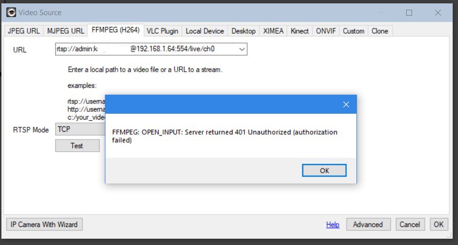

I think the 'user pass' can be ruled out as putting in a wrong password in pic below stops it working with FFMPEG tab.

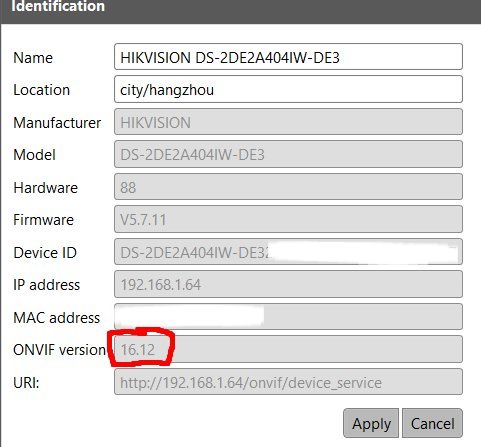

For some reason onvif versions are showing as being different from hik config to ODM??
I agree
If it is something to do with ONVIF versions, maybe downgrading to the older camera firmware might work? I'm starting to think it's because it's an older version of iSpy you are using along with the newer camera firmware... maybe try a new version... I see there is V7.0.9?
In any case, you have it working in ODM so it's definitely an issue specific to iSpy... on the other hand, it worked for me and my camera is running the same v18.2 ONVIF? uggh... we need an iSpy user/expert!

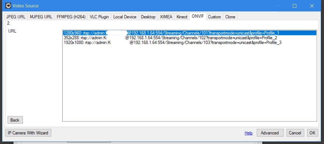

Something in that new firmware has changed and iSpy can't see/ use the http:// url?
When iSpy can see the http:// url it then shows the available streams, as rtsp:// url's like in pic below.
(ODM can still see both url's & use them? but iSpy can't) Local ODM still has its problem??

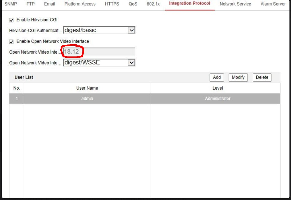

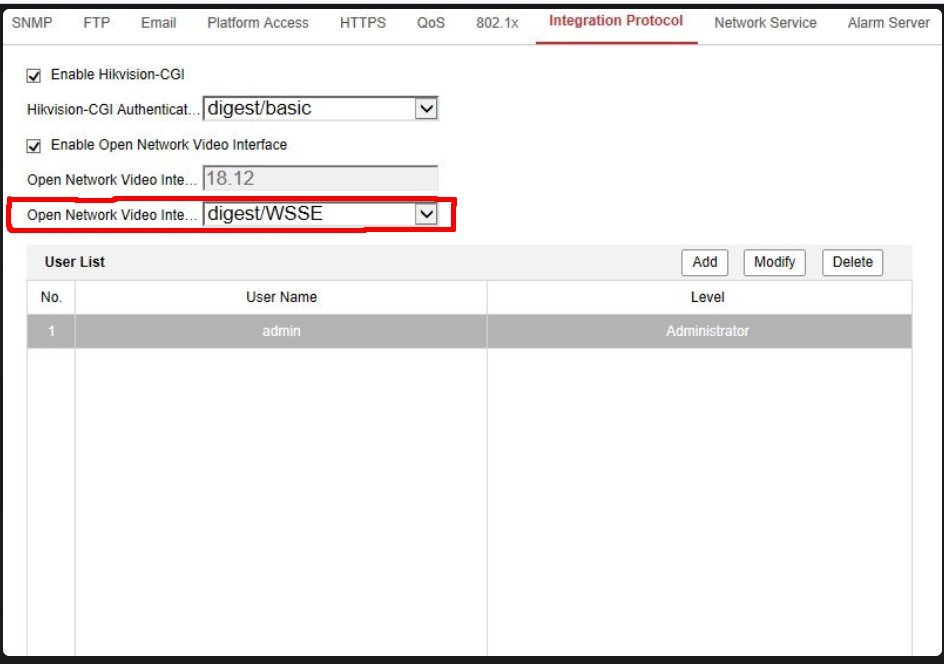

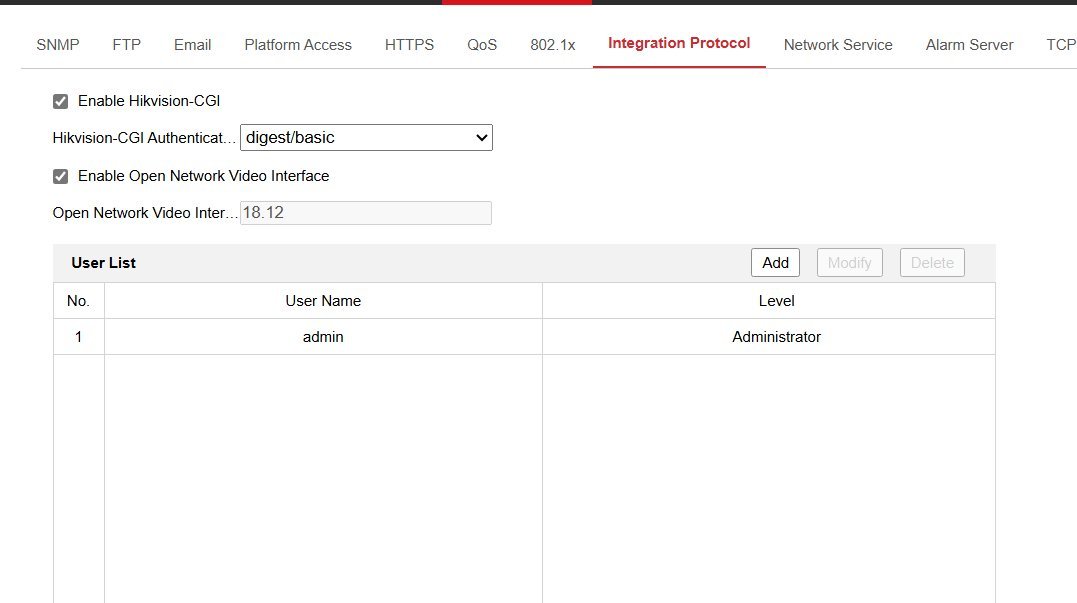

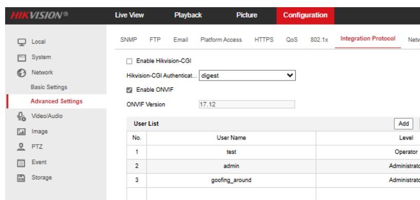

There is something new in the 'Integration Protocol' tab on the new firmware, that is in pic below.
Your 'Integration Protocol' looks more like my older version.
So maybe its something related to the new line in settings?? (marked red in the pic)
