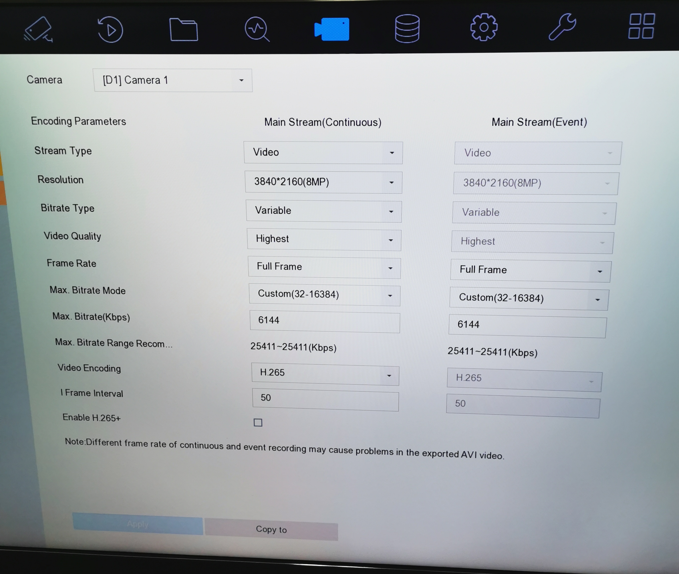

Videos settings on DS-2CD2087G2-L(U) camera?
Add video streams edited. The only thing I could not do was on the Sub-Stream and that was to set the Video Quality to 'Medium', as if the Bit Rate is set to Constant that can't be changed.
Question: Ref the Main Stream can the video Quality not be changed to 'Highest' to get the best feed?
Testing - Hmm I had to the iframe back to 15 it to play back in VLC. If I went higher I only got audio playing back.

You can put it on highest - whether there’s a discernible difference or not is another matter. It will push up the actual bit rate more when it busts. Another thing I noticed in your camera settings that will cause the bit rate to burst way over what you’ve set is the Clear Fluent slider. Having it at 1 (which is something I always used to do) will cause large bit rate spikes when each I frame is transmitted. It would better closer to the default of 50. If you have a monitor/TV hooked up to the NVR, you can bring an image up full screen and there’s an icon at the bottom of the image that will show the stream parameters, live, while you hover over it. I find that helpful to see exactly what effect, quality and other settings have on the bit rate.
Right understood, now on highest and Clear Fluent slider is set at 50 ...... :)
The NVR is upstairs in the wife's office so I'll play when I get the chance :)
Thanks for the info (again) :)
@JB1970
Are my settings good?
Use it with 2 cameras
DS-2CD2T87G2-L
DS-2CD2683G2-IZS
NVR=DS-7608NXI-I2/8P/S
Harddisk=6TB
In the future I will supply 2 or 3 cameras model DS-2CD2T87G2-L, Will it work normally NVR, with these settings?
