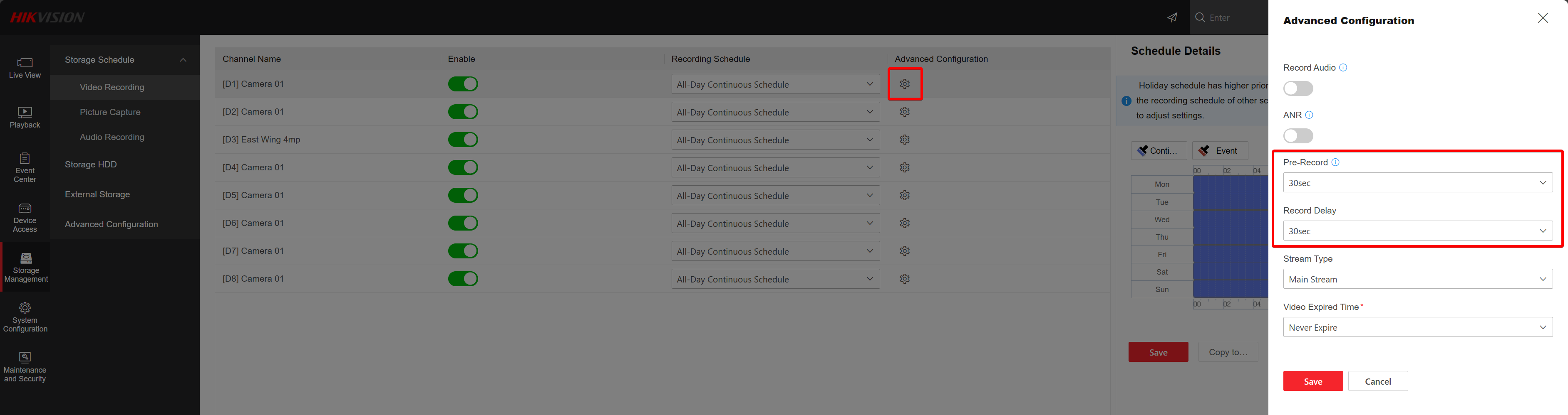

For pre/post playback, it looks like these settings are now in Storage Management > Storage Schedule > Video Recording > Advanced Configuration (for each channel):
I haven't tested whether these work as they should yet, but there is a 5 second option for both...
I missed that as I was looking around in the local UI. Pre event has had issues on and off across other models. It was working where if you were recording 24/7, but set the pre event to 5 seconds that smart playback, event playback and the Hik-Connect clip playback would honour that setting (so that you got to see that many seconds of playback before the moment of trigger). Now it just snaps straight to the trigger during playback which isn't much use as the Human target is already half way across the field of view.
