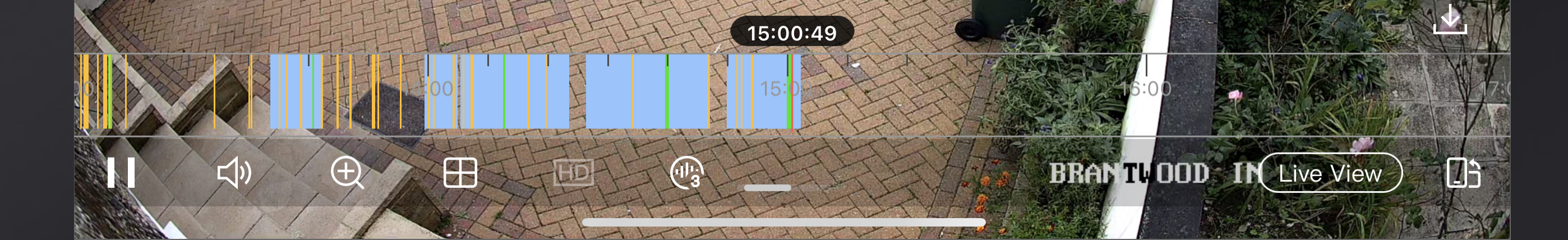

Another odd thing that I’ve just seen this morning when using the Hik-Connect app to view the cameras live - since all firmware updates have been installed on NVR, there is a pop up on each camera screen that says “Armed” and when I go into “Playbsck” on each camera, it seems that it is only recording motion/event clips and allows you to click on All, Event, Human, Vehicle playback events which is new and it is not recording any Continuous recording. See screenshots attached which is quite odd now.

The filtered playback is also new and only available on some models with new firmware. Clicking 'All' should show a solid blue bar if it is recording 24/7 (with green markers showing the events) Clicking 'Human' removes the normal recording to just show the AcuSense events and will play them all continuously (manually dragging the timeline then letting go will skip to the next event after the time you drag to)

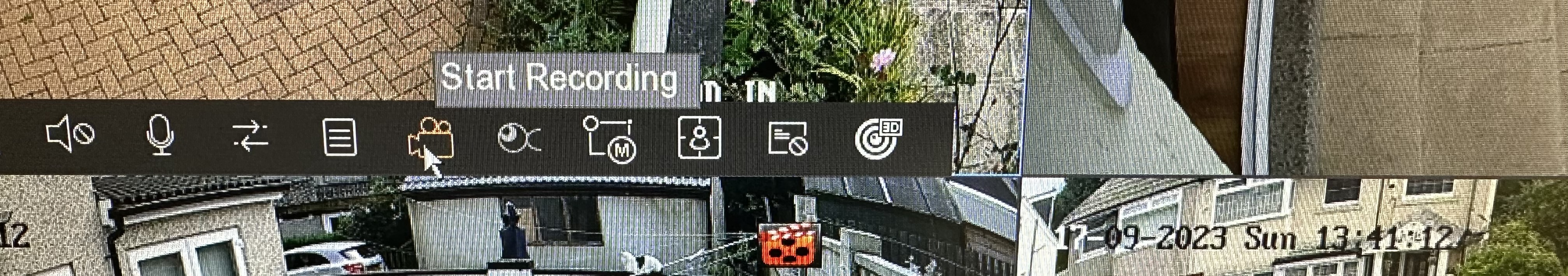

2. When you go on each camera screen on the monitor the Record icon still says “Start Recording” even though everything is working so am I right that this is on the the camera direct if it had a storage card - if so this is where I might have been getting confused. See pic.

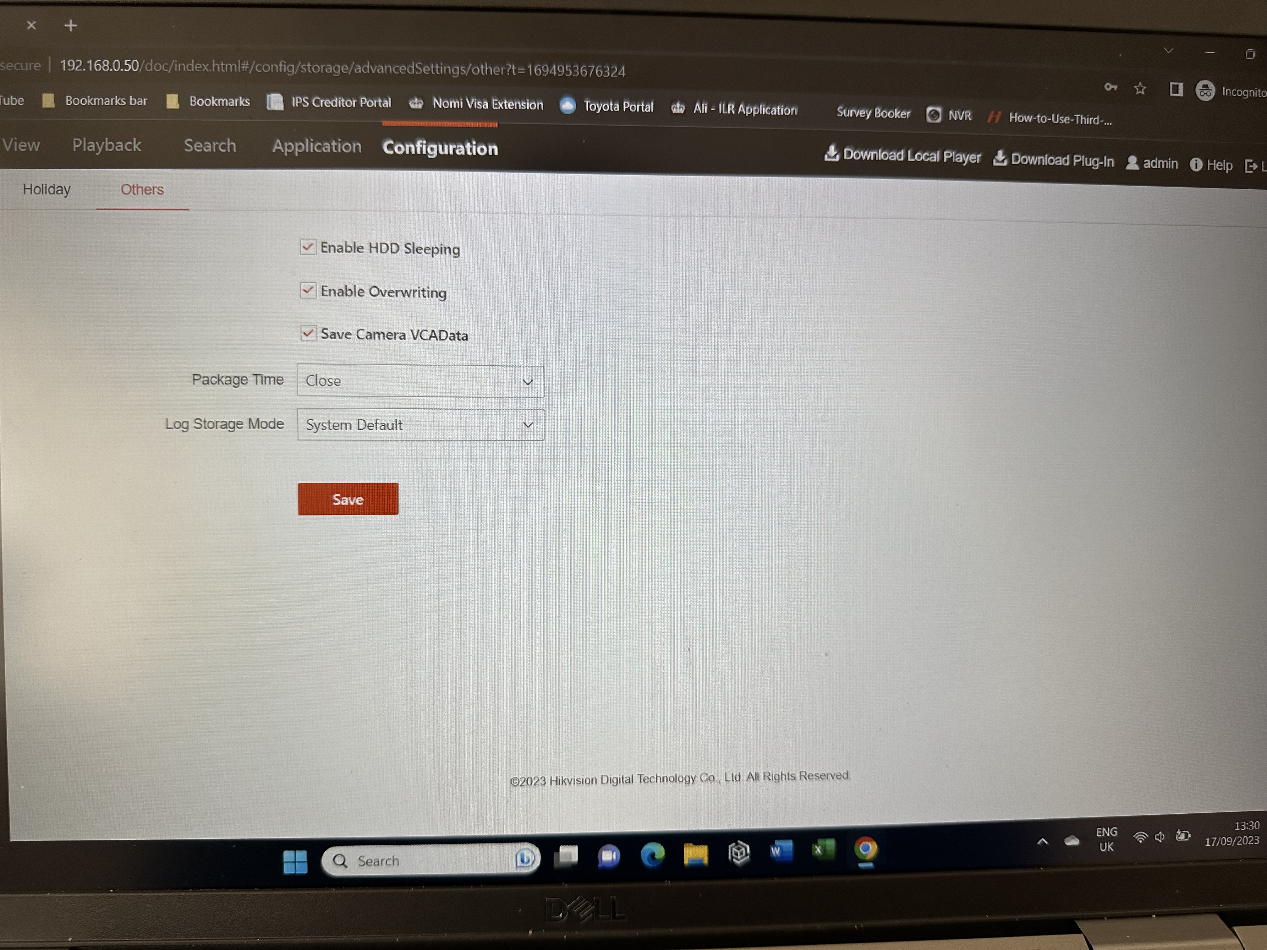

3. Configuration > Storage > Advanced Configuration > 'Others' that 'Overwriting' is enabled (all three checkboxes should be ticked
The third option (Save camera VCAData) was not ticked so I ticked this aswell.

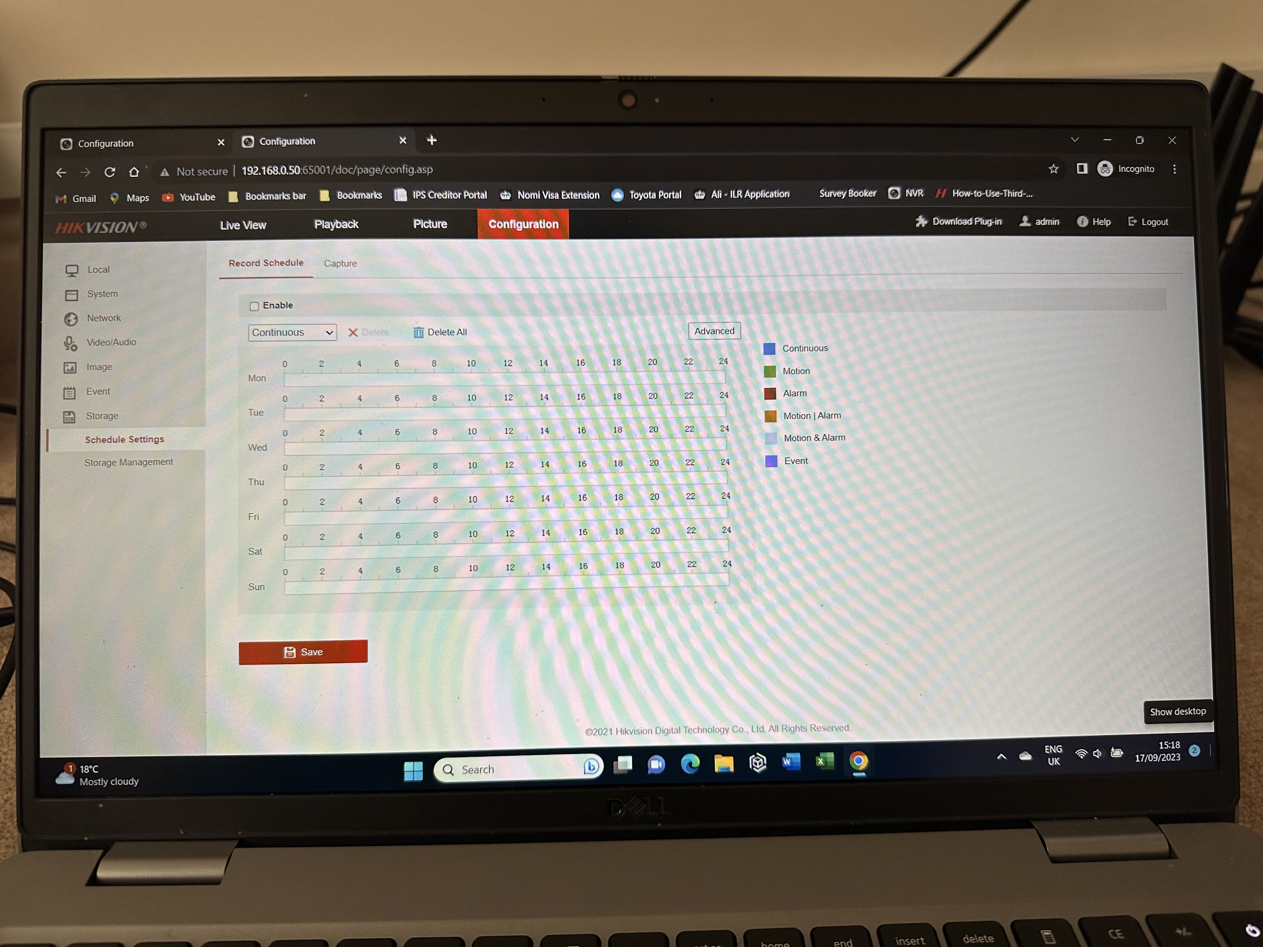

4. Even though the record schedule directly on each camera was Disabled, I logged on to each camera and also deleted the record schedule (the continuous blue bars) and rebooted.

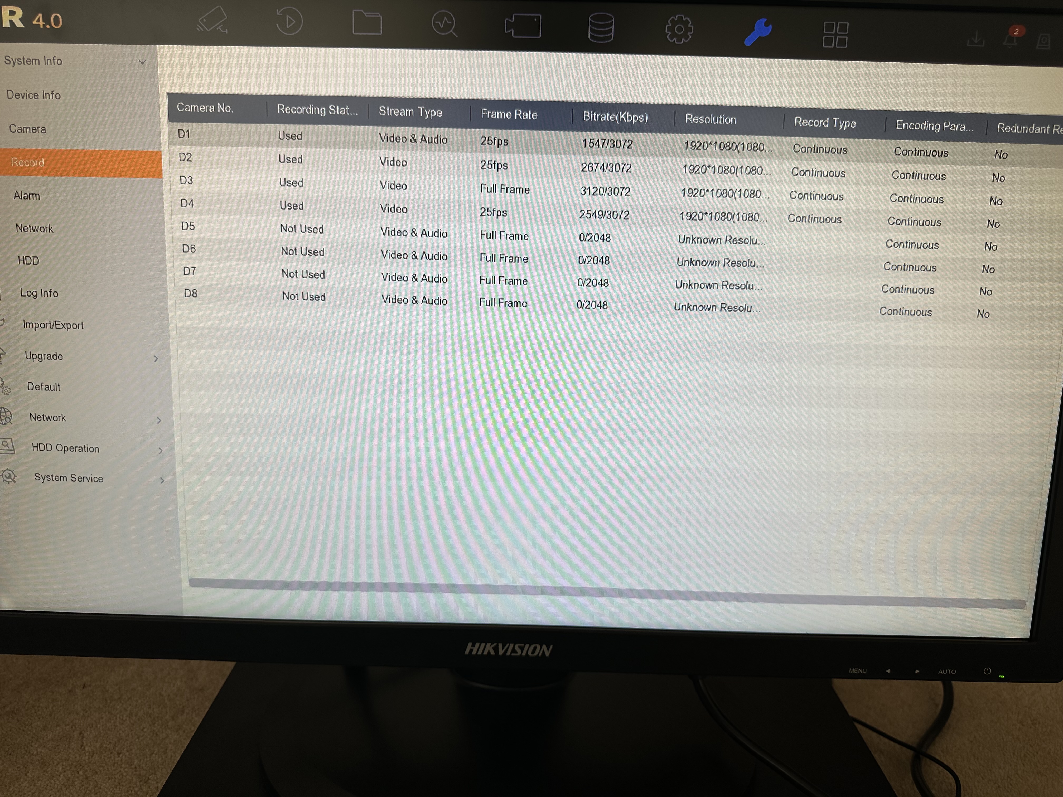

After several reboots the recording seems to be working continuous and event recordings and it shows them all in the playbacks on the Hik-Connect app.
The “Start Record” icon on each camera screen on the monitor screen has been left as is as I’m now guessing this was the setting directly for each camera.
I attach all pics now of settings after everting is working as expected.

That's all looking good, looks like you've cracked it.
All that will do is start manual recording and record a second copy of the main stream. I've just checked and mine is the same. When continuous recording was in use, it used to stop rather than start recording. After the recorder is rebooted, all you're looking for is that red movie clapperboard icon in the upper right corner. That indicates recording is taking place (though unfortunately it only shows on the local monitor not the web viewer at the moment)
That's needed if you were to search footage for something other than a pre configured event (doing a VCA search by drawing a line etc) so is best kept enabled.

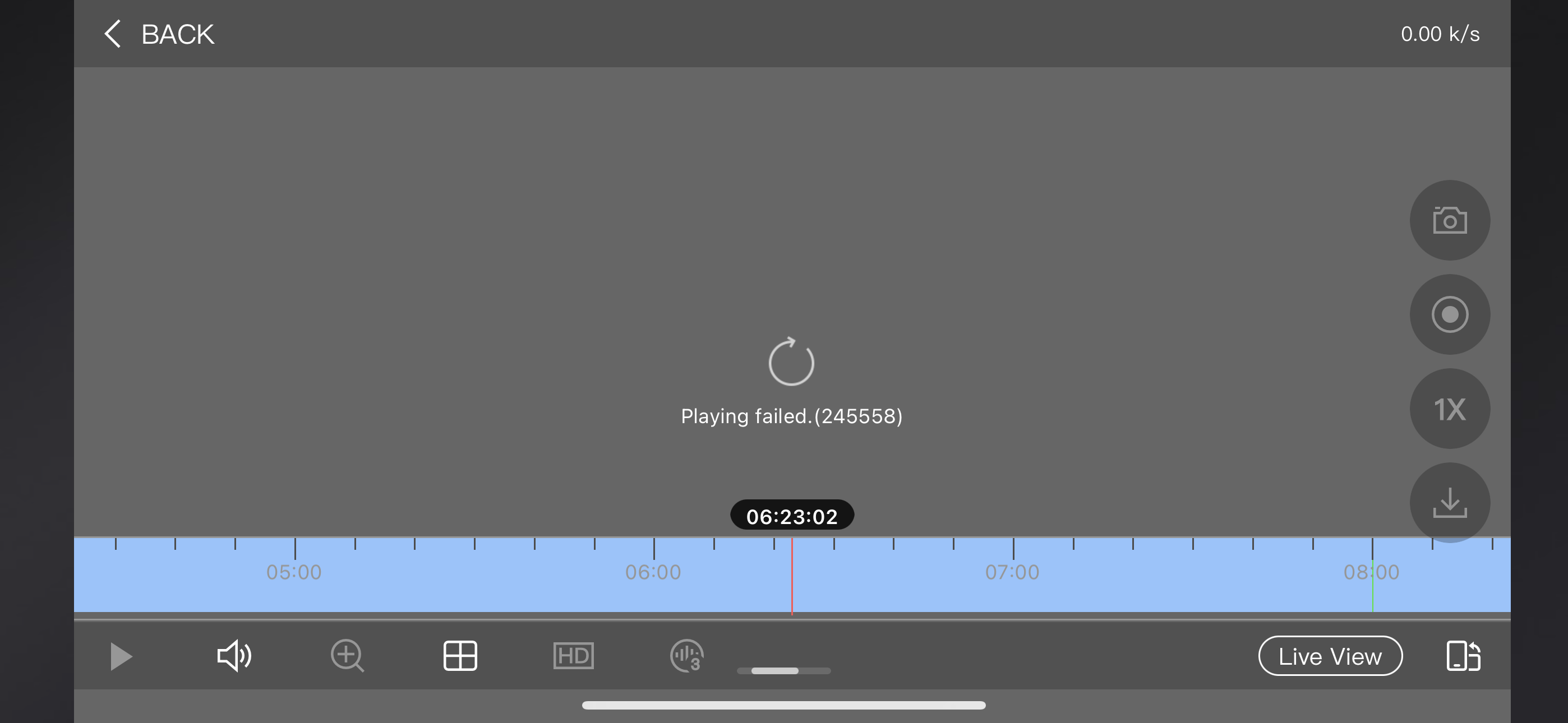

on occasions and on different cameras, I have been getting “Playing Failed” error message when trying to playback footage. See screenshot.
Any ideas as to what the cause might be.
