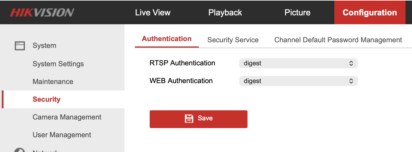

What you may be able to try is look for the following setting on your NVR via the web UI not the local (it may be in a different location as this is an older K series):
Change the RTSP Authentication from 'digest' to 'digest/basic'. If the cameras are too old to support digest authentication that change will allow the NVR to use basic authentication as a fall back.
