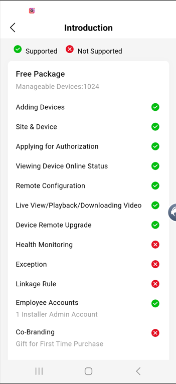

I also have all package, but not Health Monitoring, Exception, Linkage Rule and Co-Branding.
Does this work without Authentication? I'm end-user, installer of my system, but not a proffesional installer. Should I authenticate?
Does this work without Authentication? I'm end-user, installer of my system, but not a proffesional installer. Should I authenticate?View attachment 12731
I'd be tempted to leave well alone unless you want to start paying. They even charge me to add my logo to my customers apps!
