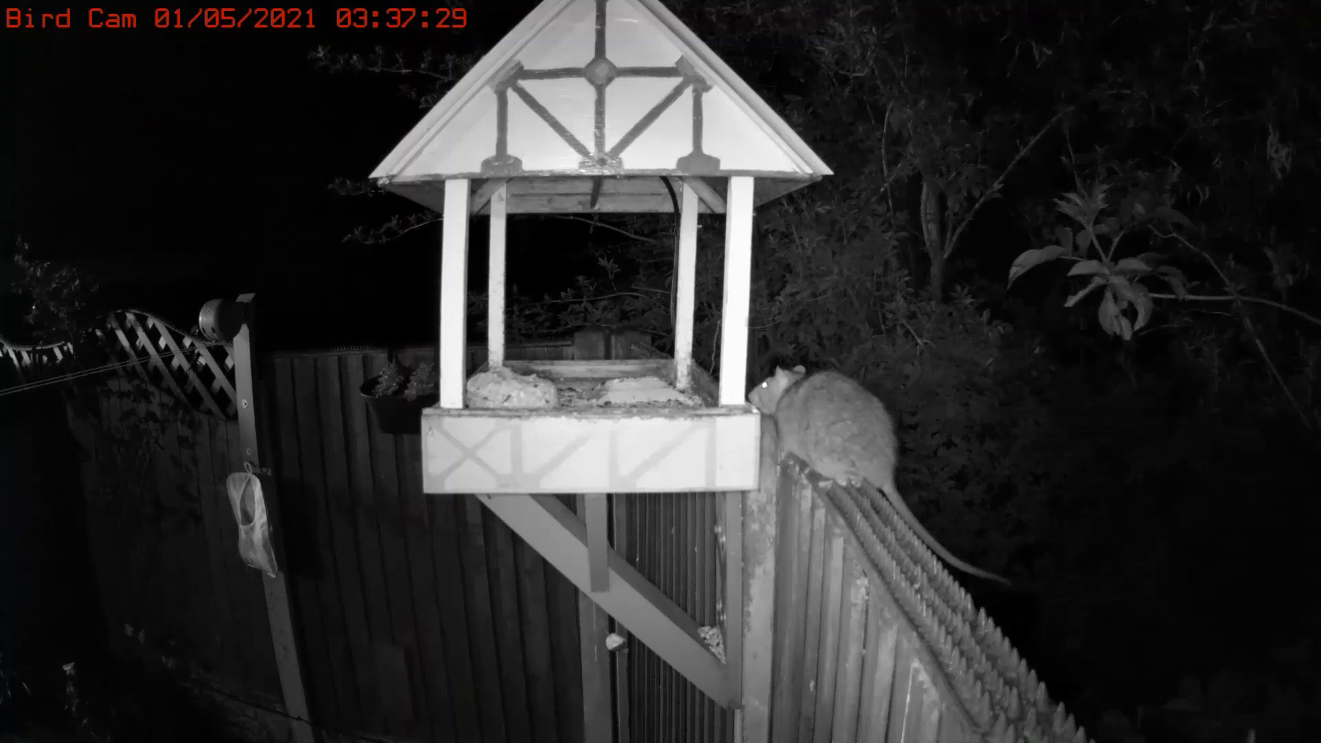

I've bitten the bullet and replaced mine with Reolink cameras except for one.
I kept one to monitor a bird feeder in our garden.
I don't need remote access to it and if a rat appears after dusk, I have configured it to send its email to a 3rd party app called PUSHOVER.
Pushover immediately sends a push notification, just like Ucam247 used to do. It has even received permission from Apple and Google to send alerts as Emergency Notifications (if you wish) that will over-ride Do Not Disturb and the mute switch. That takes some doing!
There's a slight delay of about 10 seconds which is better than unreliable email apps, including Gmail. It also allows you to upload a unique mp3 that will be your alert sound. I highly recommend it. It has a 30-day free trial after which it costs $4.99. It's worth every penny in my opinion. ( Pushover: Simple Notifications for Android, iPhone, iPad, and Desktop )
If you need remote access, there really is no option but to go elsewhere. Reolink and Hikvision do an excellent job and have most of the features that made us love Ucam247 and Phycam devices.
A recent event. Without Pushover's alert, this chap would have cleared the table and invited all of his pals to join in. He didn't get the chance. BOOM!
