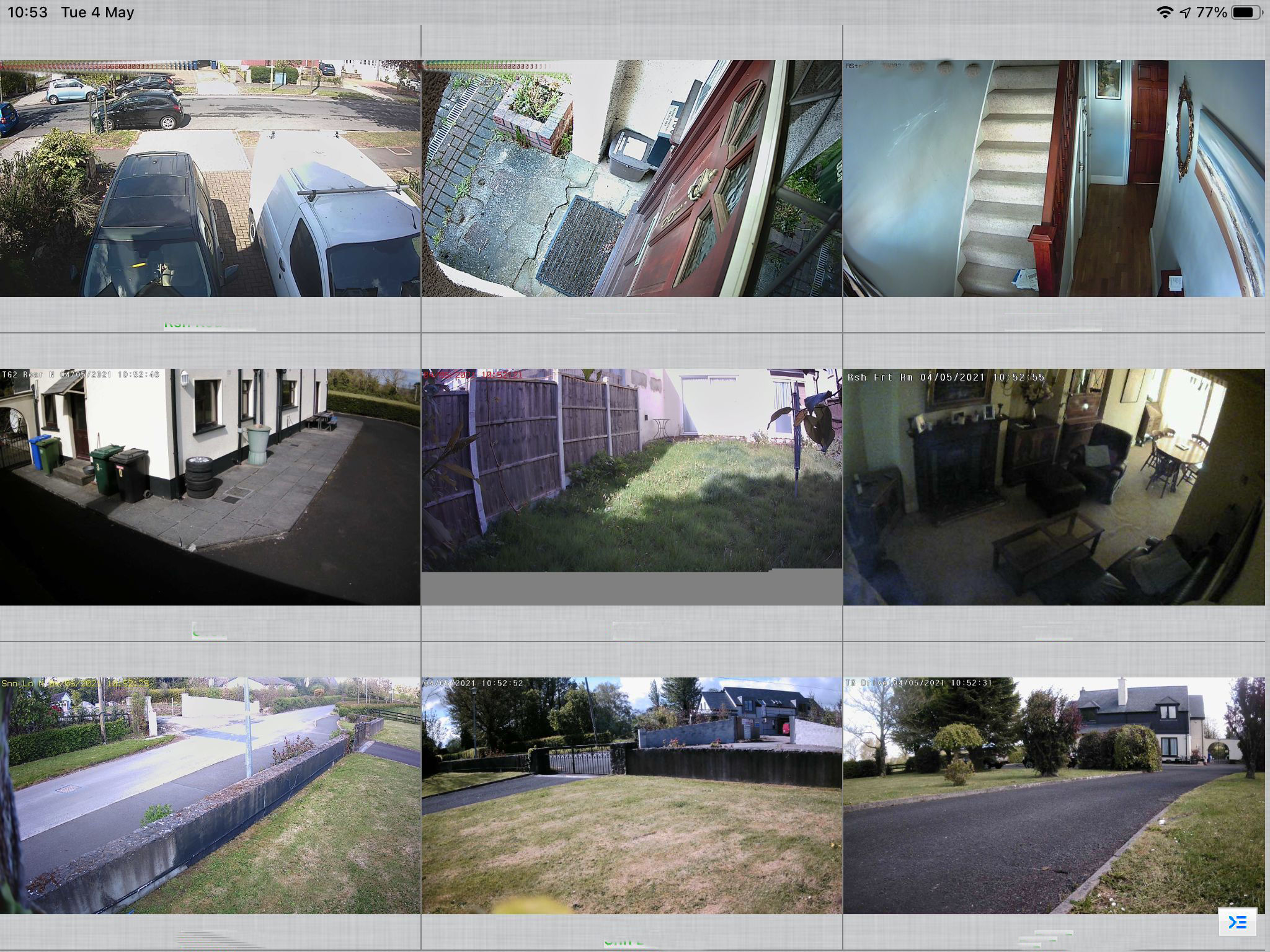

I agree with Jouster. These cameras are far from a dead duck as it were. Home Assistant is a great option with a Raspberry Pi 4, I am in the middle of setting that up, its cheap and open source.
However, if you want remote view on the cheap, as these cameras support RTSP, which is a standard, you just have to get a little creative. You can connect remotely connect to your cameras, if you have a router that supports Dynamic DNS (create a free, or for a small fee will do, any DDNS provider supported by your router really....this keeps track of the WAN ip address of your router which the ISP keeps changing on a regular basis), configure port forwarding so that your incoming connection is forwarded to port 80, I actually translate externally from port 8888 to internally port 80. You can actually view your camera using the VLC media player, viewing the camera as a stream its dead easy. So on VLC you would open a stream for example rtsp://yourdnsname.asuscomm.com:8888/live/0/h264.sdp
My router is an asus router, the DDNS is free hence the asuscomm in the address above. Remote viewing works a treat.

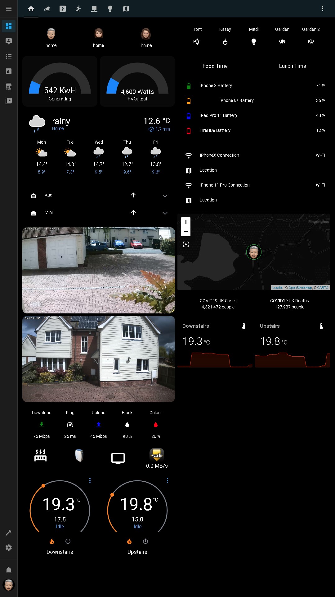

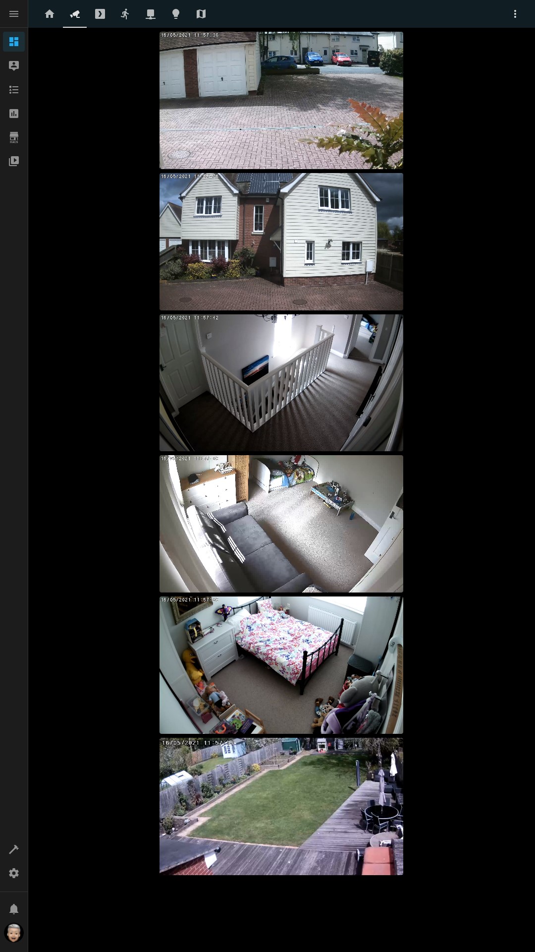

Glad I found this post....was pretty sure I wasn't the only one a little annoyed at the dwindling support for these cameras
In truth, I've had my cameras for quite some time now and in fairness, they have worked well for me, and even support has been pretty good, until now of course. Howeverm, that email replyt is clearly there standard response to any enquiries reagrding this issue. They clearly state that the cameras haven't been made/sold since 2018 but agree, SOG act should provide some cover here but I have no idea how you would approach that....as surely they cant be forceed to support thiongs out of their control...they stated, when Ive had the very same issues back in 2019 that their 'external' developers had some issues with their P2P servers...and clearly this is the issue here...and if P2P is going away...the cameras and their currently fucntionality is always going to be limited going forward.
With us all being mostly at home over the past year, in truth, I've rarely had to check my cameras when out of the home...as I'm never away for anything other than a run to the shops.....in fact I only noticed one of my FiLs cameras wasn't working which led me to discover than in fact 4 of my six cameras also have dropped off when I'm not on my local network.
The other reason I've not noticed the lack of connection is partly due to the fact that I've moved my camera monitoring mostly over to Home Assistant.....and this still lets me view my cameras on 4G or another Wi-Fi network when away from home without issue...where they are basically viewed as IP cameras and therefore don't rely on the P2P network anymore....I'm also lucky enough to be running a Synology NAS which has licenses for two cameras as standard so I can also use the DS Cam app to view my two most important cameras (at the front of the house)
For those running a Synology NAS of any sort, check out the Surveillance app, additional licenses can be purchased for more cameras and it sends IOS notifications (more than likely Android too)and you can even view multiple live cams on the screen at once, something that the UCAM app annoyingly never did. It also in dark mode, again something which UCAM said they had no interest in doing...should have been obvious back then I guess
For those who like to tinker even more, I can heavily recommend home assistant....of course this isn't an out of the box solution and does require some additional kit (a Raspberry Pi 4 and an SD card will be enough but I run mine in Docker on my Synology NAS). It’s fair to say this , in its most basic form, only give you viewing ability, but it works on your internal network and most importantly on 4G or any other Wi-Fi connection. It is also possible to setup notifications from it as well but even I haven’t bothered with that for now as the ucam cameras, at this moment in time, still manage to send emails on alarm triggers and record footage back to my NAS. Home assiatnt does a hell of a lot more as well....mine now monitors my entire home, all of its smart kit and a whole lot more.....its certainly not for everyone but as a tablert which will sooon be wall mounted, it for me, is the best way forward for any smart home control. I t also has phone and tablet apps, and runs on any browser too...Ive attached a copy of some of my screens from my PC to give you an idea of how it can look with a little work
For those struggling with motion detection after the demise of flash, its worth pointing out that on the IOS apps, and more so the iPad app, it is possible to adjust the motion detection areas. It's not perfect...at all...in fact, its far from it...but it does work...it just needs a bit of time to set it up and a good degree of patience...but most importantly it does allow you to adjust all motion detection...so all hope is not lost there
Images below are two of my home assistant pages.....they display pretty much the same on my phone and tablet
hope some of the above helps
View attachment 5795View attachment 5796
