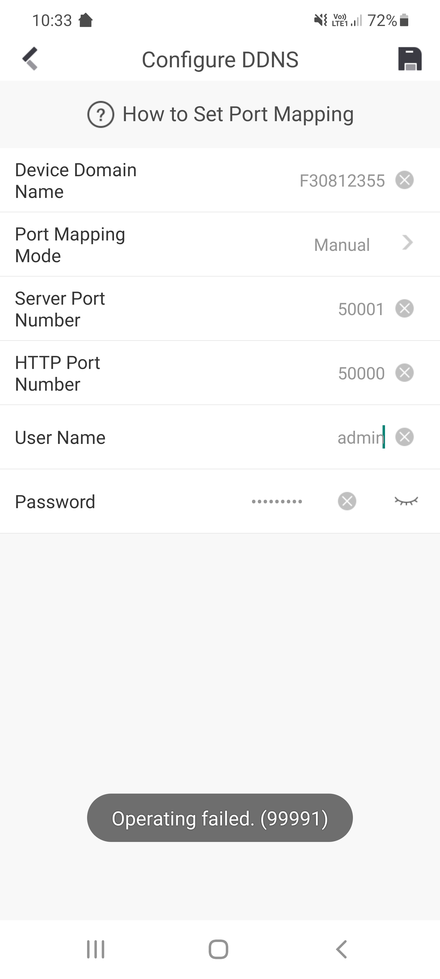

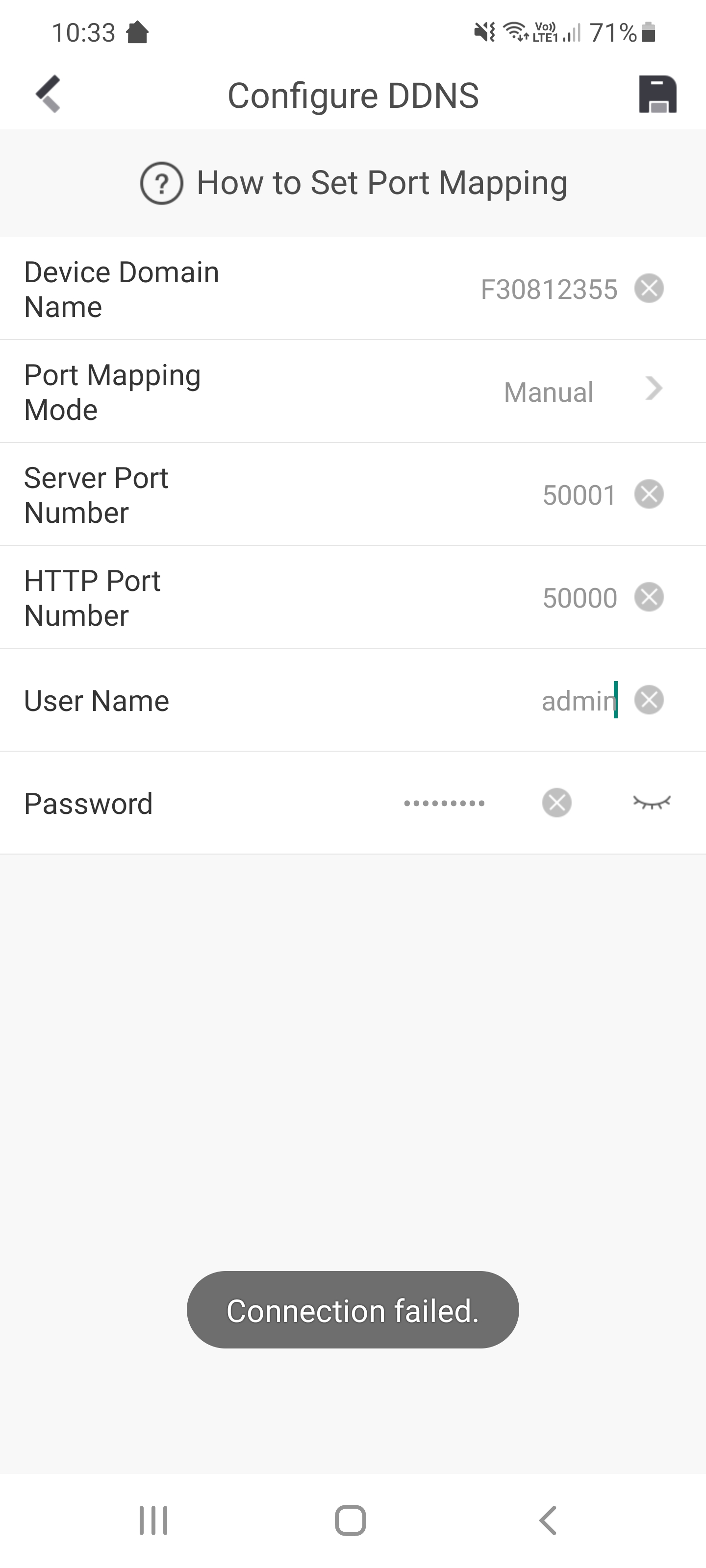

done the port mapping. but my app says connection failed when trying to config ddns
the device domain name is already in the app as the F30******* number
changed to manual
server port 50001
HTTP port 50000
user name was blank. i put in admin although i have admin and a user (which is me) i typed in admin
Password put in and then saved. or tried to as it said connection failed
I think I will just put everything back to normal.
My app won't accept ddns. Keeps saying connection error. I've no idea what device domain name relates to as it was an f number. Possible serial number for the nvr in the app. User name was also blank. Don't know what that relates to either.
My Web browser can no long find my nvr. I seem to be getting further and further away from the standard set up.
Might just jump the nvr back and go from there. This port mapping has just added 2 more issues

Screen shots of the WiFi off and when it's on

So from the screen shots you can see that the app fails to save the DDNS setting when you're on WiFi (as you're on the same network at the time). With WiFi off it is connecting to the server but returning an error code. I've not had that before so I'm not sure what the specific error code is.

Would you have 4g on with WiFi off when saving?
Just while you're hitting save on that configure DDNS page. Some routers (Virgin Hub 3 being one of them) don't allow you to make a connection to their external interface, from a connection that was initiated from the internal interface (loopback). Apologies as it's a bit like trying to put the offside rule into words! That may be what is preventing the setting from saving.

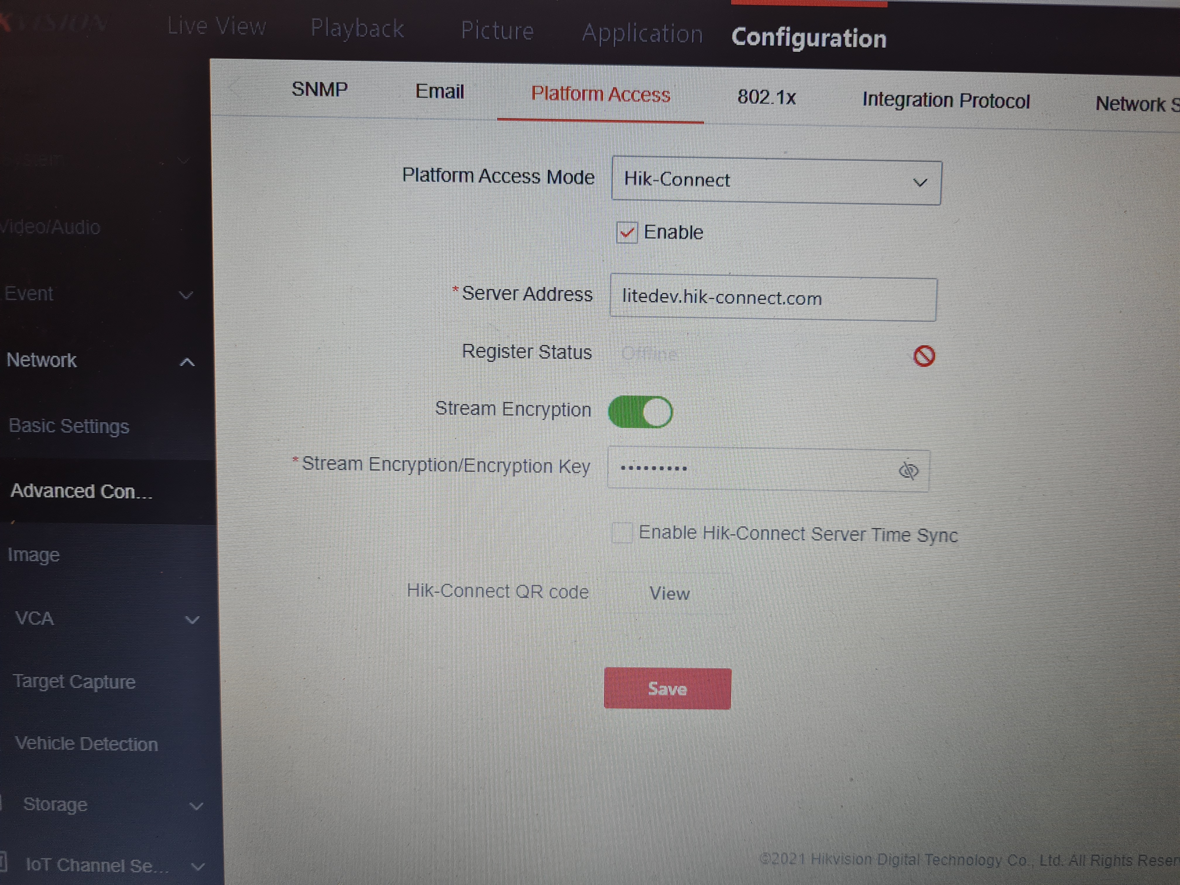

I just changed from h265+ back to 265 and the camera rebooted and now shows offline through the app. OK on nvr though.
Should pppoe be enabled at present?
My cameras show online on nvr local and Web browser. Just hik connect is offline. Shows off line on hik connect Web browser status as well.

All done. When the nvr bricked itself on the step back it lost the 8888 and 8844 setting. App still shows fully in HD so it must be the update!
