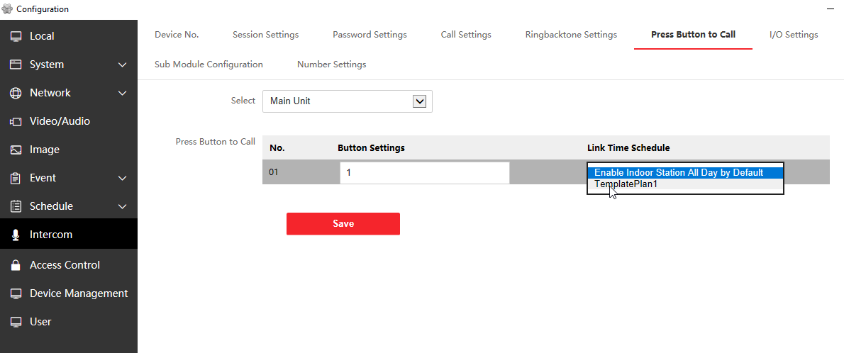

I am having the same issue right now. Calls come through fine through the indoor touchscreens, but do not ring through the IVMS4200 software. I followed the instructions on setting up template1 to 24/7 CENTER schedule, and then enabled the schedule in the "press button to call" section. I cant find anywhere the "Dial" section to enable "Call Notification Center"
On newer FW you create schedule and choose it.

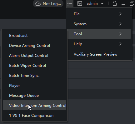

And in IVMS enable Video intercom arming control:
It should work.
