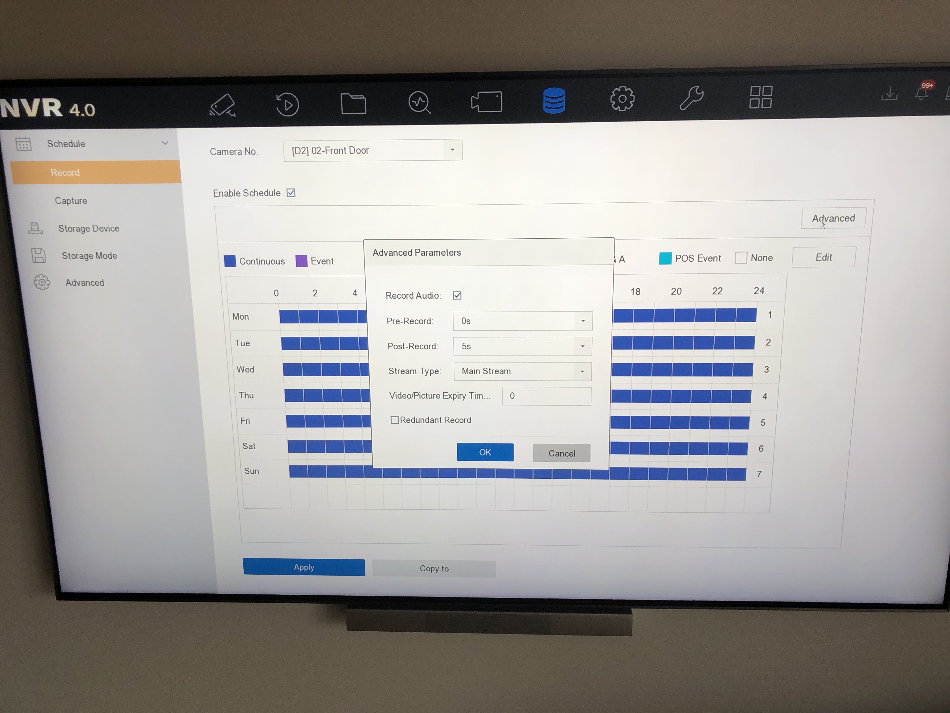

Does the camera record sound? Just viewing my videos back and don't hear anything.

We had a person wandering about last night, but because it was on perm record It took ages to find it. I need to set up motion detection.
Is there a guide to set it all up so that it captures when things move past.

There’s plenty of info on this forum. Forget the light for now and focus on the basics.
For the motion you simply need to draw the shape (as you were yesterday) in the setup. Put a tick in the Human box and I usually set sensitivity to 40. If it just so you can find a person in view that’s it - nothing else needed.
In playback click Smart and tick the human icon - your playback timeline will show the markers in red and skip from event to event. If you know the rough time you can click anywhere in the timeline and it jump forward to the first detected event after that point. If you see something of interest click normal and it will continue without skipping. You can click between smart and normal playback like that.
